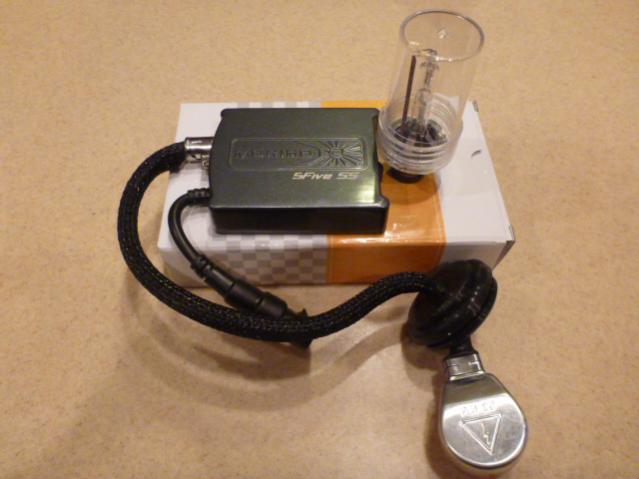

So I have this serious issue or obsession with lights. One of the first mods I did was to have ChefJ convert my Depo's to HID
projector lights... and they rock.. We used 35 watt ballast. After buying a few LED lights from Nick at Expedition Lighting
Systems and a discussion about up grading my projectors... I had a package delivered... 55 Watt Ballast and a new OEM size bulb which should give me a 20 to 30% increase in light output...

I have the same ballast but mine are anodized yellow or gold? 55 watt, nick did mine
