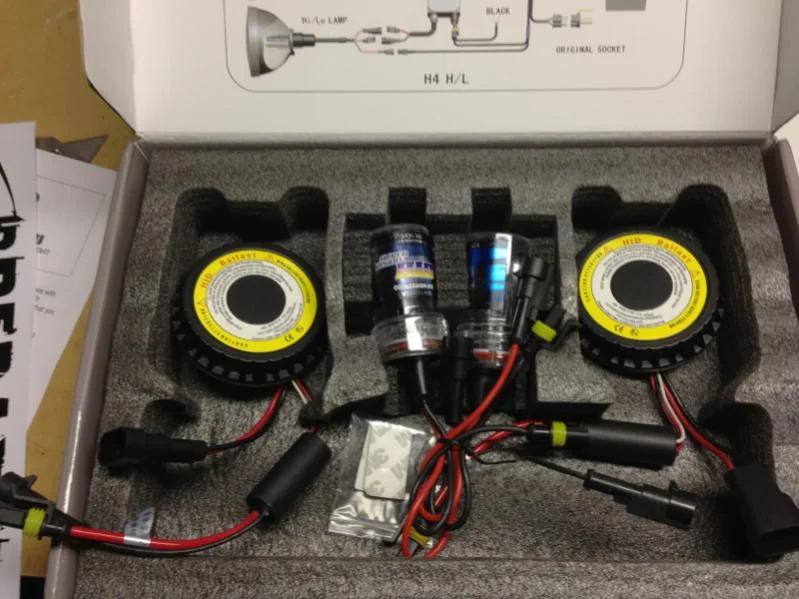

I've had these XS900 on my work bench since adding the 20" Rigid and have been watching the prices in AU dropping on the 55 watt HID conversion with the slimline internal ballast.... so I ordered the kit.. I'm really curious to see if these will throw the light farther down the road ...and the fact I just like the look of round lights
It was a pretty straight forward project..about ten minutes per light after taking 30 minutes removing the plastic protection covers.. they were a PITA to remove.. Won't have these mounted for about a week...headed out of town for a few days
Lou
Lou did you have a pic how your light pattern end with the HID kit in .. ?
Not yet.. I just got back and will try and get them mounted by tomorrow and shoot a few pictures
According to Nick ..he did the LED group buy and is the resident expert in HID and LED lighting IMHO on MUD said, if the kit I purchased is a true 55w ballast ...they'll out distance the 20" Rigid... The actual pattern as I remember is pretty concentrated.
Lou

Just about finish wiring the dual battery setup and got the IPF XS900's mounted and wired .. The 55W HID conversion woke these lights up... Sorry about the picture quality...shot with my iPhone
Lou
