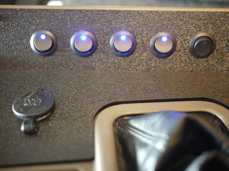

Looks good, Lou.

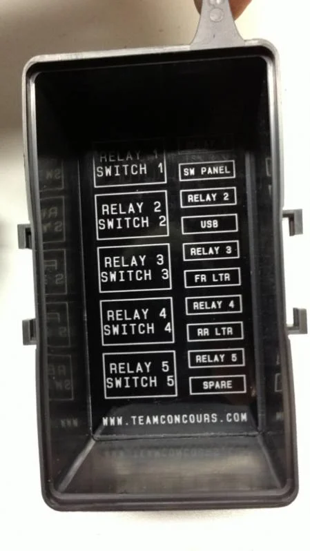

Any plans for labeling?
You know he asked me about that and I elected not to do it right now...two of the switches are extra's that may have a home pretty soon...as I have a 20' Rigid sitting on the work bench...once I figure it out I'll have a plate made with labels

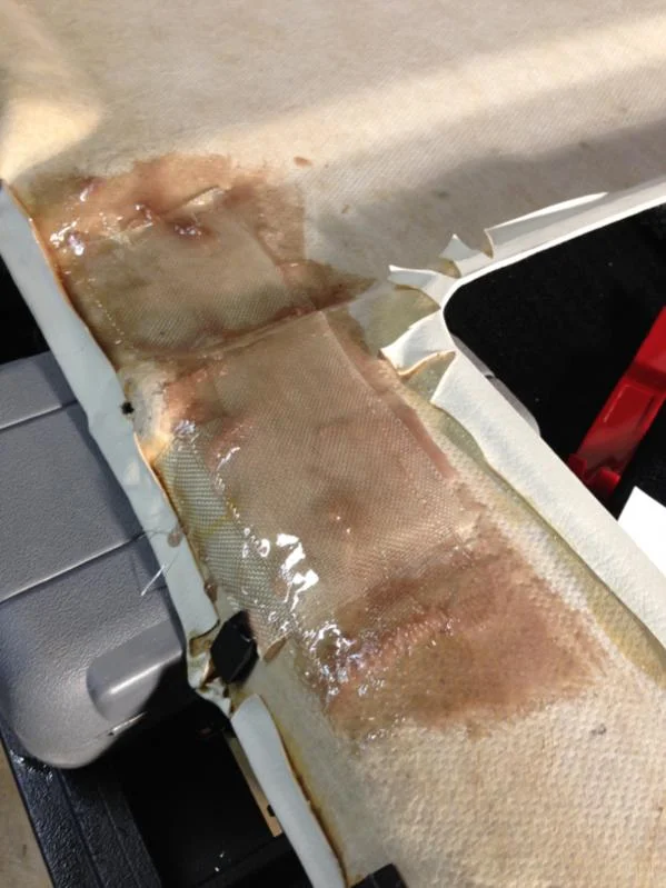

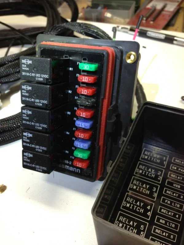

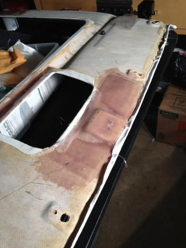

Finally finished wiring the roof rack and pulled the headliner to figure out the right location to drill a hole for the waterproof gland the wires will run through but also had to do a little work on the headliner. The marine vinyl I used to cover the headliner wasn't sticking to the headliner due to a small leak from the old windshield seal.. the leak was fix with a new seal and windshield... Repaired the front area with glue and also fiberglassed a few weak spots on the headliner

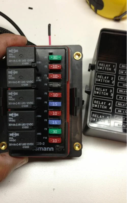

Opened up the relay box and have to say Greg from Concours Specialties did a fantastic job....I'm hoping to have lights working up top by Sunday

If you know how to wire one ... you can pick one up on the net.... I'm pretty clueless when it comes to this stuff that,s why I left in the hands of experts.. Funny thing is ... everything was done via phone and email ... They do great work

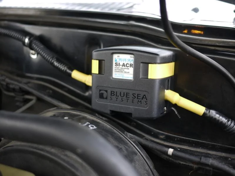

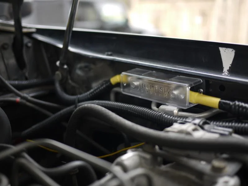

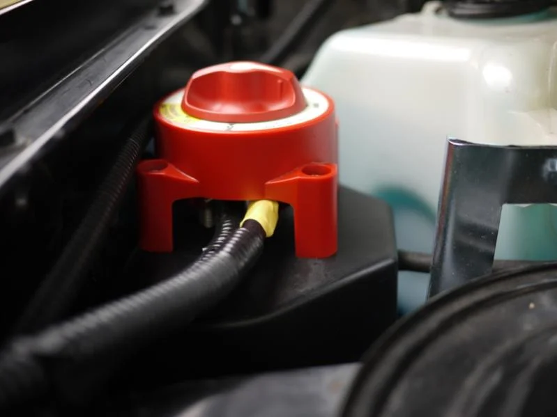

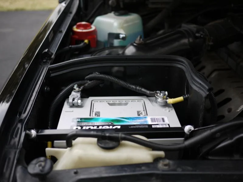

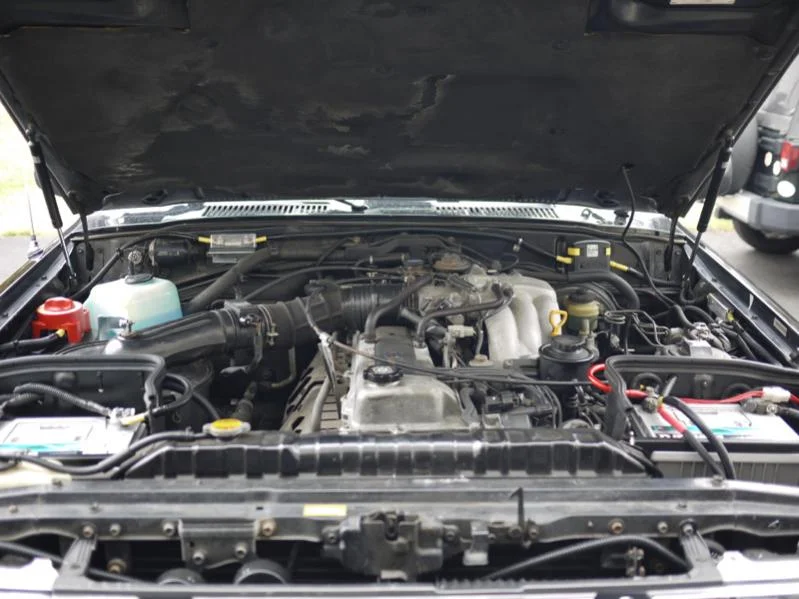

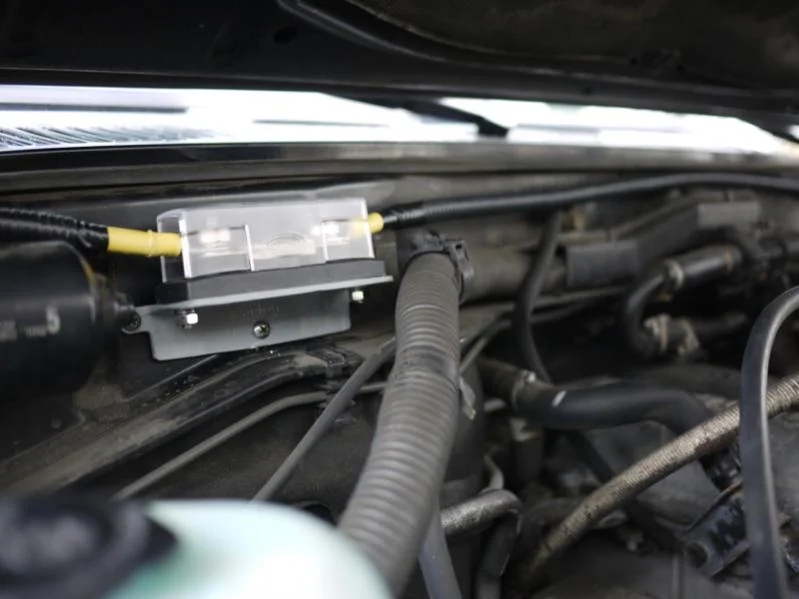

Three major wiring projects ...two completed..... Just finished the dual battery wiring ...and need to make a small adjustment.. The battery selector which is mounted on the cruise control cover needs to move about 1/2 away from the fender... the hood strut just hits the selector
I have a new appreciation for those that do wiring ...all the little details .... Attaching lugs and connectors, shrink wrapping, wire sheathing... and trying to keep everything neat and tidy.. I don't even want to to add up the cost of everything I bought to wire up the rack and the dual battery setup and just dropped another $75 on 4G wire that will run from the new battery to the rear of the truck.. There's a huge difference in cost and the thickness of the cover on the wire between the 4G you'd purchase at a big box store like H Depot or Lowe's vs West Marine. Purchased all the wire from WM ... Blue Sea stuff from Amazon and WM..shrink wrap from Auto Zone... Lugs and connectors from WM and Sears Hardware... Bought this cool lug crimper for $15 on Amazon that you hit with a hammer that works great .. The bottom line is this sh%t cost a lot of money and takes longer then expected.
Lou

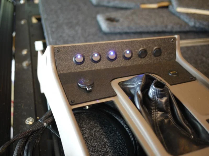

I have a new hobby - reading about your mods! I'm definately going to hang out on your thread this evening. I want to find out more about that switch panel!

The Relay box for the roof lights
M
Check out www.teamconcours.com... Stumble on a relay box they built in a buggy forum and looked at their gallery of switch plates and knew I found the right company...

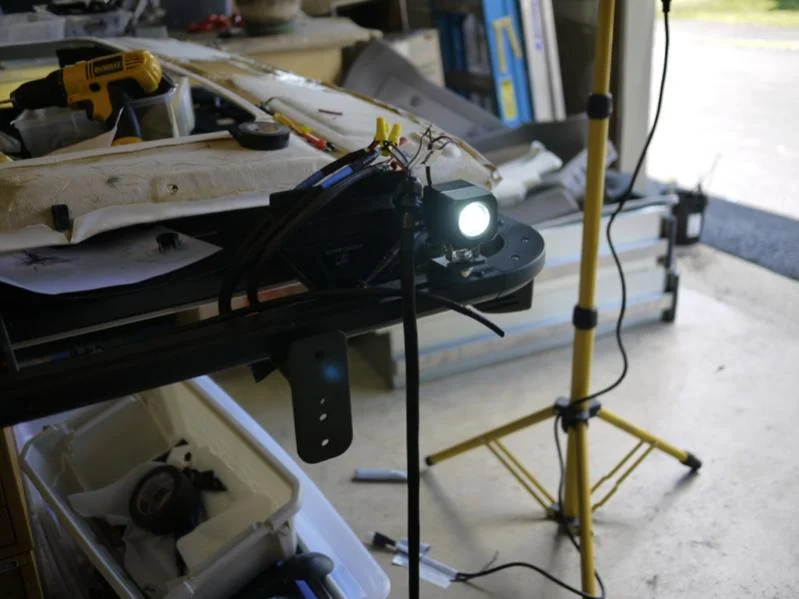

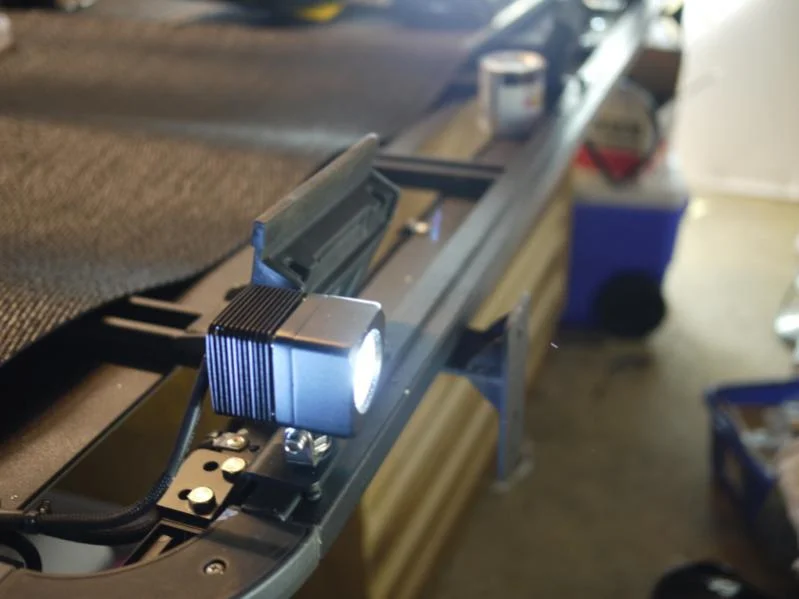

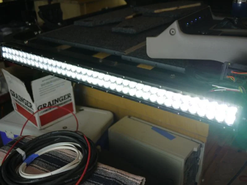

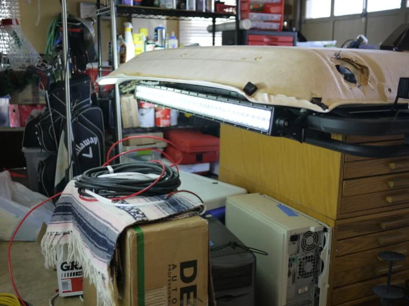

Got Lights!!... So I decided I'd better test the relay and switch plate before installing everything in the truck... As advertised.. Plug and Play..
