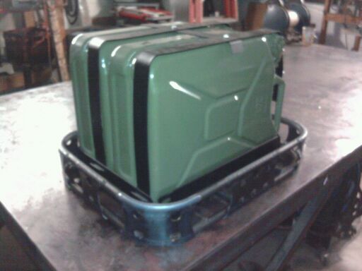

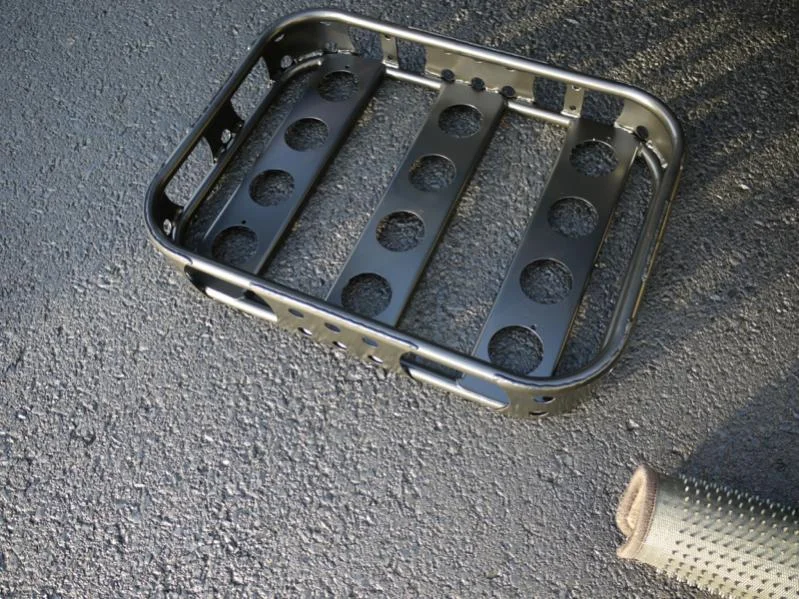

Brings me to my current project.. my Jerry can holder...I just didn't find one I liked so I designed one and its being built and should be off to the powder coat this week.. It may not be to everyone's taste but it gives me a little satisfaction to know I designed it and it will be sitting on the back of this truck for years... I'll have better picture tomorrow when stop by the shop..C&P Offroad in Gainsville Va has a fabricator.. Eric.. this guy knows his stuff...

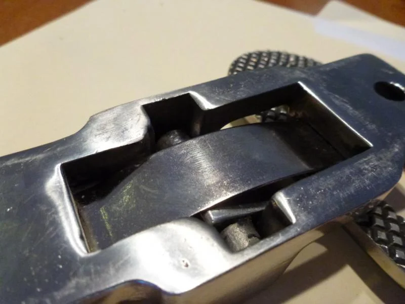

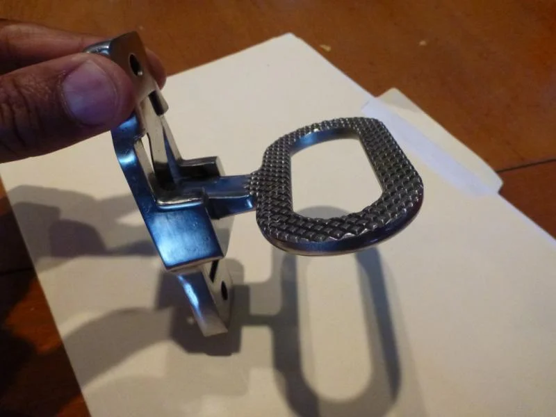

Went to drop of the rear license plate lamp housing that will be mount below the jerry can rack and snapped a few pictures..He should have it finished tomorrow and off to powder coat ..I stopped be a truck and trailer supply place looking for LED bulbs and walked out with this stainless folding step... Just might have to mount one or two on the rear bumper ...
Lou
Sent from my iPad using IH8MUD
Sorry I was outside about to drill my bumper..... If you look at the backside the band acts like a spring and locks the step down. The stainless were $25 and the powder coated version were $10

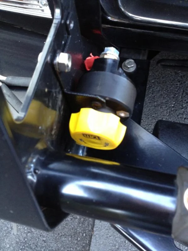

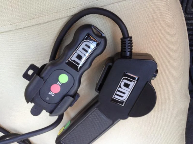

This helped me make the decision... TJM Propaganda ... not sure if other companies don't have similar sealed solenoids but this was out there in print and as they say .."If it's on the Internet ..it's got to be true" hahaha
Lou
TJM Winch Controller is a much better device for controlling winch motor power. Contactor's are better sealed to corrosion, take up less space, and most importantly are designed to fail in the open position so your winch can't run-on. This single TJM contactor can replace all four bulky old school solenoids for those of you looking to upgrade your current box if interested. We specifically build our own and have a patent's on our own internal design changes.
The alternative in most winches is 1940's technology. Specifically, the electro-mechanical solenoids used in most winchs to control the high-amperage power to their winch motors. There are usually four, two for powering the winch motor & drum "in" and two for "out". As an example, here are the solenoids from our old "W" winch in the picture. These old school solenoids on a modern planetary winch are either under a black plastic cover or integrated in the winch body/cover.
These solenoids pictured are just old Ford tractor “starter” solenoids. They are prone to corrosion and failure, and can in fact fail in the “closed” position, which means your winch runs-on and can't be stopped without disconnecting the battery - not fun if you are winching "in"! Mostly though, they just quit working at the most inopportune time, right when you really need your winch!

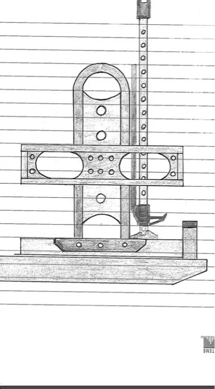

The Jerry Can rack is done ..... We decided to make it bolt on so I can run without the rack .... He did a great job on the rear upright ... drilled all the hole for the tag lamp and has tabs for a light and the high lift jack. Need to drill the swing arm and get this thing on.

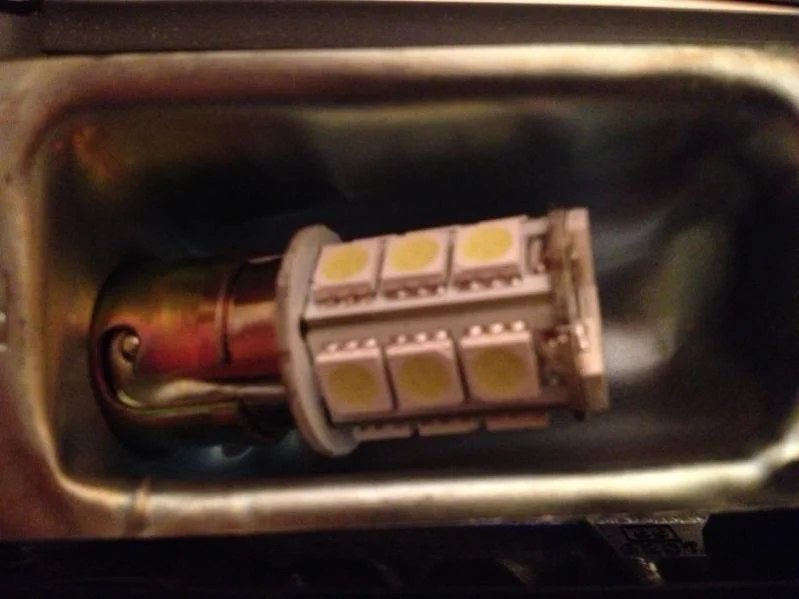

I'm thinking they may be too bright .... Here's one for ya... Thought I was ordering one of these small wedge lights and here's what I got ... Hahaha .. this thing is freaking huge

Installed the Jerry Can Rack today... Everything went pretty smooth including wiring of the new tag lamp.... opened up the tailgate and was going to run a jumper from the new tag lamp to the factory harness but once inside the tailgate ...the factory harness plug matched the new lamps plug.....so I pulled it out from below , extended it..... and had lights ......extremely BRIGHT tag lights!!!
