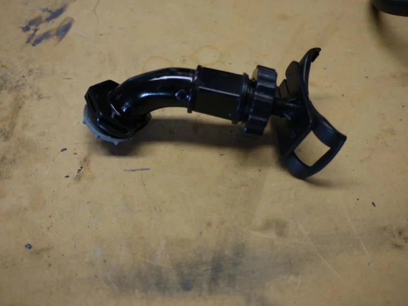

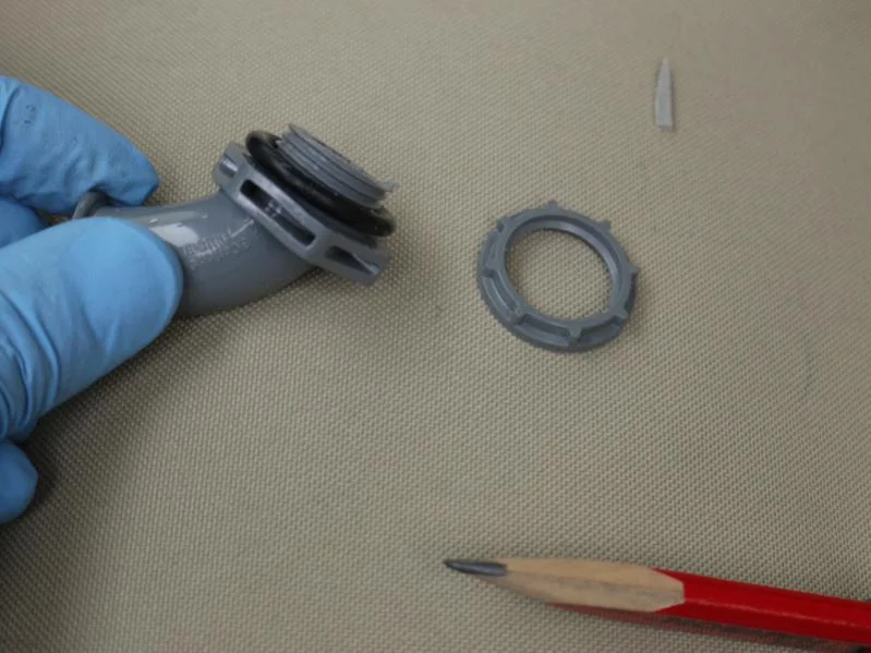

Inspired by Dontblink's Ultra Gauge install on the A pillar.. I headed off to the hardware store in search of some more inspiration and found it in the form of a small elbow joint with a plastic nut on the end ... My goal was to maintain the swivel end of the Ultra Gauge attachment arm.
With the elbow joint in a vise, I used a heat gun to soften the plastic which allowed me to bend the elbow out a little and I cut the end of the elbow joint. Removed the A pillar cover and used a hole saw, trimmed the back.... cut the threaded end of the elbow down for clearance and did a test fit.. I cut the flexible attachment arm to the length of the elbow and used JB Weld to hold it all together... Painted satin black..
