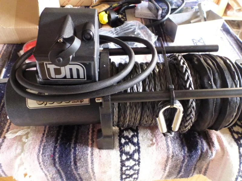

I thought I would install the new TJM winch today but with no help realized there would be no way to lift the bumper and winch by myself ... So I'll get it done at work this week. The winch appears like its going to drop right in and bolt feet forward against the inside front of the bumper.... the holes in the ARB line right up with the bolt holes on the winch... Someone correct me if I'm wrong as I've never done this but it seems pretty straight forward. The only thing I had to do was clock the gear housing to position the clutch lever properly due to mounting it feet forward

My 80 is officially 70lbs heavier... I installed the TJM winch today and everything went pretty smooth ... I have not wired it up yet and will have to drop the winch to clock the winch as the handle hits the bumper and I have a offset hawse fsirlead coming from Slee

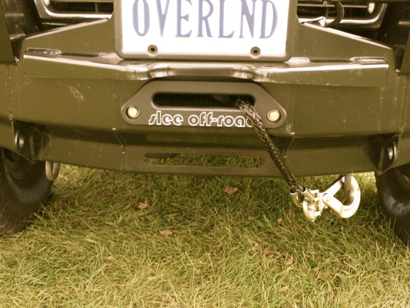

But I did get a weatlh of info from Christo Slee......regarding the need for a offset fairlead and also told me to check to make sure the end of the winch was not hitting the bumper...where the ARB starts to angle back toward the truck and it sure was so ....winch spacers and fairlead in the mail and no doubt will have to extend wiring from the control box on the winch to relocate it on top of the winch....I also concluded I won't have to drop the bumper to remove and re-install...

The TJM winch comes with a kill switch.. on off isolator knob...wired to the positive lead on the battery.... this is what you speak of?

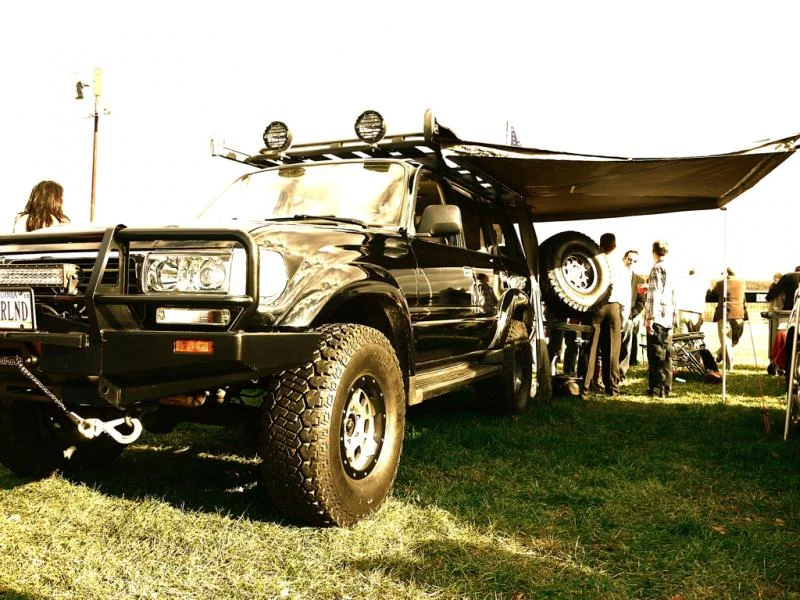

So Slee came through with the spacer kit and the offset fairlead which I needed to correctly mount the winch to the ARB and my 80 spent the day posing at the fall Gold Cup.. for a day of Steeplechase Racing
Lou
