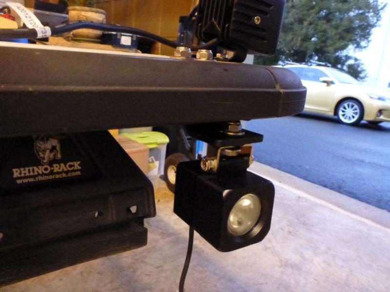

Incredibly it was 68 degrees today so I wrestled my Rhino Rack off the truck and mounted the LED lights I ordered from Nick.... when he did the group buy... Mounted the 42" to the rack using LabRaks drop mounts bolted up to an aluminum brace which I added. I mounted four 10w pods on the corners and two 2x2 on the back of the rack.. Just waiting for the switch plate and relay box and I'll get everything wired up

Lou,
Can't find any pics, but one thing I found useful with the LED bar was on the fly type adjustability.
I looked for some type of knurled aluminum knob with a security nut feature, and never found, but did happen upon knobs at Ace Hardware, of all places, that worked perfect.
If using for camping or whatever, it's handy to be able to spin it, a bit.
no soup for you!!
Lou,
I use the knobs on the awnings for quick removal....The LabRak Tamper proof drop mount has a cap that you would have to cut to access the end bolts....but I'm having a hard time locating security bolts that I'm using to bolt the brace to the rack and the pod lights... I have found screws and small bolts but nothing bigger.... any idea's
