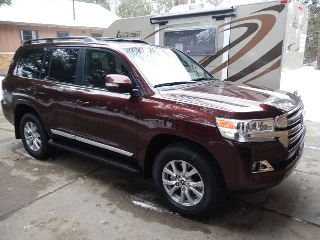

I took advantage of an opportunity to buy a ’17 Land Cruiser this week. Brandywine/terra. It’s my 4th Land Cruiser over the last 19 years; previously two 80 series and currently a 100 series. I’ve owned at least one 4WD vehicle the entire time I’ve been driving, starting with a ’46 Jeep (And no, I didn’t buy that one new!). The ‘17’s have lots of things to learn about, so I’ll likely be a frequent reader/poster in the Stupid Question of the Day thread for a while.
First up are tires, removal of the 3rd row seats and the LCD screens in the seat backs, installation of a trailer brake controller and an OBDII reader, and Weathertech all around. I plan to make some custom walnut inserts matching the other trim to fit into the empty LCD screen openings and fasten them in with industrial Velcro. For tires, I’m debating if I need load range E because the LC will be the primary tow vehicle for my camper. After some test tows, I may add Airlift air bags. I’ll do some searches for ideas on where to install the Tekonsha P3 brake controller and the Scangauge II.
Some tough decisions to come regarding my 100. I don’t really need two Land Cruisers, but then again………
I can’t wait to go use Crawl Mode in the off-road places I go here in Michigan. I see much sand in my future.

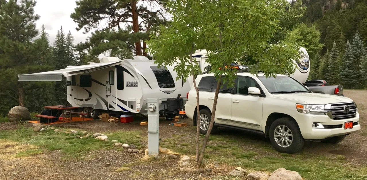

As for a trailer, we pull a 24', 5500# (GVW 6000#) Lance 2285 travel trailer with our 2016 LC. Works great. (There is someone on our trailer forum that uses an LX570 to pull the same size trailer.) Be sure to read the owners manual about towing. One key point is to put the shifter in "S" mode and set it to no higher than S6 on this 8-speed transmission. (This is the same as setting it at S4 on the 6-speed transmissions.) I set transmission range lower when climbing in the mountains and I always use engine compression (using the S-Mode to limit the highest gear) when descending. Live in Colorado and go over steep mountain passes. We do use a Hensley sway elimination hitch (which we bought when we were towing with a Land Rover LR4). It is awesome but if I can sell it some day I will switch to a ProPride. I don't have air bags. I'm going to see how next season goes towing. I may also wait a couple of years until it is time to replace shocks when I may upgrade and do a lift. That will throw off the height of the hitch receiver and I'll need to re-level the trailer hitch.

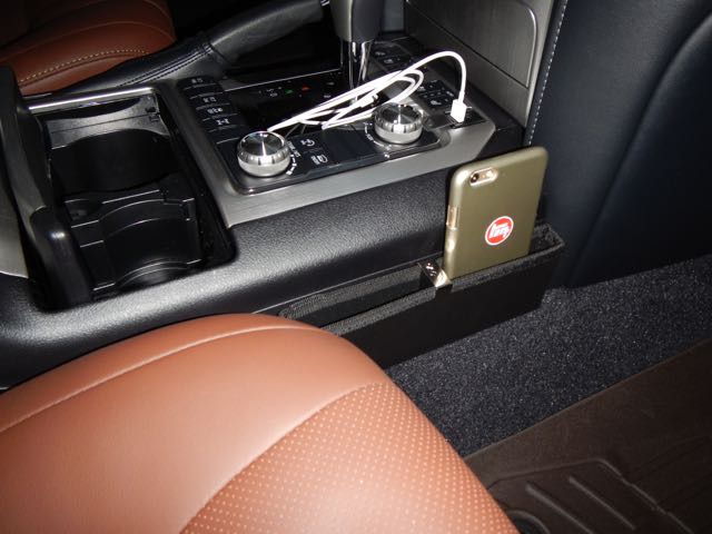

Good ideas and help so far! I've posted a couple of basic questions in other threads too. The 200 has a lot of nice features, but I find I'm really missing some things in my '04 more than I thought I would. Missing in the '17 are adjustable height arm rests for the front seats, opening rear quarter windows (for the dogs), passenger seat lumbar support, multiple DC outlets in the console, and a place to hold my iPhone 6 Plus on the console. The '17 console storage space is so limited I guess i'll have to adapt the cooler box for storage. I always travel with my Waeco fridge anyway and I don't need the cooler box. So, I'll have to adjust my ergonomic expectations a bit and get used to some changes in exchange for all the new toys.
No, it's crimped in tight. It necessary too, because the sides would flop too much without the brace. You could get one and try to remove it and see what happens, but I'm not optimistic.

Congrats! How do you like the CampLite?
The Camplite is outstanding. My wife and I have dragged it all over the country and love it. It's revolutionized our travel; we haven't stayed in a motel since we bought it 3 years ago and it's followed us to some very interesting places. I've heavily modded it for our needs.
