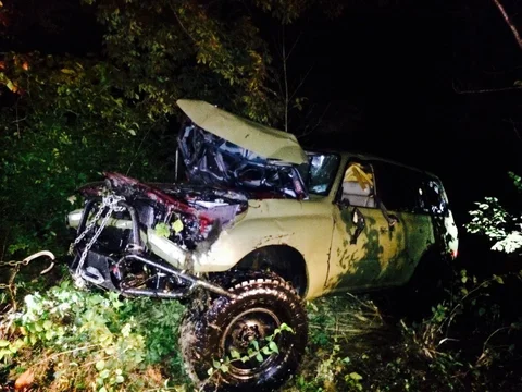

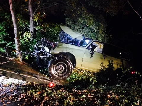

So... I loaned my 80 series out to a buddy to pick up a table and chairs for his new apartment. An hour later his girlfriend called to tell me he had a "little bit of an accident." In a testament to the LC build quality and safety, he walked away with only a scratch on his finger after going off of a 10 ft drop, and then rolling the vehicle in a 30 feet out into a creek. Click for full res for night of iPhone shots.
