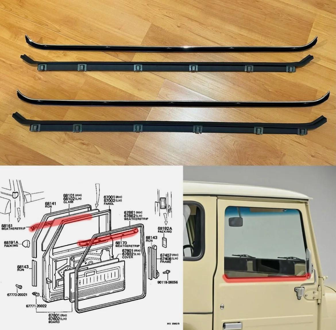

Does any one have any instructions or images on how to install the outer weatherstrip door belt? The previous owner had used glue, which of course did not work well. I've purchased new outer weatherstrip and don't understand how it attaches. Any and all help is appreciated.
There are holes in the door where the clips on the window felt/rubbers slip into. “Slip” is generous. Sometimes they need a little soft mallet to persuade them in. And adjusting to make sure they line up.
