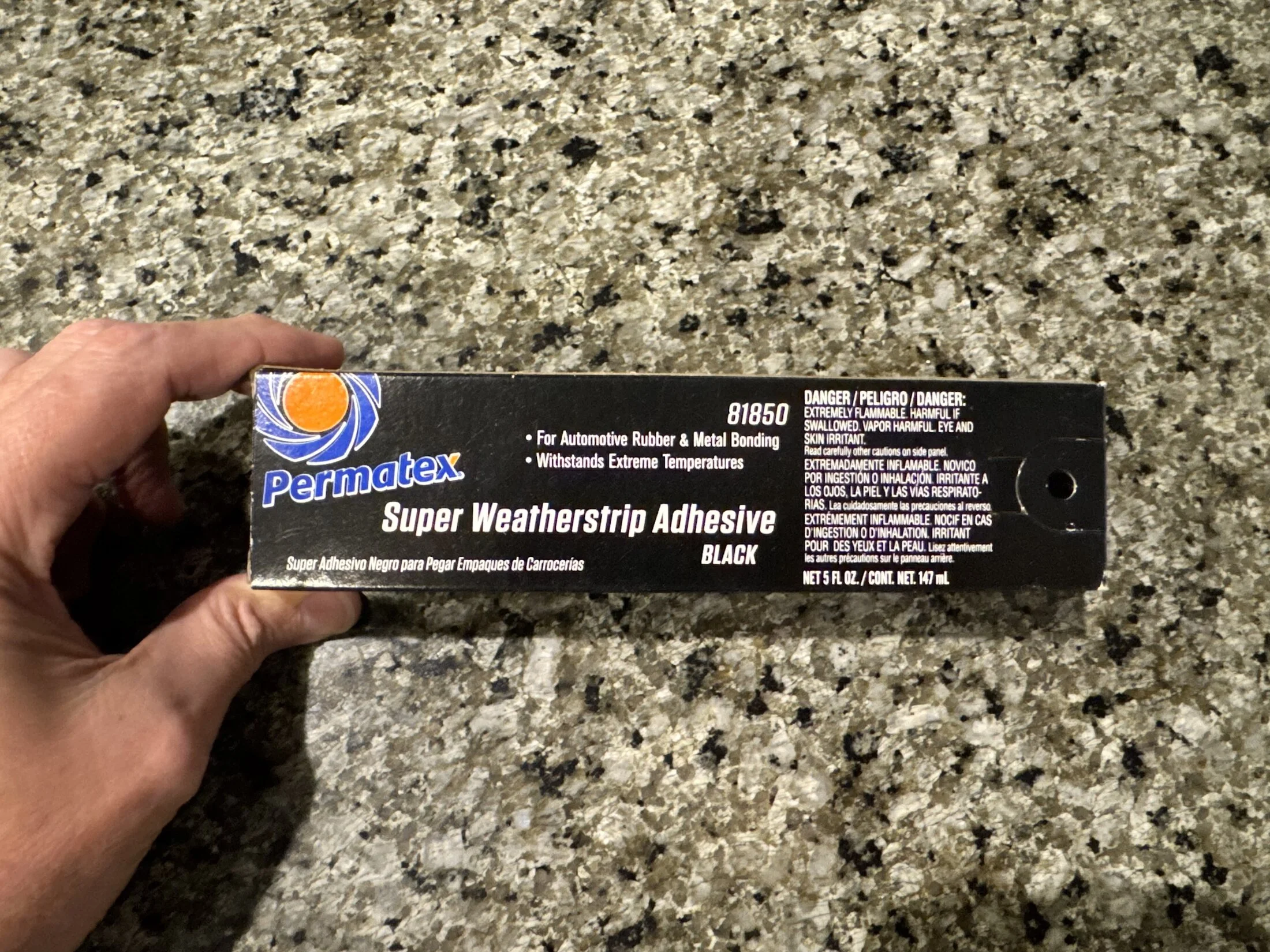

So I bought a new rear hatch weatherstrip gasket from City Racer. I’m trying to mount it to the hatch but both of the adhesives I’ve tried don’t really stick that well to the gasket. After it drys it basically peels right of with very little effort.
Any other suggestions to get this thing stick to the hatch reliably? Gorilla glue ???? 🐵

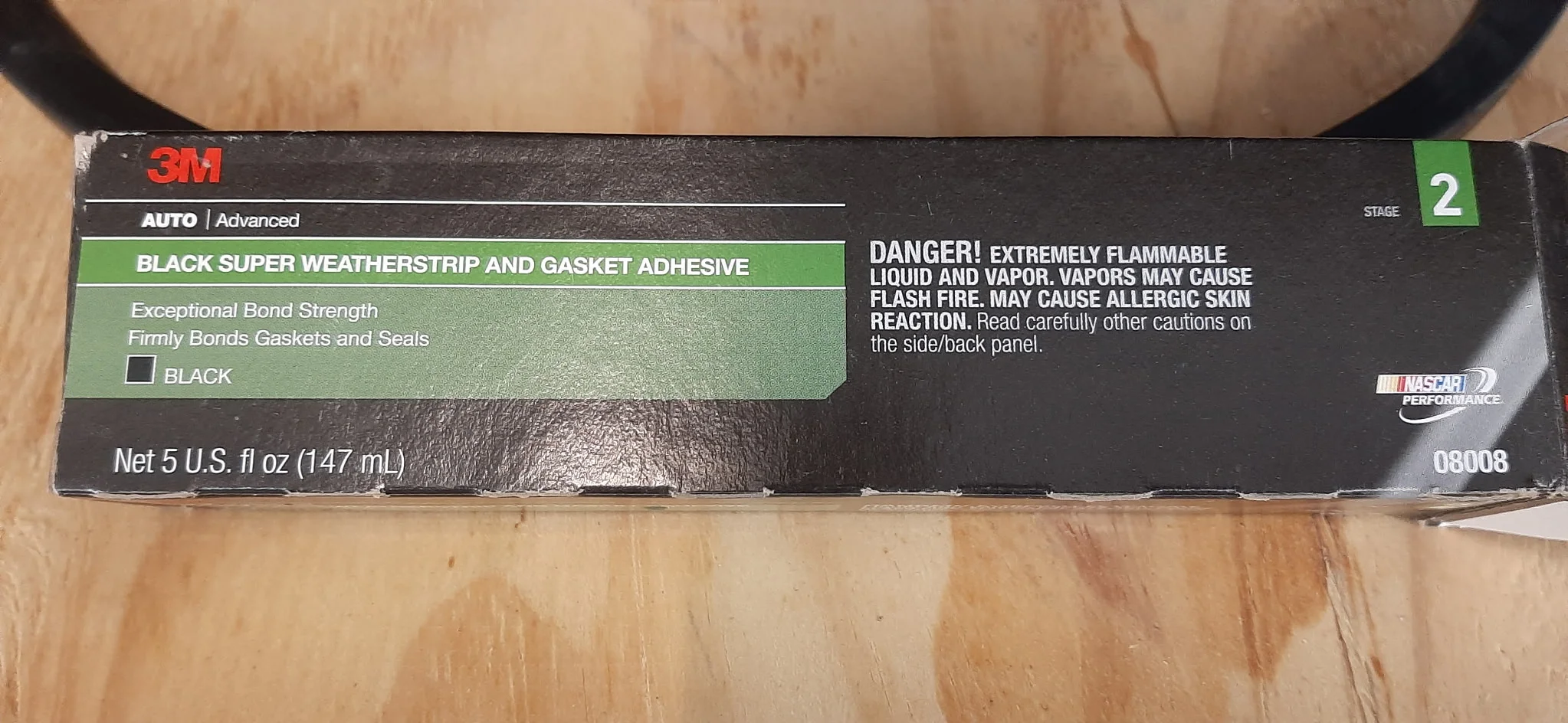

You'll find a few old threads - I used OEM weatherstrip (and 08008 glue). The City Racer weatherstrip is a different material, and think it needs 8011 instead.
MUST USE 3M Super black 08008 on OEM WEATHERSTRIP
MUST USE 3M Black 8011 or cyanoacrylate on City Racer EPDM WEATHERSTRIP
That 3M will work great.
Small amount smoothed on both pieces.
Let dry for 6-7 mins, then one more very fine bead of adhesive to one of the pieces, then stick both pieces together.
Hold for about a minute and done.
Fwiw, they also call out the glue in their FAQ - I believe the 08008 in the original post in the Super Black they mention, which is incompatible with their EPDM:
