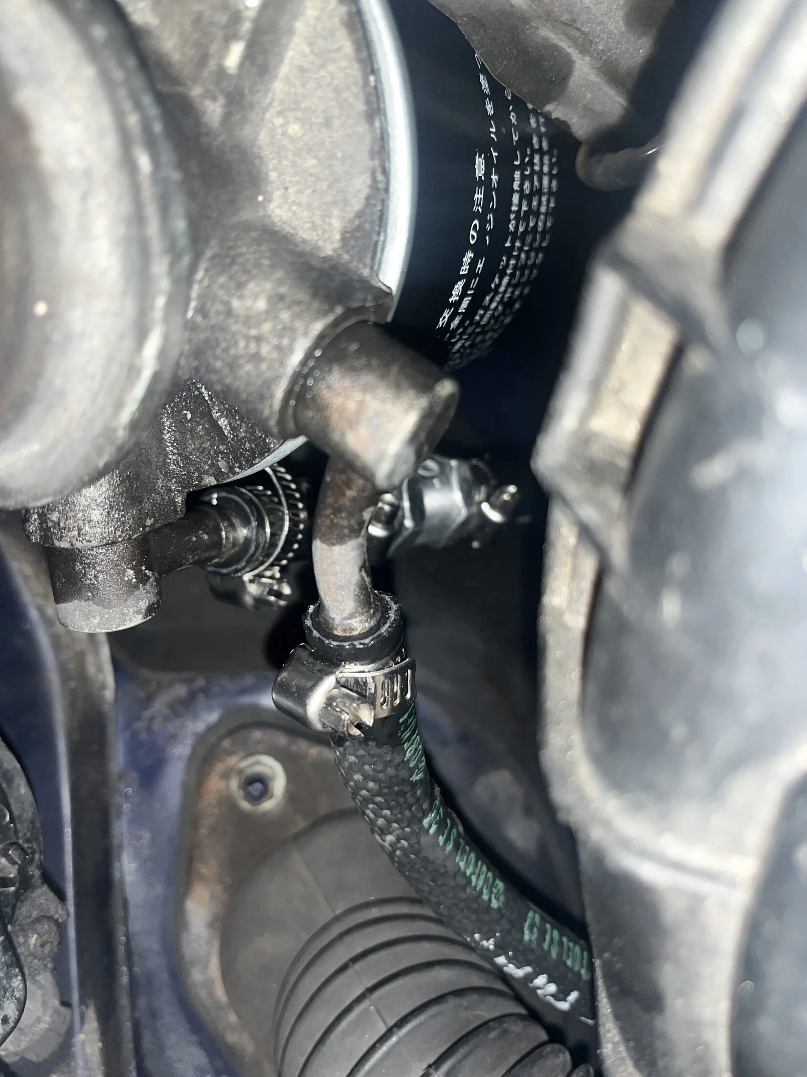

I ended up replacing the fuel hose from the fuel tank metal pipes > filter housing > Injector pump. As well as replaced the filter housing/primer pump and I placed a non return valve like this on the fuel line between the filter housing and the injector pump just for good measure to stop fuel being sucked back into the tanks overnight.

Does this looks about right in terms of placement? Did this a couple days ago, one of my buddies told me he did this on his Cummins 6.2 and worked fine. I think even if I end up putting the non return valve in I may opt for something like an airdog ii-5g. However my concern is that it’s a bit overkill in terms of GPH for a 1kzte. Even if I replace the lines and add a non return valve like you said I want to add something that will do the filtering and have reliable fuel delivery to my injection pump. Thoughts?
