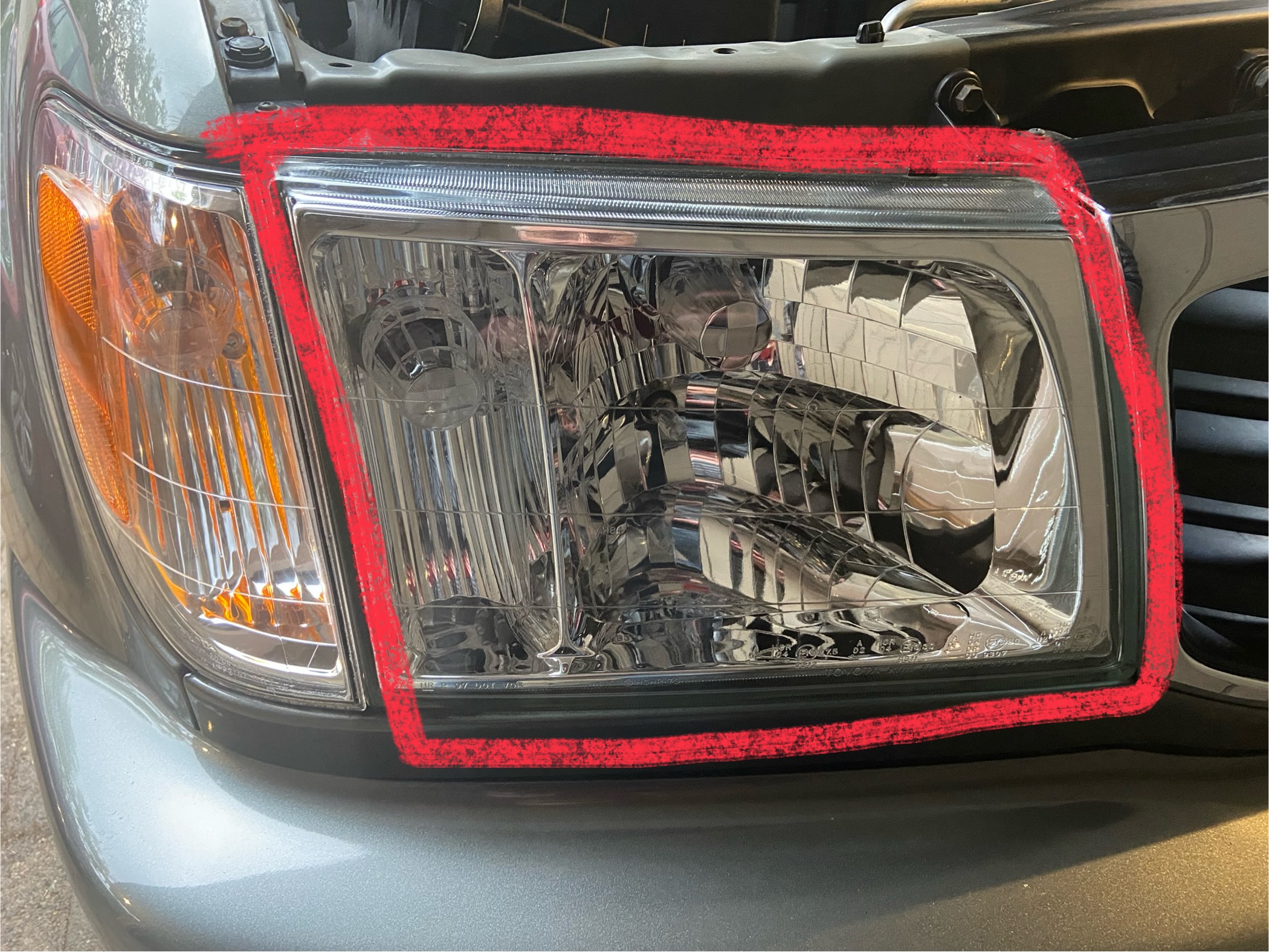

PO replaced the passenger side headlight a short while back, so the truck has an odd asymmetrical cataract. You can kinda see it in this pic:
Drivers side is cloudier. I assume that’s the original headlight. The cloudiness seems to be inside the housing. Both headlights are marked TOYOTA and Koito, plus all the compliance marks on the glass, but I cannot find a part number, though I have not removed the housing. I’m 99% sure these are not aftermarket.
I’m trying to figure out what the replacement Toyota part for a US LC100 halogen glass driver side headlight is. A VIN search on amayama and Partsouq returns 2-3 candidates.
What’s the difference between -070, -071, and -072? Looks like maybe -071 is a sub for -070?
Here’s a pic of the recently replaced passenger side headlight if that helps. This is what I’m trying to match. I just need the main unit outlined in red below, not the corner marker lamp.
Anyone know for sure what the right part # is?

Part # 81050-60072 is correct. It supercedes -60070 and -60071.
Yep, confirmed with my local parts counter guy. Apparently all the numbers are the same part, -072 is merely the latest supercession.
