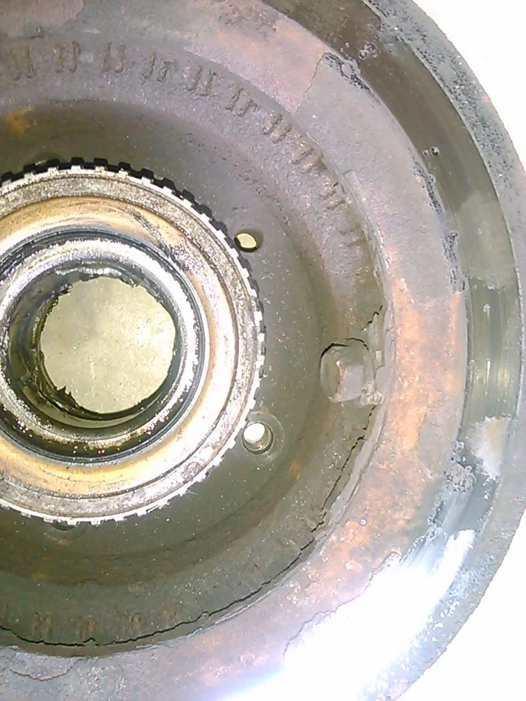

well that was easy, just finished pounding out all the studs in the rear. ok, so let me know if anybody has an idea on torquing of the hub to rotor bolts.
I have to admit I used an impact on mine on setting 3 (est 80-90 ft lbs) in a criss cross pattern to tighten the hub to rotor bolts. Then I double checked the tightness with a large 1/2 ratchet( good and tight). If you do not have an impact you could put it in a vice with a cloth around the rotor to protect the surface and then keep turning it to torque each bolt. I also used blue locktite on these bolts as well. The previous owner left me a present which required drilling one hub mounting bolt out and retapping to the next size. The original threads in the hub on mine were extremely rusted as the bolt had been lodged in the rotor for quite some time.
I had a bear of a time seperating my hub from the disc as well due to lovely rust. First I removed all the hub bolts with an impact then I rethreaded them back in about 3/4 of the way and set the old disc up on some 6x6 blocks while i tapped on the bolts with a long punch working around the hub and loosening the bolts as I go (using Kano Kroil penetrating oil as well) In the past I have used never seize on hub to rotor mating surfaces. This time I tried some marine grease.
Take some fine sand paper and smooth those cone washers out then use neverseize on them when you reinstall them. they will come out much easier next time. Also check the outer hub where you tapped on it. While this does work to loosen it that hub seems to be of a softer metal and can deform slightly where it was tapped. Check on the underside any deformations can be fixed with a fine metal file then fine sandpaper so the area is 100% flat again. A brass punch used on the studs is the FSM method.
Correct me if I am wrong but are the right and left side of the truck wheel studs different part numbers?
My truck according to Lexus was all the same part number Sean. Yeah I think the rust is why these things were so stuck together. I do have an impact so I'll use that to get them on, and ensure at least 90 pounds to be safe using my new torque wrench. Thanks!
