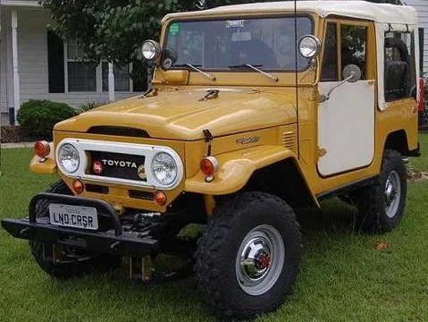

This is what I'm looking at:

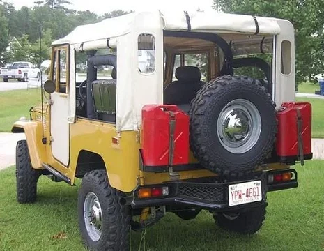

It was maybe an inch or two wider IIRC. I put a FF RAX from a 70 series on my 40 to retrofit lockers a while back, but I was running stock wheels and skinny tires so I had no problems with track width extending outside the wheel well.
If it winds up too wide for inspection, go with fender flares:meh: I do not miss the annual JCI inspection fleecing:grinpimp:
edit: Pics with the 70 series rear axle and stock rims
