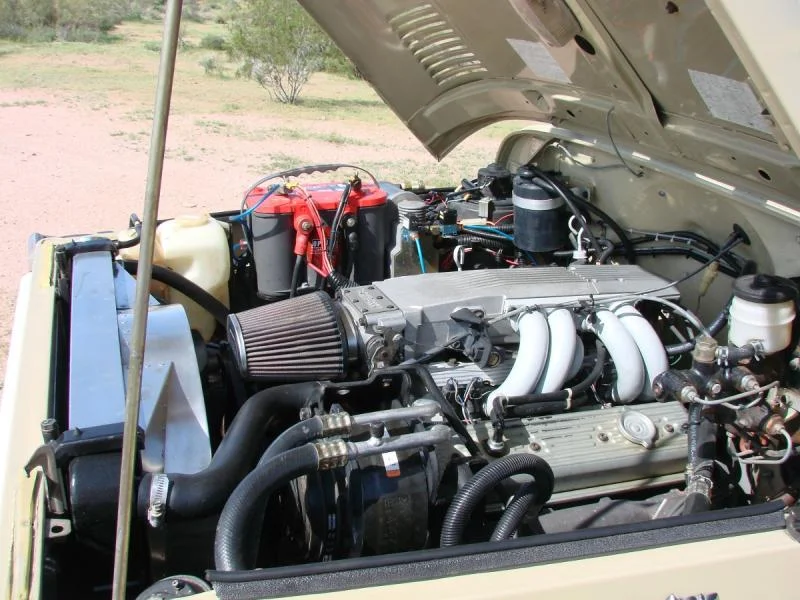

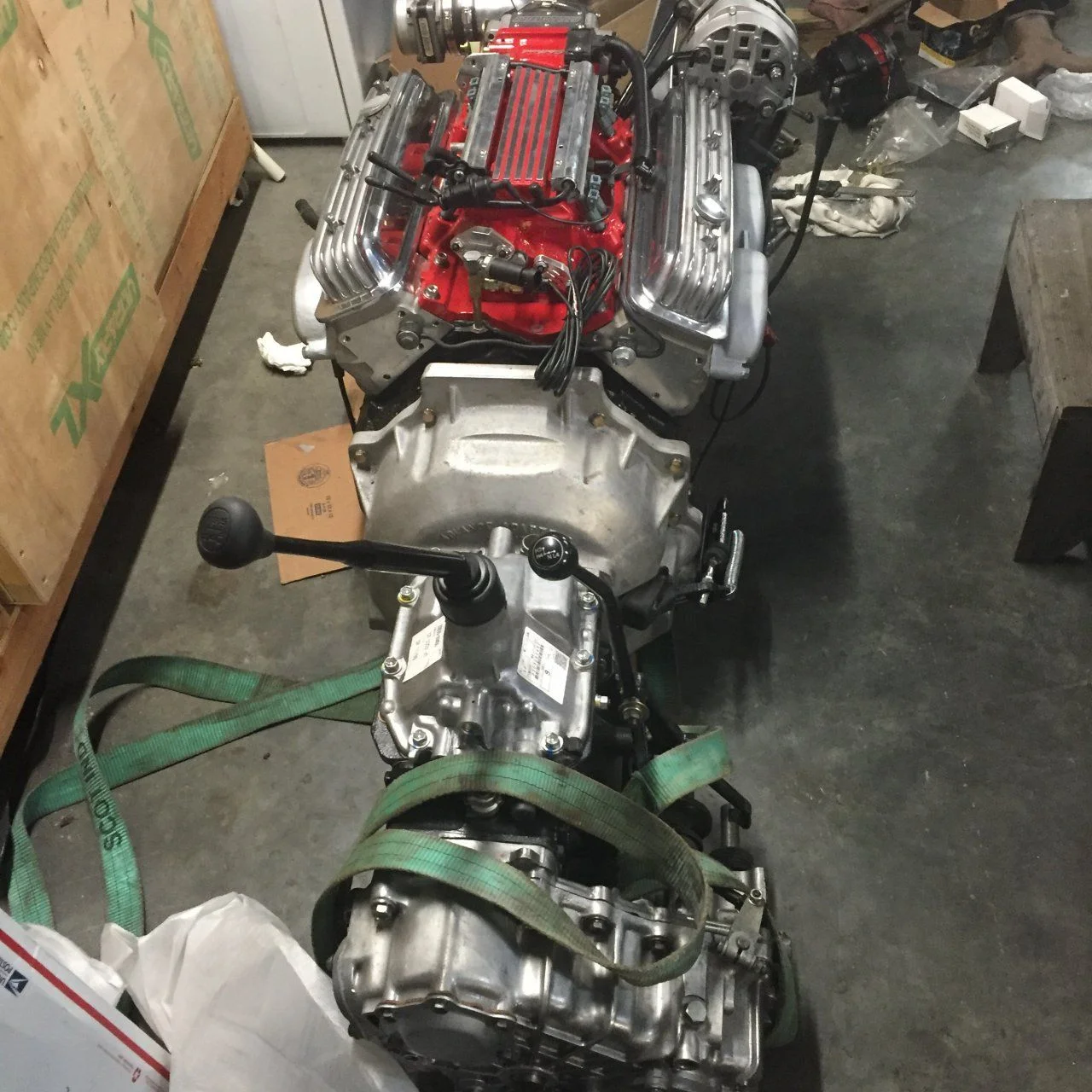

Well, this has not made it into the frame yet. but the combination is a 400 HP LT4 (mid 90's), H55 / 5 speed, and a split transfer case
Gary

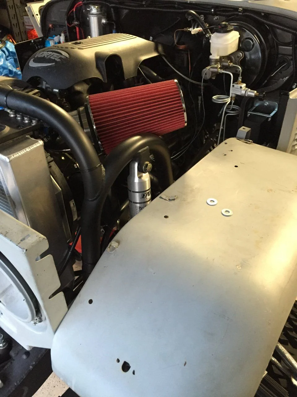

L98 5.7 tuned port injected (TPI) with the 4L60 4 speed Automatic transmission. I like the L98 because it has incredible low end torque which actually comes in at approx 200 ft lbs like the stock 2F at the same 1900 rpm...
ARB locked front and rear with 4.56 gears.

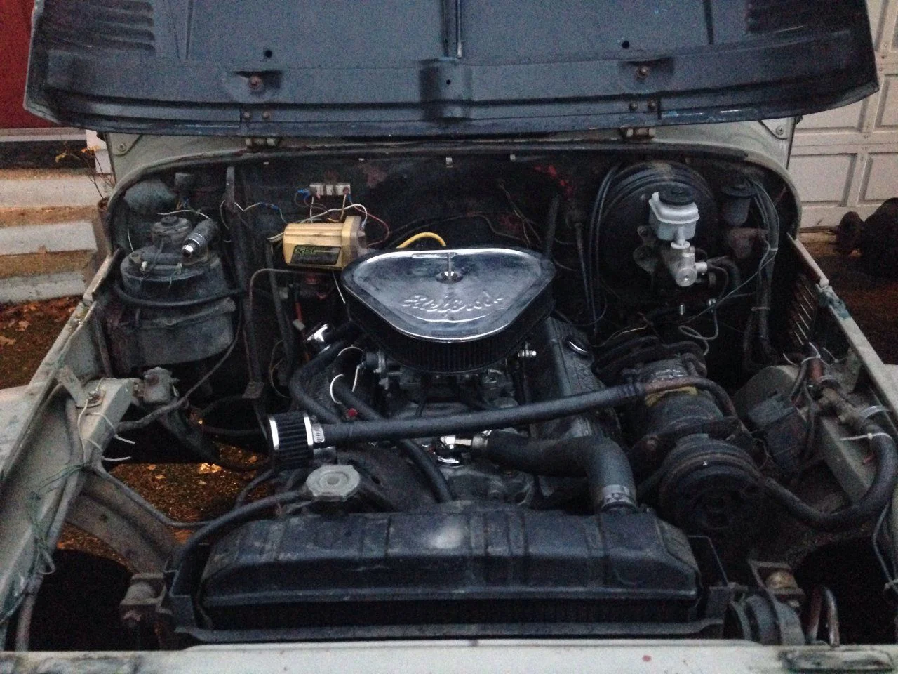

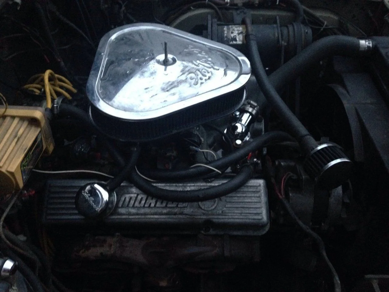

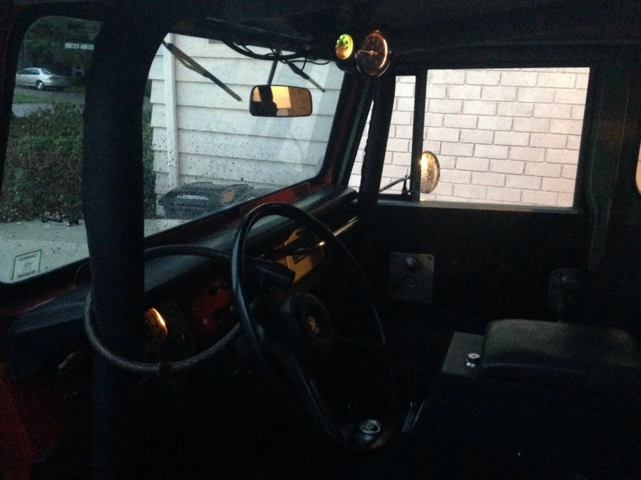

Sept 69, 350, Edelbrock 1406 Carb, Edelbrock S.P.2.P. Intake, Toy 4 speed, 3.70 Gears, 33s, 4 wheel Discs, 80 series Master & Booster, rear air bags, 81 hardtop, FF rear axle, newer frame, 6 pt cage, Tuffy 60 series console...

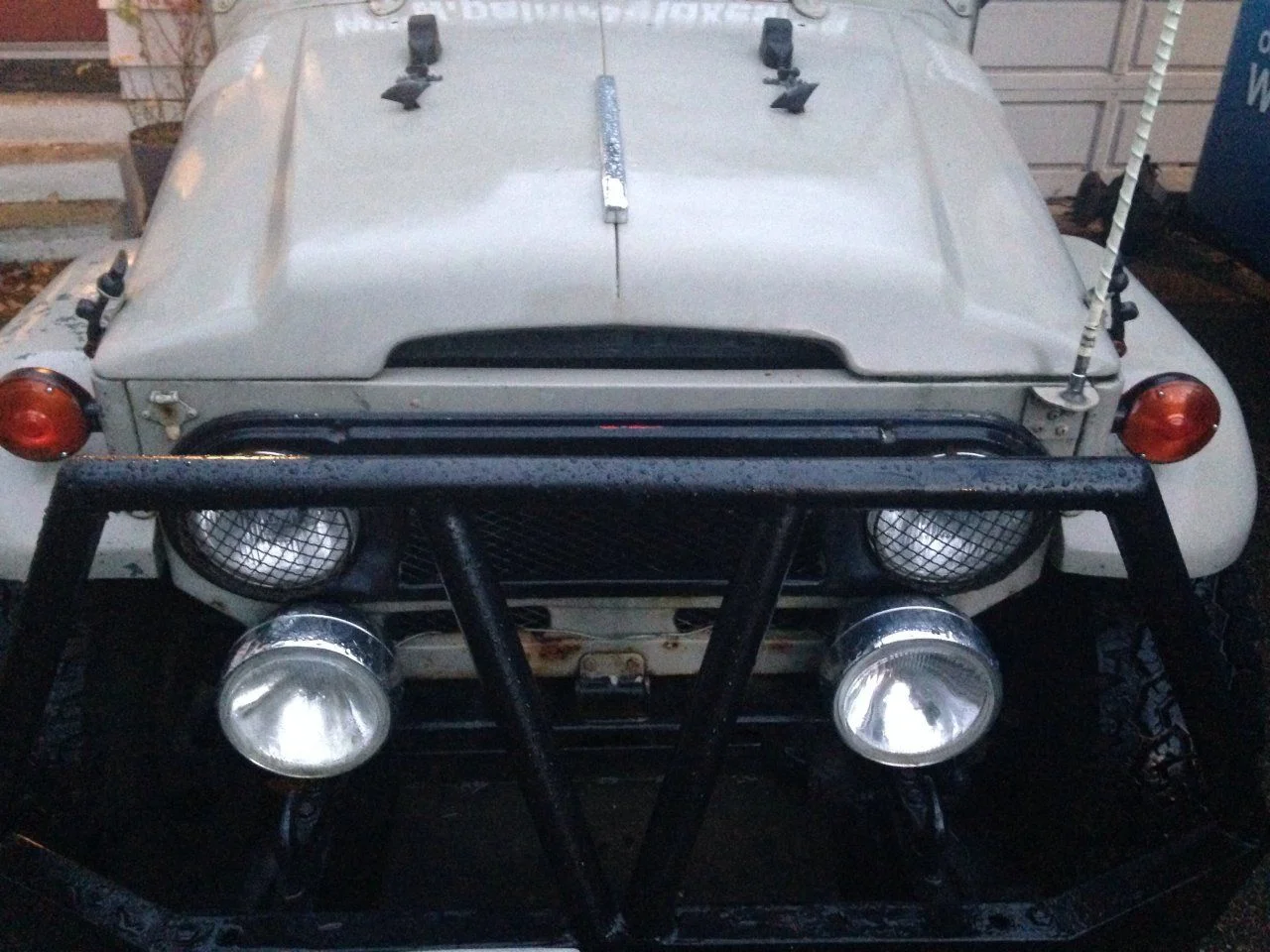

Maybe this don't count cause it's yet to be running, but I chucked a 4.2L Holden V8 in after two dead F's. Opted for the J30 for the old school feel.
Pic looks like the car is a pile of sh*t - and I guess it is next to some of these, but I dialled up the colours to 'rat' it more heavily. The perks of Instagram ;)
