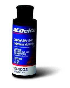

Thanks for respond John
So, I can use API GL-5 90 (single grade) in my differential with LSD additive
Like this ACdelco
How much should I use in my differential? one bottle for each!!??
( front differential capacity is 2.85 L)
( rear differential capacity is 2.4 L)
Thanks again.
