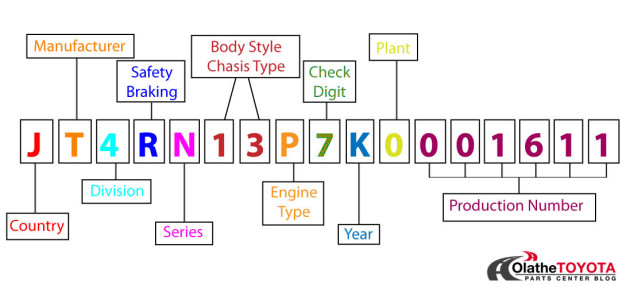

You mean this, right
Bu this doesn't help me about my DIFFERENTIALS
Thanks anyway.

Nah you wont get any diff info off the vehicle VIN you need to get the codes off the body/data tag on the firewall as phrog said, there's plenty of sites on the net to translate the data this one comes off the link at the top of this page
