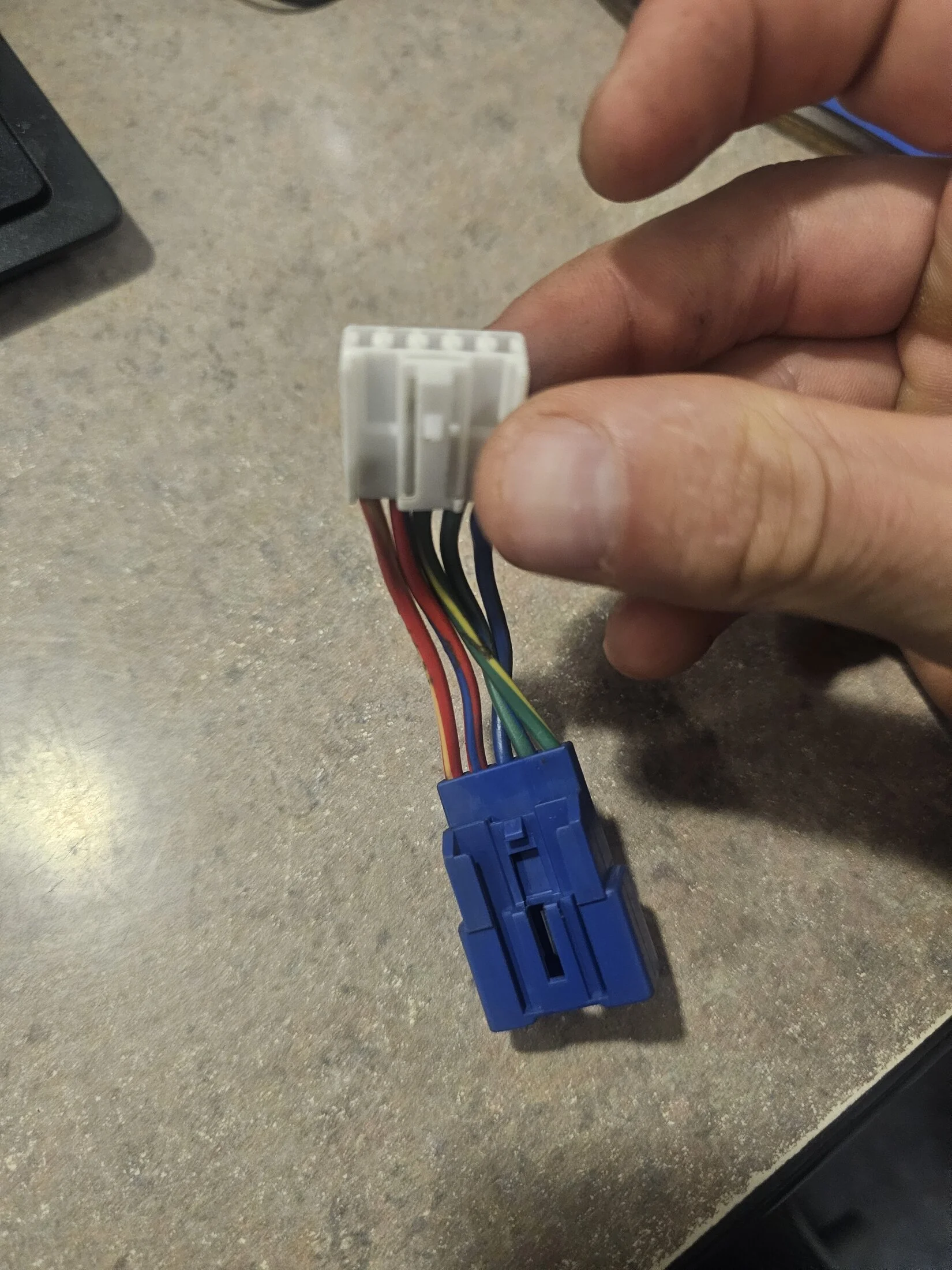

I am struggling to source a used passenger (LH side) window switch 84810-60010, for my 97 HZJ70, Toyota stopped making them so new part is impossible. Does anyone have a used switch I could grab up? Thanks
Post a pic of your switch and the connector?
I don't have the switch this is the connector.

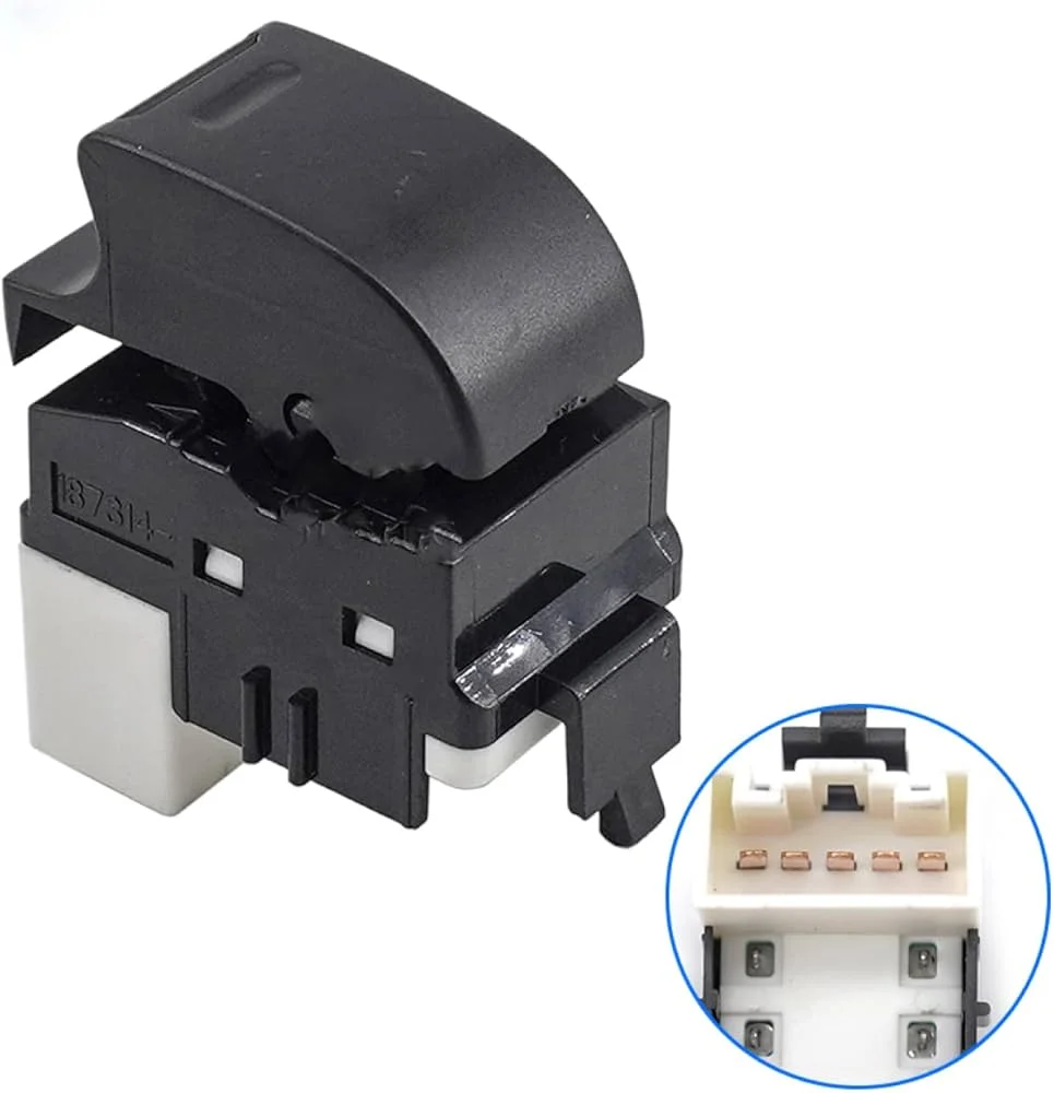

try PART # S8481-01260 for HINO.
Hino is owned by Toyota. I purchased and it fits

It is just a switch and has no anything electronic besides it. You should check for a short circuit somewhere. Motor regulator would be the first suspect. I have seen them burned and shorted before.
yeah, I have a 1991 HZJ73, was looking originally for the part number you provided, couldnt find it, after plenty of research found that hino switch and gathered that some 24v hino trucks use it as well as 12v, so like vitaliy yakub said, your window motor might be causing the 30A fuse to blow. and yes the fit is exact.
