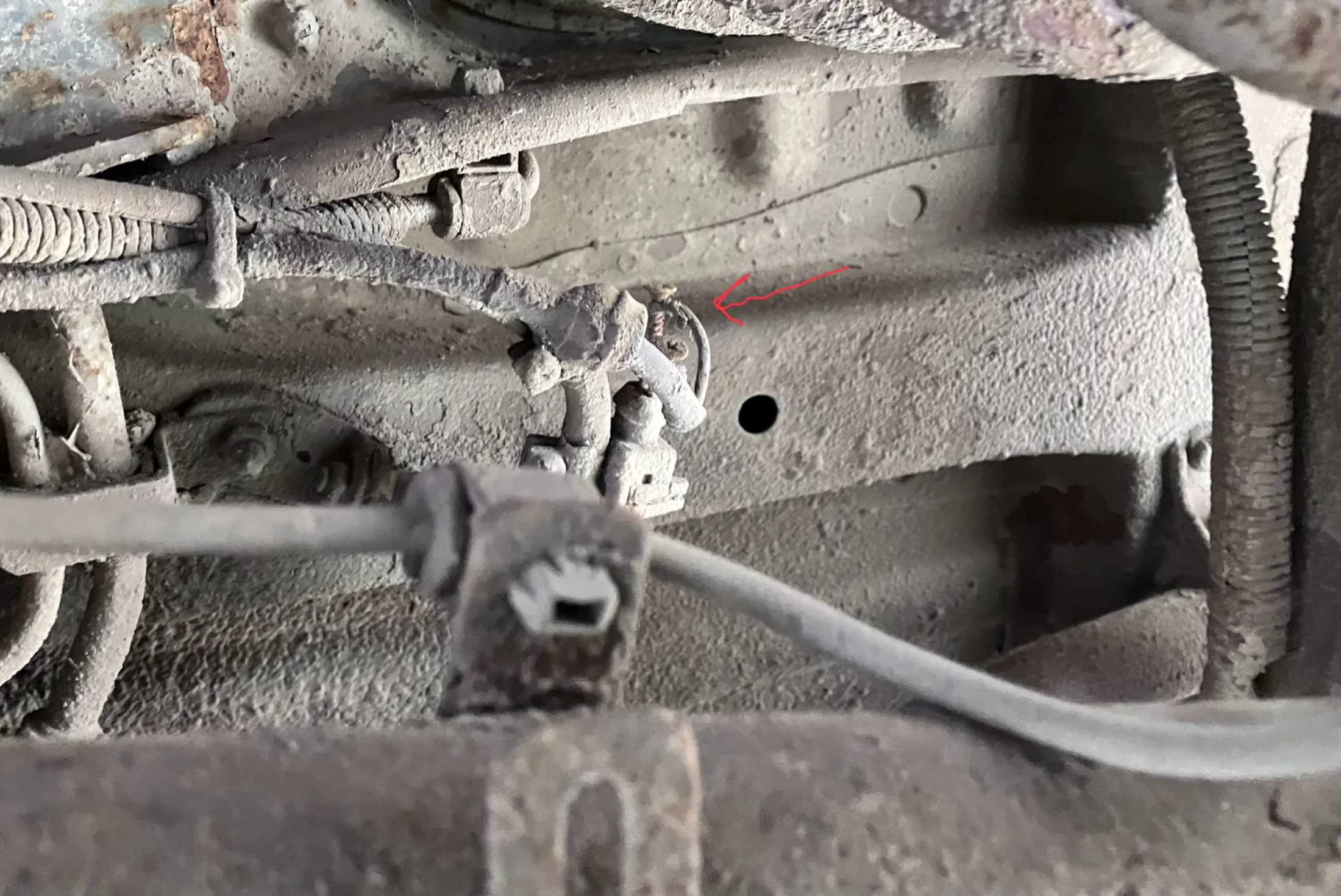

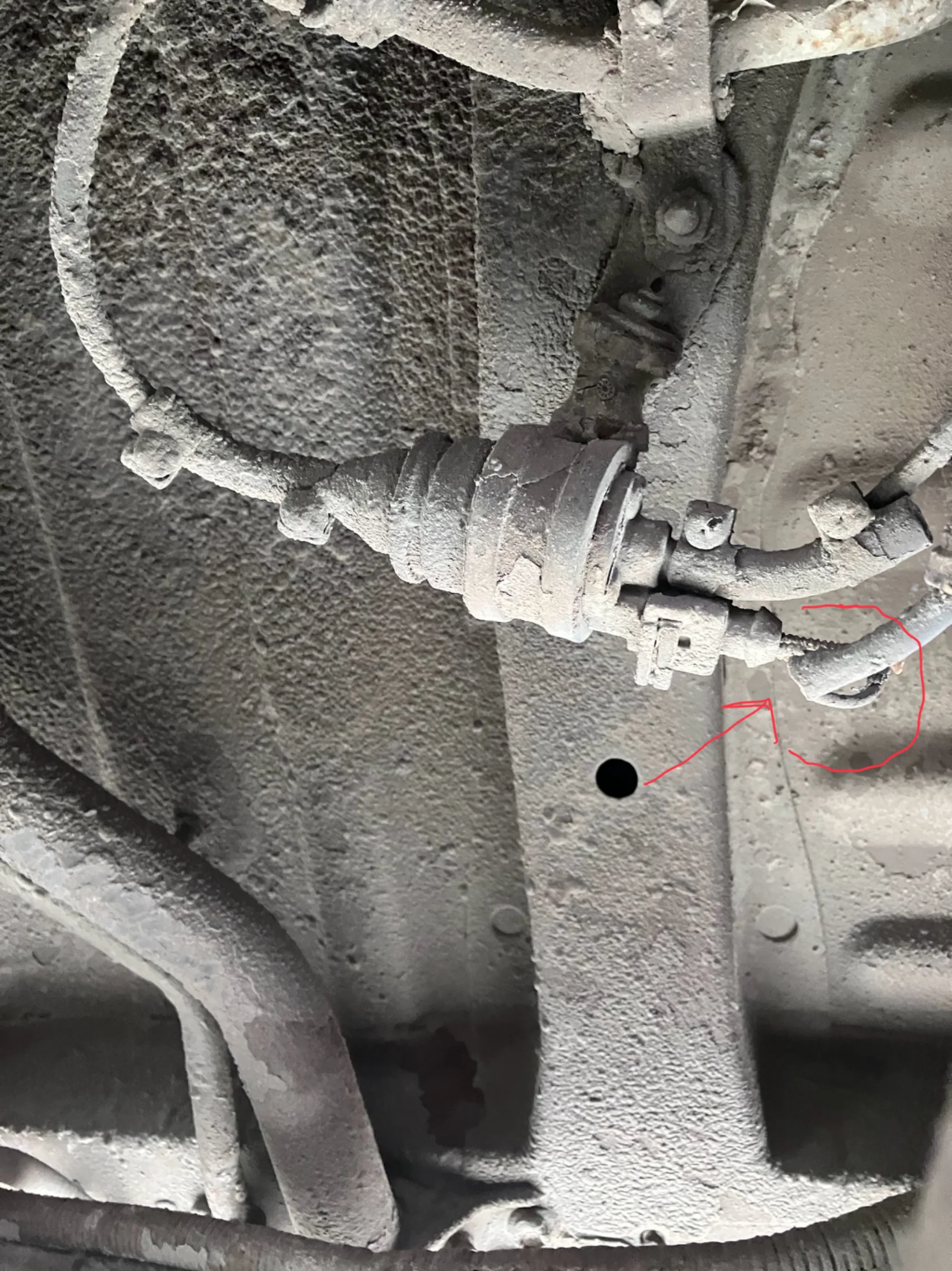

I am looking for assistance in identifying a component. While under my new to me HDJ100L changing the CDL switch, I found this on the left side past the transfer case toward the rear. You can see the screw that has been made into an electrical terminal. Looking for a steer on what component it is so I can further research and formulate a plan. Thank you.
I would say that is a fuel pump for a diesel heater. Eberspächer or Webasto.
Yes, seems to be a Webasto dosing pump for an auxillary heater. If you keep it, I'd certainly redo that electrical connection.
Swed and HDJ80L, thank you both for the identification. I am on it!
