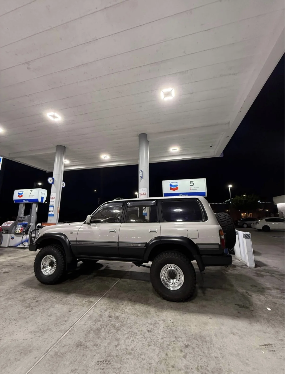

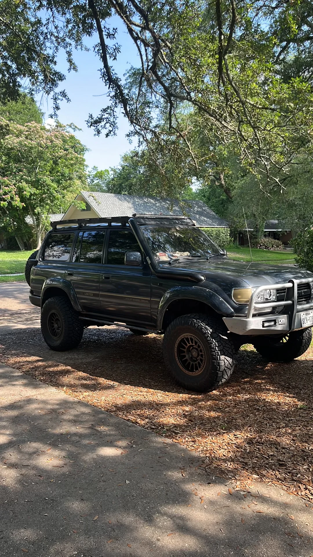

#2 truck all day. Eespecially if you can more easily check it out in person before purchase. With your goals you don't need or want that huge lift the first one has. There is no way that is a 2" lift, that looks like a 5-6"" to me. Honestly with your goals it doesn't sounds like you even need lockers, I would do a winch first if it doesn't already have one. Actuators are a lot less then $1500 too.

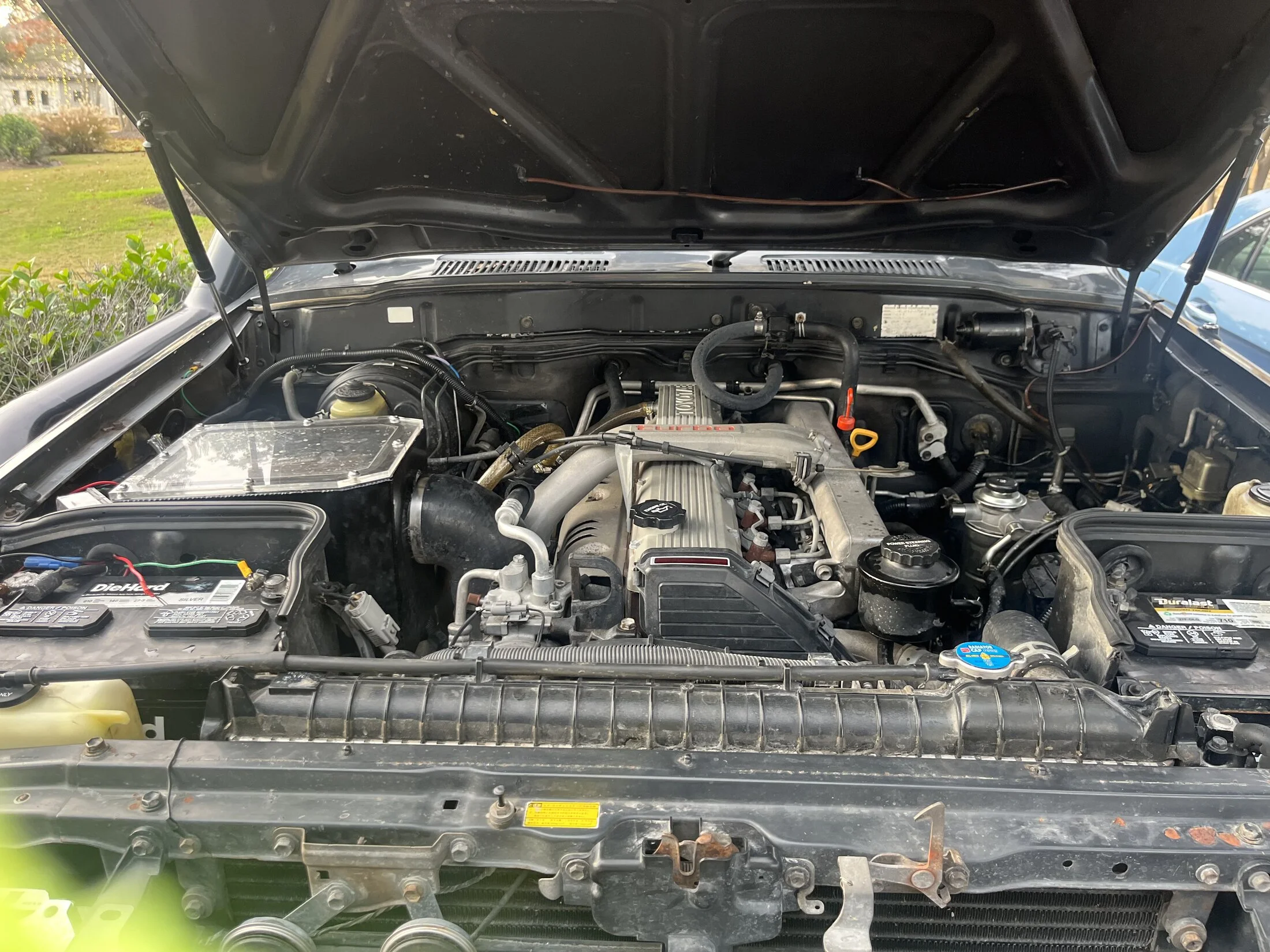

Additionally, having worked on both HDT and HDFT's I would take the HDT and turn up the boost and intercool it over the 24v FT. I have had much better expereince with maintinace and repairs and fast parts availablility on HDT's then FT's

Not sure which picture you’re referring to, but the grey/black one is the 2nd one (I accidentally put it’s picture first) and he has a 4” lift (assuming that’s suspension + body lift) The two tone one with the chrome wheels is the first one I believe it’s a 2” lift but I haven’t confirmed what lift he has on it.

I'd take a hard pass on the 4" lifted one.
Anything over 2" lift is unnecessary for your use case.
Beyond a 2" lift, you start introducing a lot of compromises.
Driveline vibrations are pretty much a 100% certainty with 4" lift.
Handling is compromised.
COG is raised. ( lots of rolled, lifted 80s in the ih8mud lore if you go digging).
If the 4" lift isn't well sorted, you could easily spend as much fixing it as you would on ARB or Eaton lockers.
You can run 35s with no issue with a 2" lift. Again, your use case doesn't need 35s. 33s. and 2" lift would do what you describe with plenty of capability.
Unless you're going for really big power with modified turbo, injection pump, intercooler etc, there's not a lot of advantage to the 24 valve.
1hd-ft do make more power in stock form, but both are capable of some pretty healthy gains with the usual performance tweaks.
24 valve has a bigger advantage in higher RPMs, higher than what most people will typically use.
A tuned diesel does all the exciting stuff at low RPM - ie, makes loads of torque
1HD-T needs an eye kept on BEBs, but this can be managed and isn't as big a deal as ih8mud would have you believe.
1HD-T valve shim clearances are fiddly to adjust.
1hd-ft dual valve rocker arms are fiddly to adjust too.
1hd-ft runs higher injection pressure, so there's some advantage there in terms of power and fuel efficiency and emissions.

With a 3" exhaust and a tune up, both engines will have no trouble with 35s without regearing, unless you're towing heavy loads or doing really steep off roading.
If you're boosting above 14psi, then an intercooler will be beneficial.

I do agree with you that the 4” lift is unneeded and adds a lot of unnecessary strain. I wouldn’t mind swapping back down to smaller lift and reducing wear and tear.
