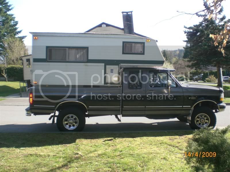

We just picked up a 8' camper from one of cindy's co workers for $100. It was in the middle of being "fixed up", the old 3 way fridge and water tank were rippped out and I have a 3'x2'x2' hole where there once was a fresh water tank and fridge.
I dont care if i put in another propane fridge, I was thinking about using foam insulation and then fiberglass to make an ice box, my uncle made one of these for hunting and though its much colder in october when they go hunting the food stays frozen for the entire week.
