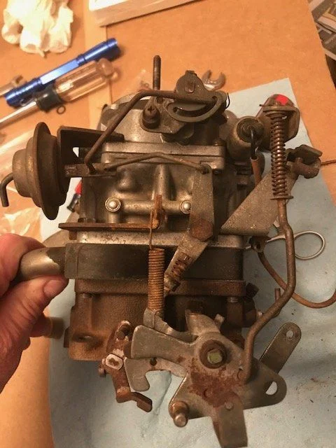

So after a year, I've started working on my barn find 75 FJ. I rebuilt the carb thanks to help from everyone here. Sadly I've found why it probably ran so crappy. I'm missing one of the carb linkage arms from the choke butterfly down to the C arm.
I don't want to do a shady core trade, I'll build a new arm, but didn't know if someone knew where I could buy a single part? Looked over the weekend and only found full carb rebuilders.

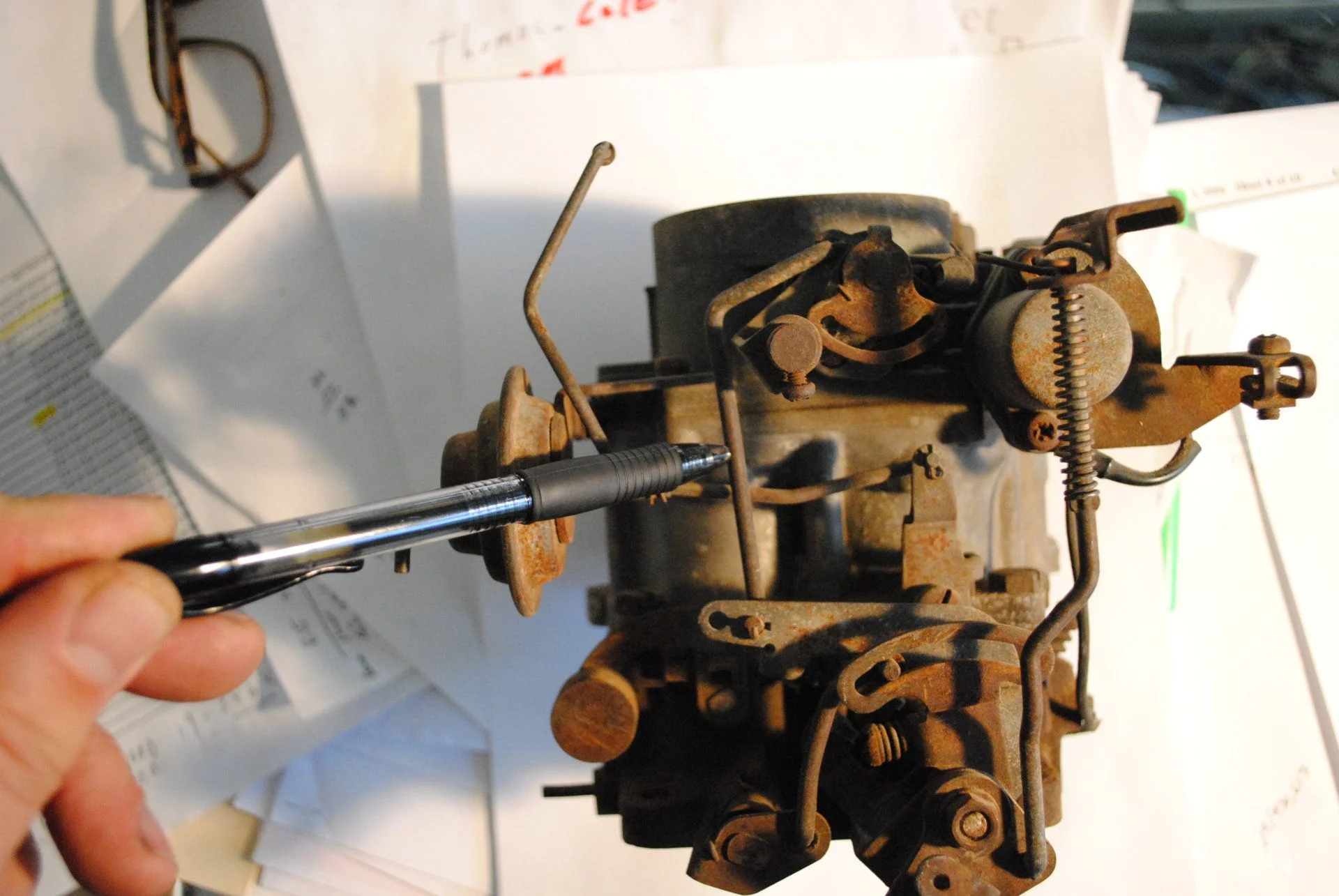

Thanks Ragingmatt, that's the one I'm missing
I have this one off a parts carb. I think the carb is a bit earlier. Wonder if it will fit your year.
No , it will Not fit
it needs to be shaped exactly like the one in the example photo diagram
thats a F engine 1974 carb rod
he needs a 2F carb Rod
it is understanding that a 1/75 - 8/76 will have the same linkage rod he needs provided His carb also falls into that pro date range as well
