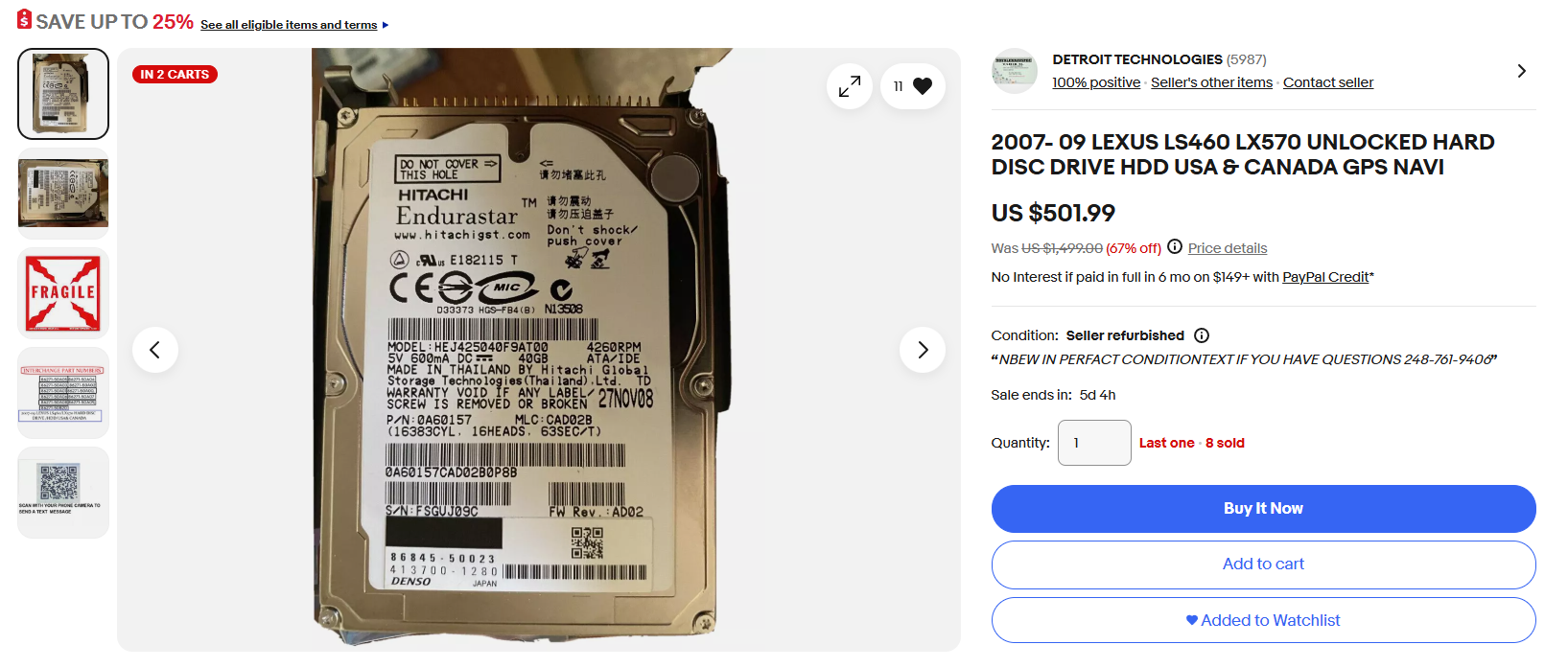

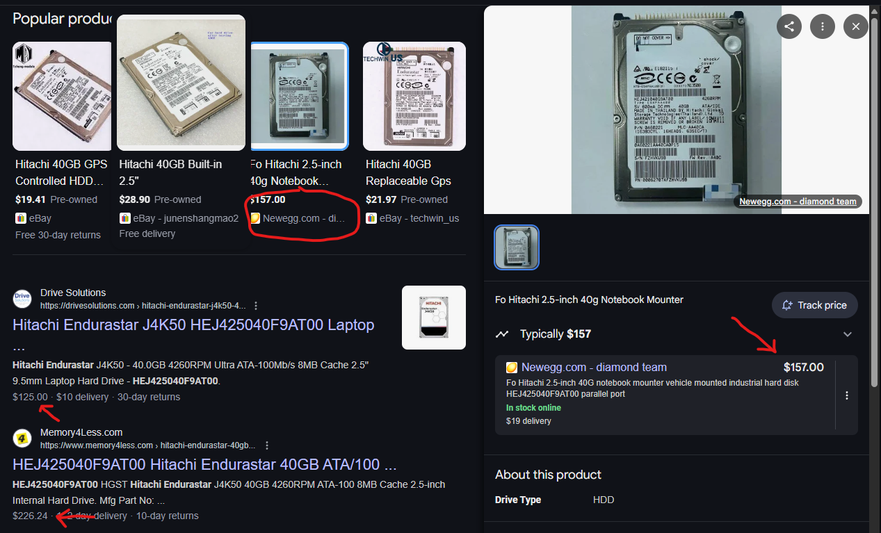

So, I'm debating buying either an "ebay-new" HDD, or wondering if buying the exact part number for the hard drive from New Egg, would be worthwhile.
Based on research here, the hard drive is a Hitachi Endurastar "hej425040f9at00". Here are the specs:
Here is the one on ebay, it's $500.
Here is the exact part number, that's available all over the net, brand new, for between $125 to $225:
