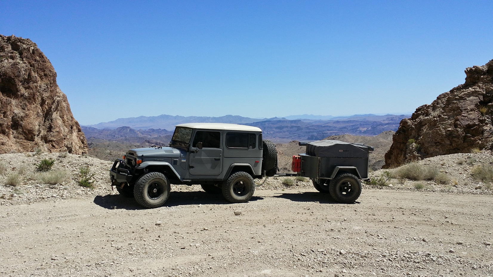

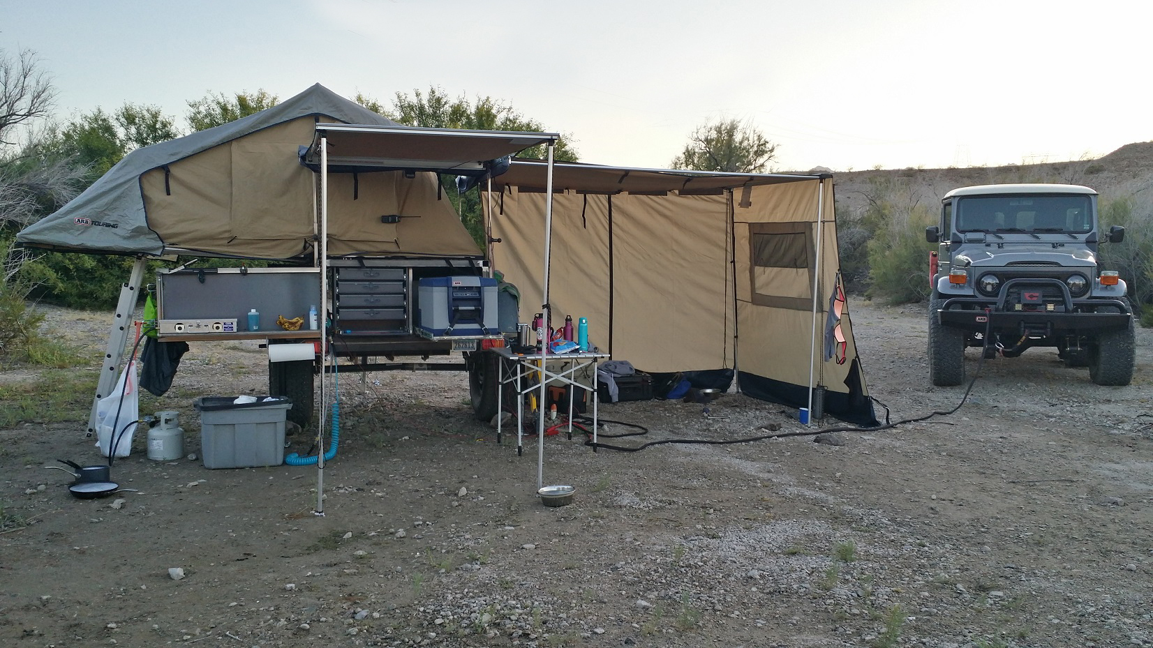

Went camping over the weekend and really enjoyed the setup! After using it twice now, I can remove everything, finalize the metal work, plumbing, and wiring, paint it, reinstall everything, and it should be finished for good!
Awesome little spot on the Colorado River by Lake Mohave

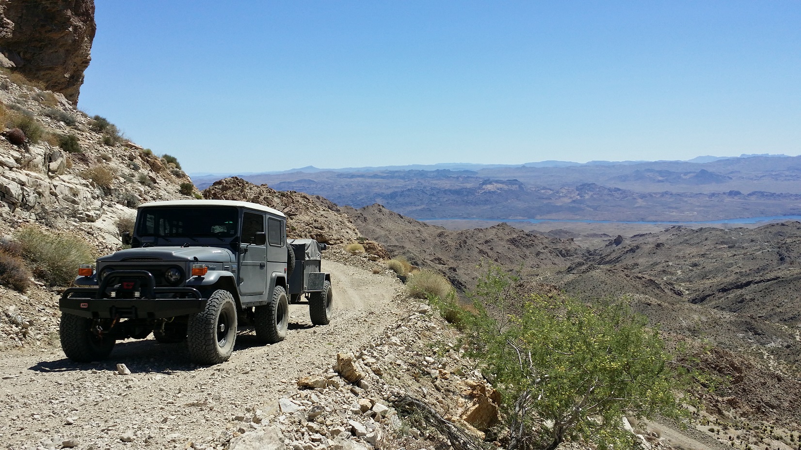

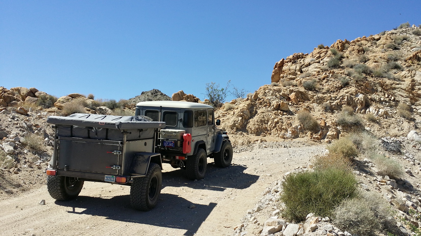

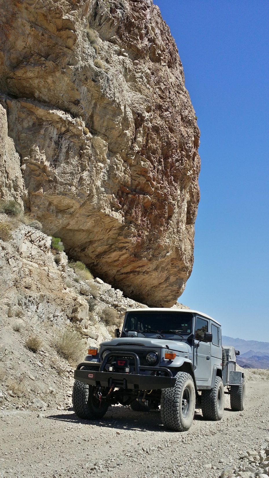

We took a different route out than we did in. It took almost twice as long, but the views were amazing and the trail was awesome!
Wife wanted to drive for a while

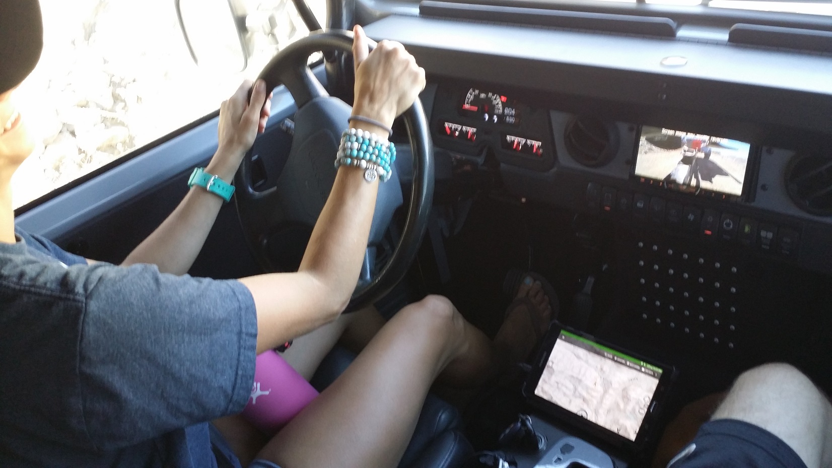

We are able to keep the reverse camera on to keep an eye on the trailer on the trails
We had a great weekend! 40 and the trailer did great! It was nice having the AC blasting on the way home in 95 degree desert heat!

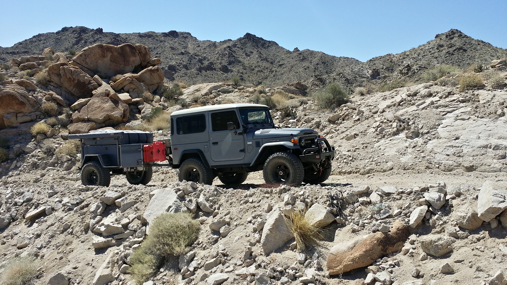

I bet that thing flexes nice. Whatever springs you used, looks like they give you a great shackle angle unlike many 40 series sua lifted springs.
It's pretty good! I feel like the springs are broken in now. I have almost 7,000 miles on it since the rebuild.
The rear spring hanger locations are stock, but the front are slid forward a bit. I was able to dial in the shackle angle before welding them on. I was initially a bit nervous about using longer shackles due to the angle, but it all worked out.

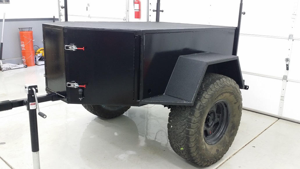

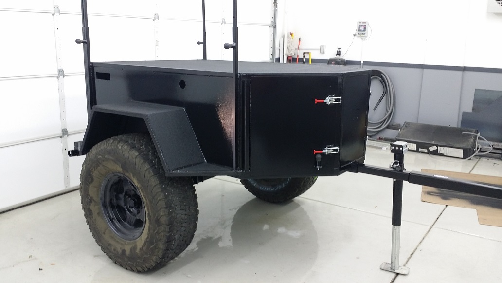

Continue to love the build man. A few questions on the trailer...
1. Is there empty space inside behind the drawers and fridge? It kinda seems so...
2. If so, how do you access it?
3. Did you coat the inside with something? Or will you just paint it?
4. Did you add shocks to damped the trailer's ride at all?
Hey there!
1. Yes, although the fridge takes up about 2/3 the length of the trailer. The drawers only take up about 1/5 of the length. I did divide the two sides with a divider so I could keep everything separate (mostly firewood from our other camping stuff).
2. I thought about hinging the top because that seems like the popular thing to do with these trailers. But I can't imagine having to get in the trailer with the entire camp set up. The tent would have to fold a bit, messing up the bedding and anything else inside. Plus, the awnings and tables would be in the way. Lastly, with the height of the trailer sides, it would be extremely difficult to access anything on the opposite side of the opening or down toward the hinges.
I decided to do 2 doors up front. Each door is 22x22", so plenty of room to access each compartment. The doors have pins on them to lock them in the open position while at camp.
3. The inside is coated with POR15, and the bottom of the insides are Raptor Line'd as well.
4. No, not yet! But I need to! The last time I was off road with it, I aired the trailer tires down to 15 or so and it didn't bounce at all, but I will still add them soon!
