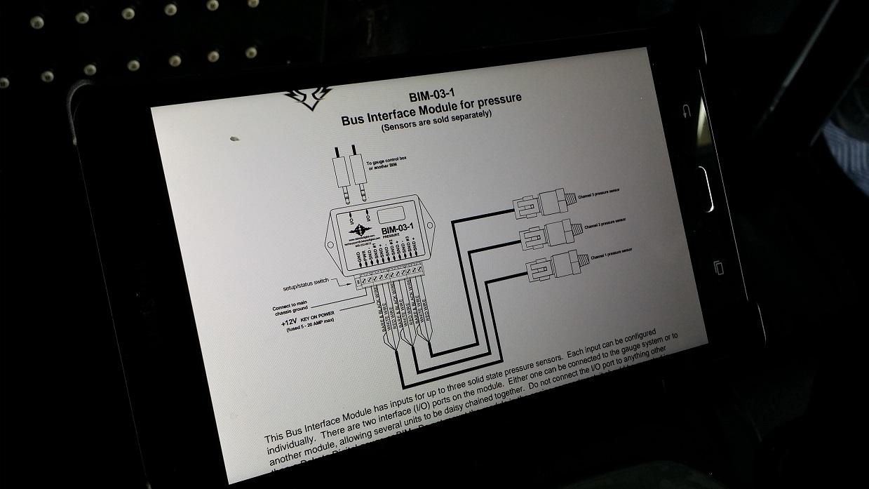

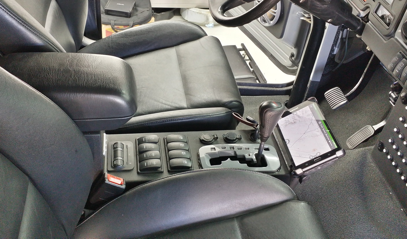

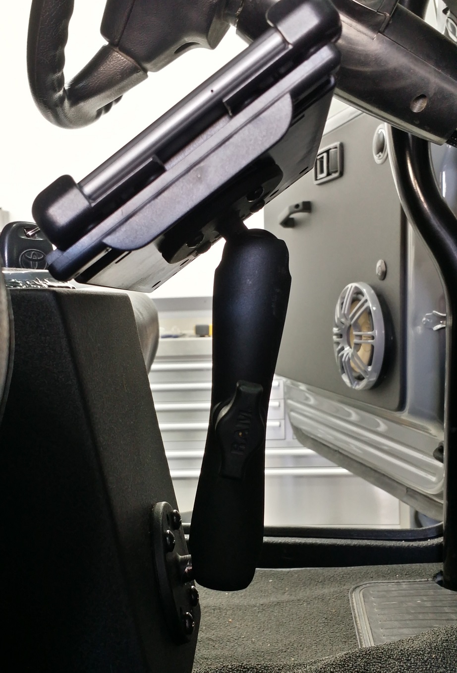

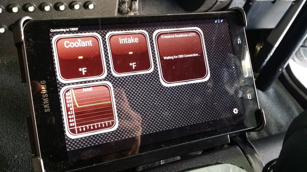

Recently I added a RAM mount tablet holder for an 8" Galaxy Tab. With this tablet, I can use Google Maps, Backcountry Navigator Pro, and Torque OBDII software. I also have a lot of music stored on it, which streams via Bluetooth to my receiver.
The biggest reason I added this tablet was to access information. I uploaded every user manual, FSM, and wire diagram from every component used on my 40. Hopefully I won't need to use those on the road, but you never know! Also, if I ever sell it, the new owner would have access to all information regarding my 40.
Here is the RAM mount. It has the short arm and 1" ball-

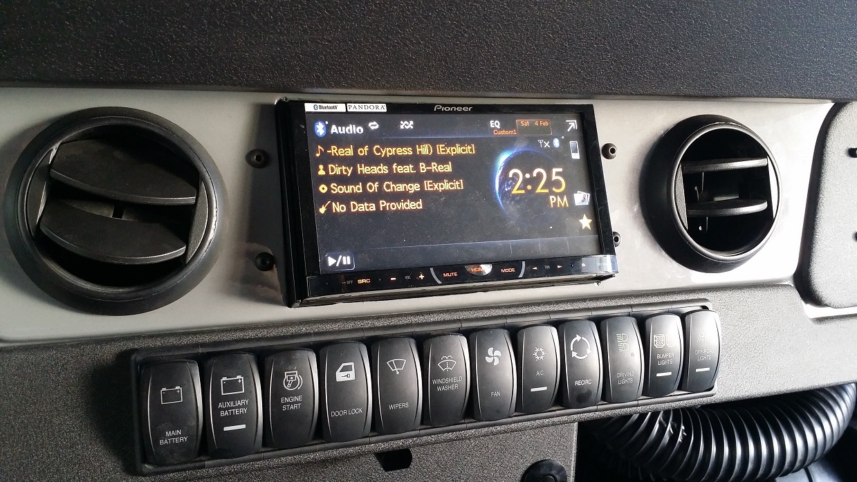

The console setup-
Some tech files-

Torque OBDII software-

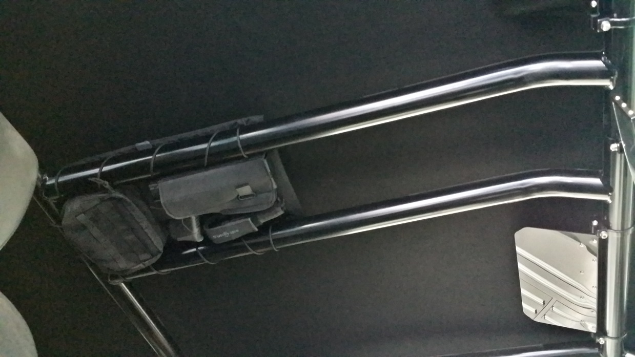

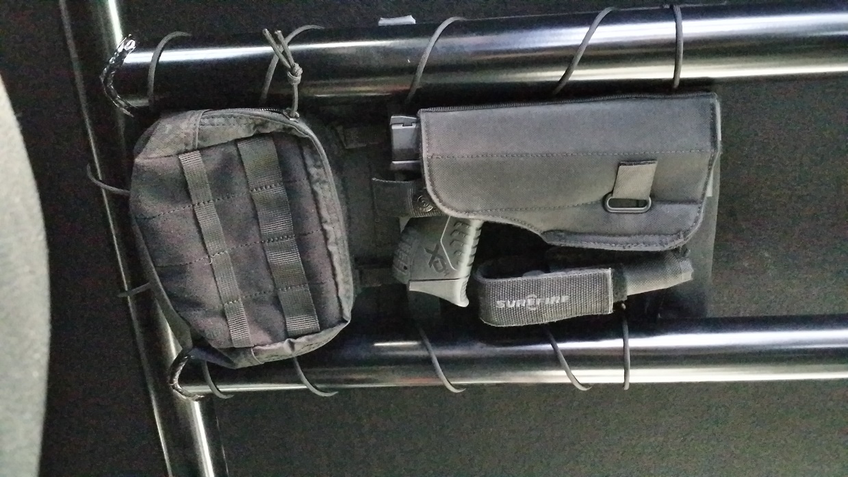

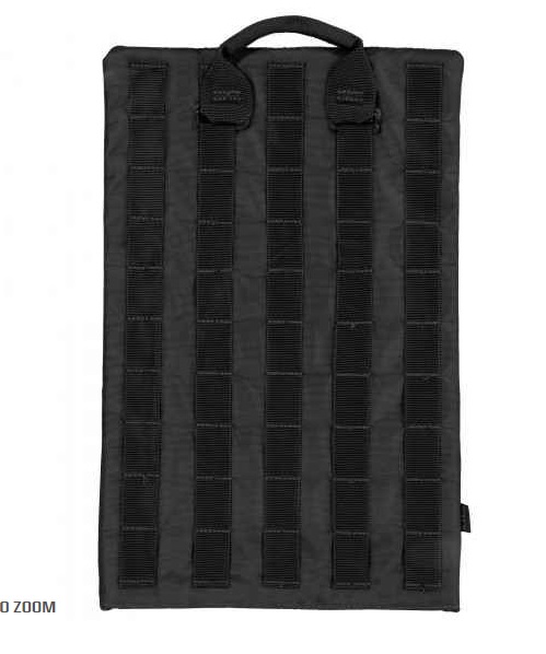

I have been looking for a good place to store a few things, including my gun. 5.11 has some awesome accessories, and they have store close to my work. I found a panel, holster, and pouch. The width of the panel happened to be the exact distance between the Metal Tech center bars (about 10.5"). I attached the MOLLE panel with some black paracord, and attached a holster, pouch, and my flashlight! It is tucked up and out of sight, especially for someone peering in through the windows!
15x10 MOLLE panel-
