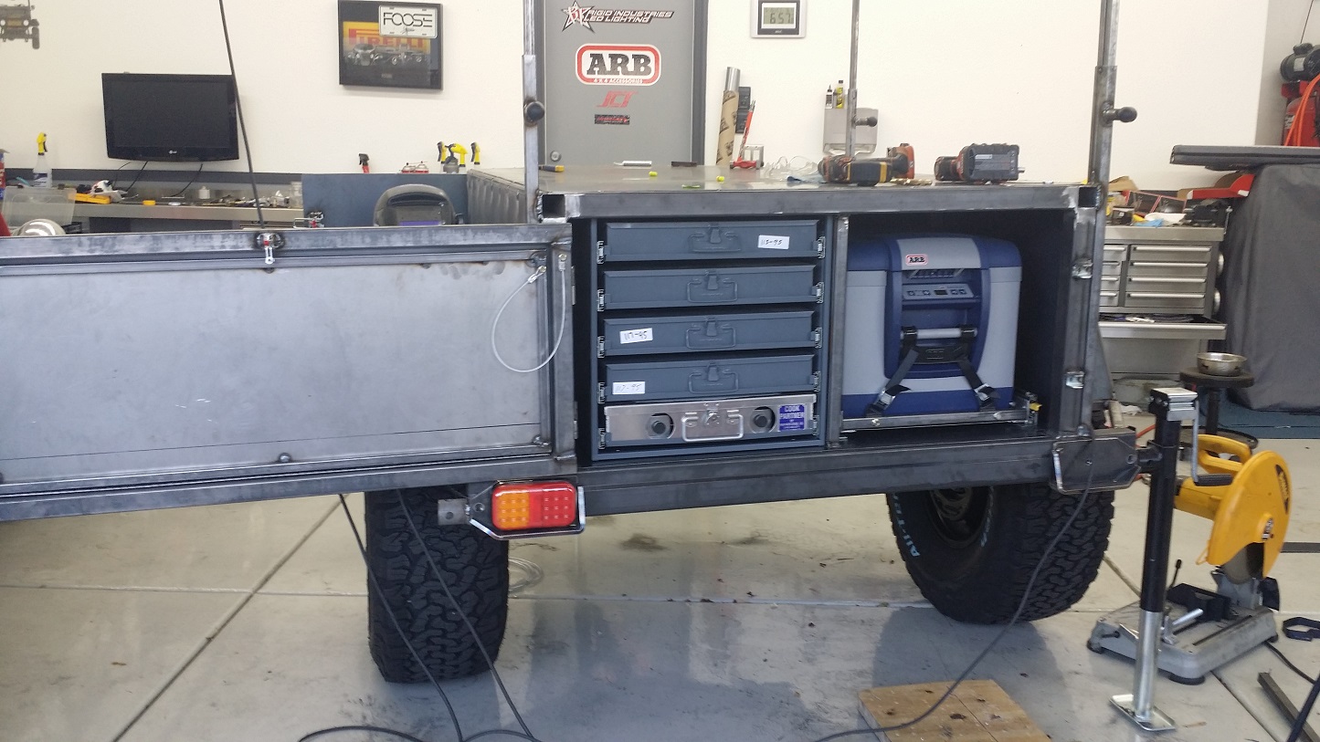

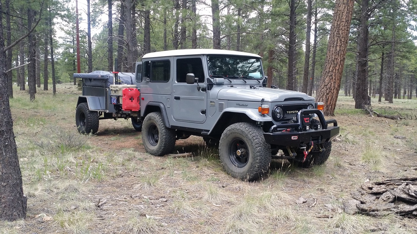

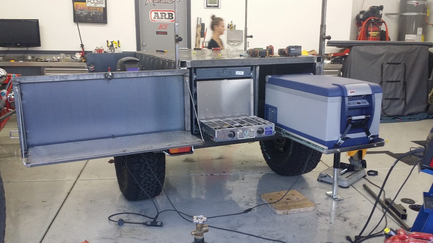

This last weekend was a big milestone for my 40! It was the first time we were actually able to take it out camping! We had always taken it on day trips, but nothing really more than an hour away. With the trailer now usable (but not complete) we were able to load up a couple day's worth of supplies and go!
It was a huge time crunch though, as I was trying to get everything ready for Overland Expo West. I had about 3 weeks of stuff to do in 4 evenings. I got it inspected and registered at 9am the morning we were leaving town!
Fridge out, table down, stove extended!
Inspection station at Henderson DMV
Getting its VIN etched!
Hurry back home, load everything up, and leave town by noon to get to Flagstaff by 4!!!
We arrived in Flagstaff right at 4PM without any issues! I was so relieved after the long week, and I was extremely excited to park and set everything up!
We had a great time at OEW! Met some awesome people, saw awesome vehicles and products, and of course spent some $$$ on new gear! It was a great weekend and the hard work on the trailer paid off! Out of all the extremely expensive and nice trailers I saw there, I didn't see any I'd rather have. I like the size, look, and functionality of mine, and so far, I wouldn't change anything about it.
Back at home after an awesome weekend-
I can't describe how satisfying it was using everything I had been daydreaming about for the last 6 years... (dual batteries, auxiliary lighting, air compressor, auxiliary USB charging areas, the cooler(s), etc). All of the features I packed into the 40 were used, as well as everything I wanted out of the trailer.
Rebuilding a vehicle and building a trailer from scratch and being able to use them in harmony has been one of the more rewarding things I've done!
Really great trailer! Super stout, must weigh a ton. Are those Durham drawers? I have a bunch I use in my shop, really sturdy. No issues rattling out of their slider trays?
The trailer weighs about 1,500 lbs fully loaded with 18g of water, 4g of fuel, tools, tent, awnings, etc. Yes, they're Durham drawers. They are amazing for the price! They haven't rattled out, there really isn't anywhere for them to go! Durham actually makes the same rack for automotive use, so I wasn't too worried about using these!

Looks great. It's nice that your actually using it for what you made it for. Some people build awesome rigs, then are afraid to actually use them.
It wasn't easy... but after the first few times out I started to not care as much. It's great seeing it out in the wilderness!
