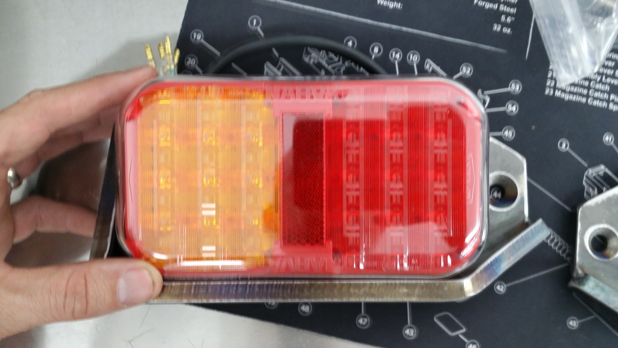

Dave @lcwizard was kind enough to make me some custom tail light guards that were the exact same design as the guards on my 40, just a couple inches shorter for my trailer lights. They came out perfect! Thanks Dave!

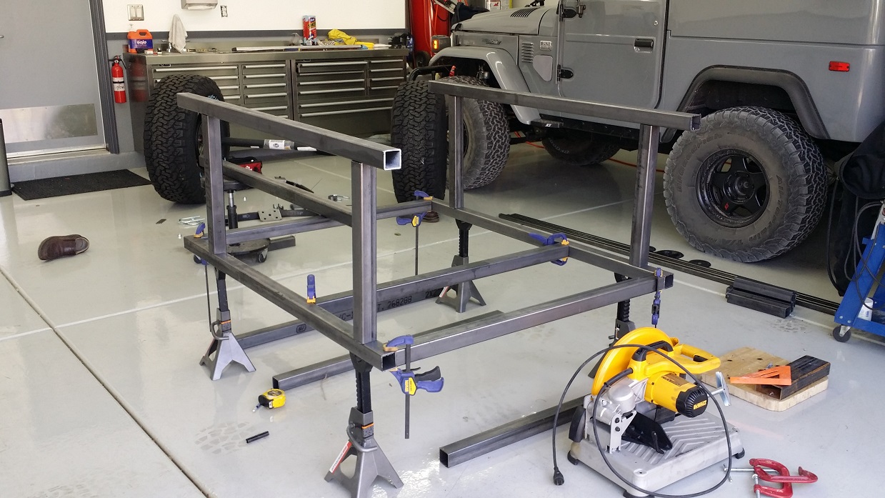

Cutting and measuring-

Planning/layout-

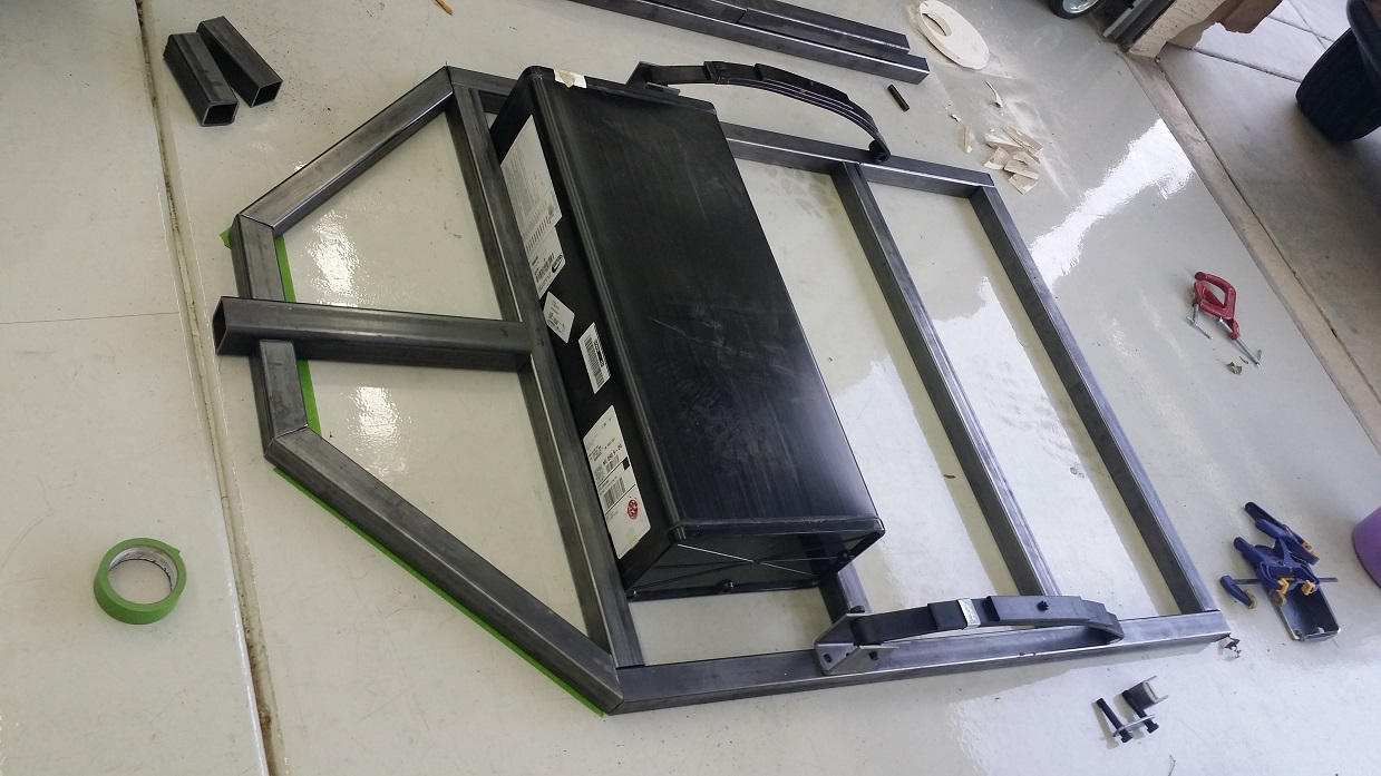

Water tank placement-

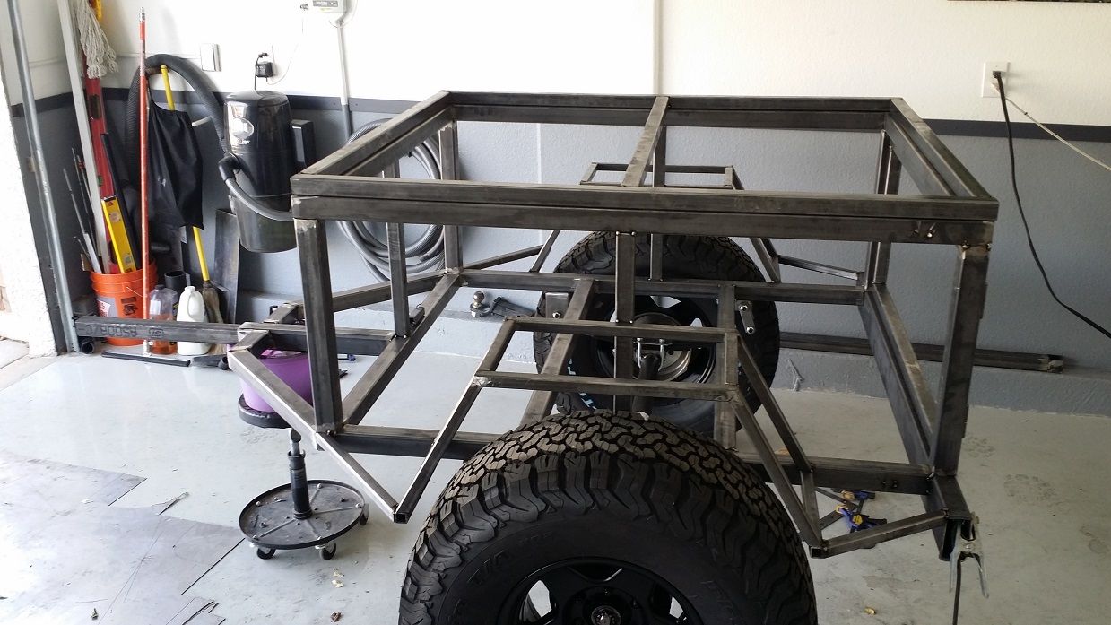

Tacking everything together-

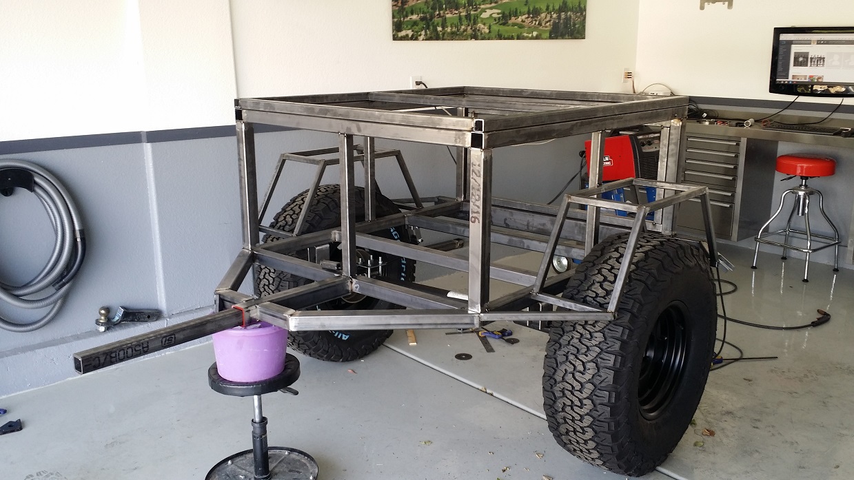

Rolling trailer! (kind of)-

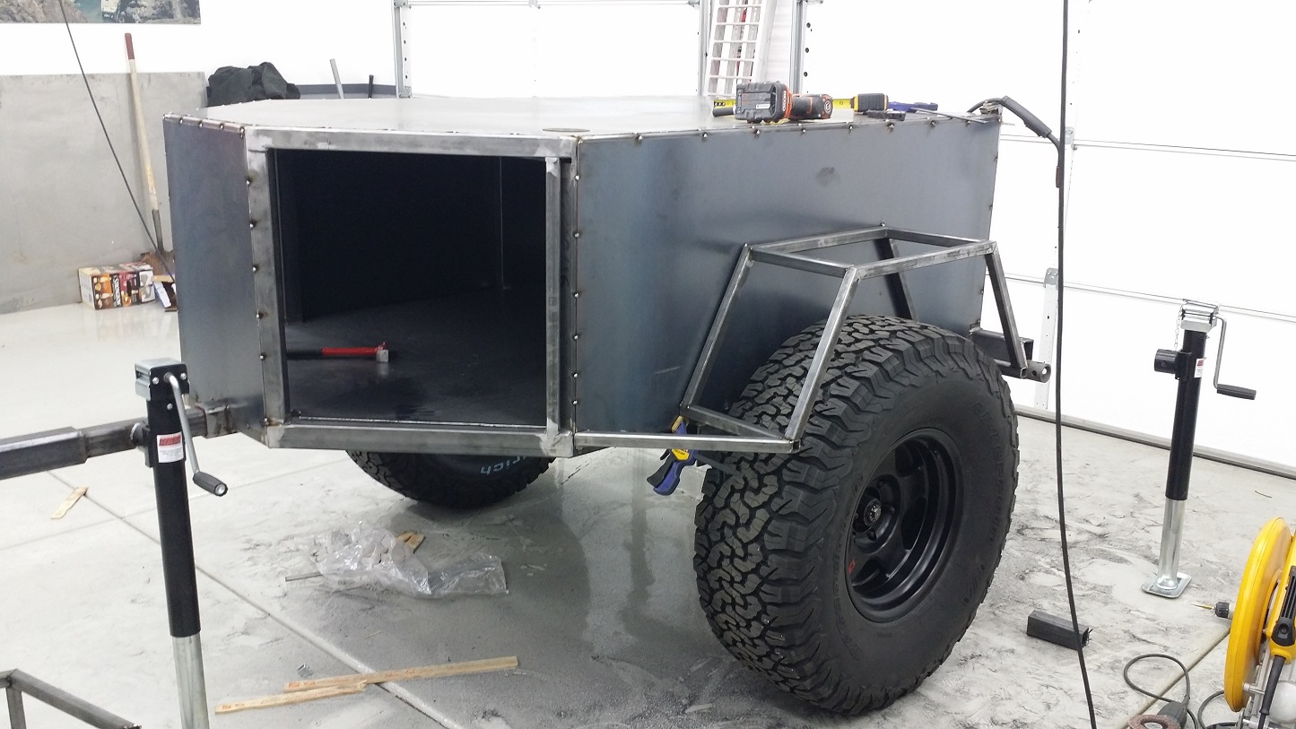

Skinning the trailer with 14g rolled steel-
Here is the hole under the front part of the box to run the pin through for the removable tongue-
Maiden voyage!
