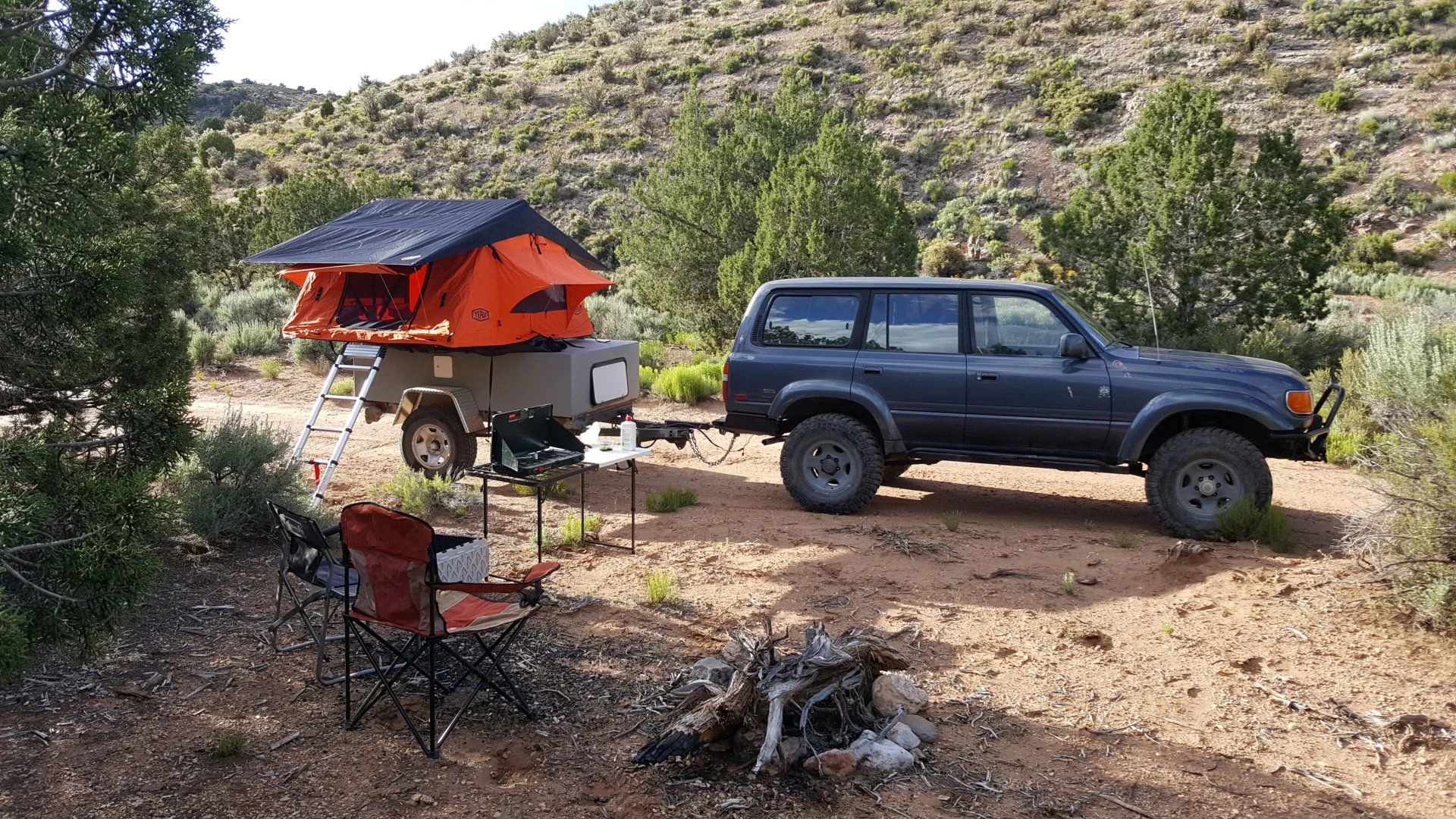

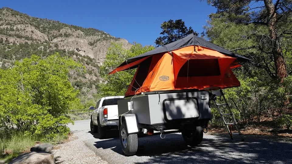

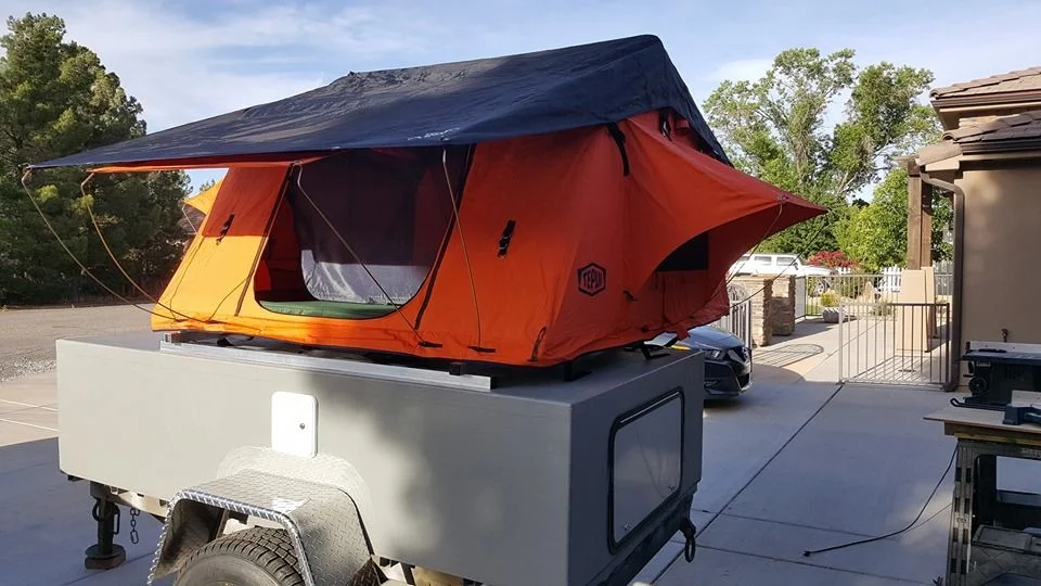

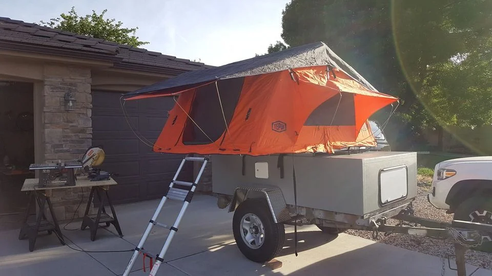

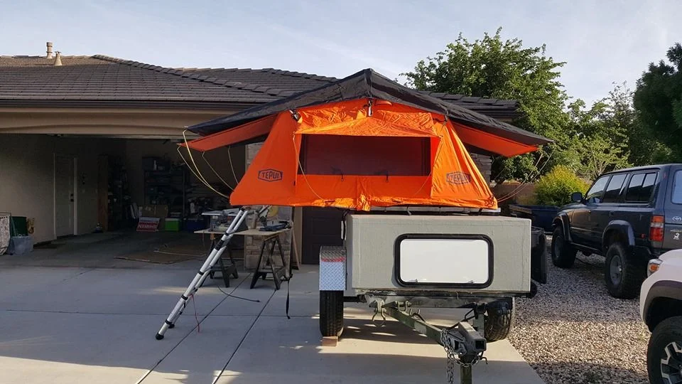

M101 frame, new 3500 lb axle, 32" tire, Tacoma rims, 56"x 96" box 4 man Tent, pintle/lunette. Will have outdoor kitchen & shower. Room for up to 35" tires (can use spare off fzj80)
So what's in the box?

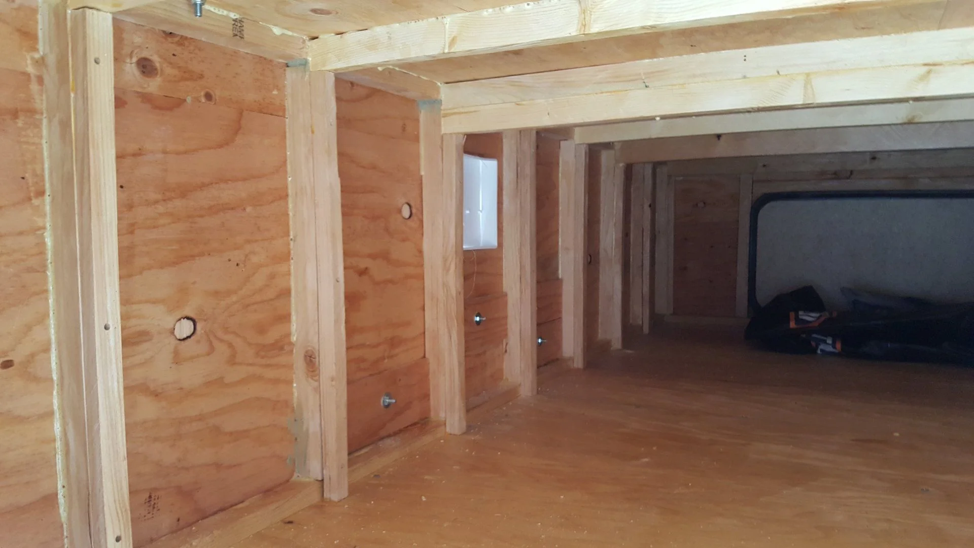

More interesting to me, how did you build the box, what construction technique? Looks like it might be fibreglas over foam. If so, got any build pics?
Not much yet, there will be a water tank, pump and battery over the axle. just camp gear storage front and rear. I'm working on a small stove/sink combo to store underneath and that will clip on the side with quick connect propane and water.
