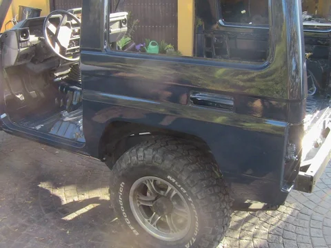

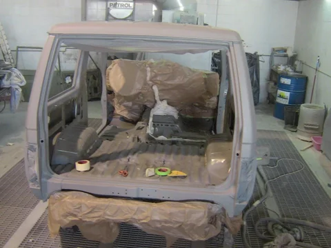

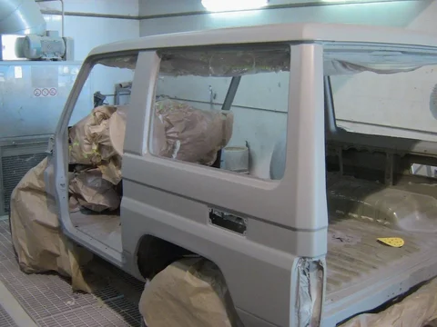

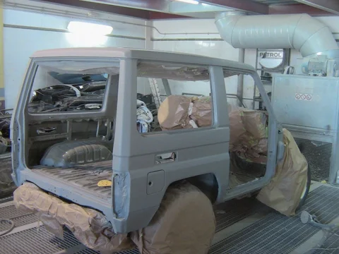

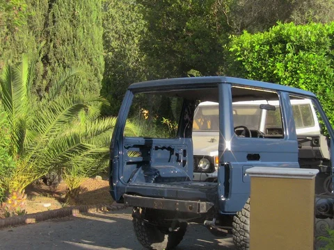

Here are some pictures for the bj70 that i bought as company for my bj73,the roof needs some attention so more pictures of the rustauration later on;View attachment 932131
