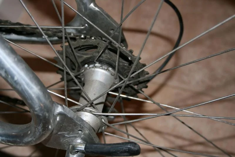

I need some advice from those who are in the know about the latest MTB equipment. Here's my MTB that I bought in 1993. At the time, to me, it was the shiznit. I put a lot of miles on this bike up until about 1998, just after I got married. The last big ride I did was a three day ride from Orlando to Miami, about 350 miles (I had slicks on it, not the nobbies). Since then, I swapped the pedals, put a cushy seat on it and mostly configured it for neigborhood rides with the kids.
Here's the deal, I turn 40 this year and I'm in the worst shape of my life. I started a running program a couple weeks ago and have improved my diet. I've lost about 8 punds so far! I intend to complete a half marathon next January. While I train for that run, I want to also get back into riding for cross trianing purposes. I used to do some "mini" triathlons that were a lot of fun and want to do them again beginning in April.
So, I need to fix the rear hub which is shredded and I'd like to get some clipless pedals again and good shoes. Should I just go for a new rear wheel, or get a new hub and have it rebuilt? And, please give me some recommendations for good pedals and shoes.

You'll need new spokes with a new hub, and you'll need a new freehub if that one isn't compatible. It'd probably be cheaper and quicker to just get a new wheel. Check bike shops for takeoffs people didn't want on their new bike, those are usually low/medium-end competition quality.
If you're not a mechanic, you'd benefit from a professional tune-up, that usually comes with some good questions and advice. Get the new wheel on first.

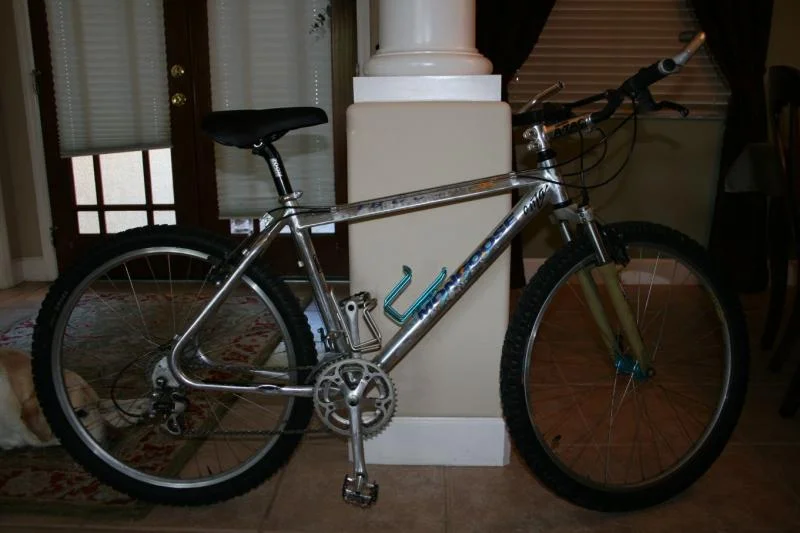

Looks like you did some mods already like the road bike crank set. As far as the latest and greatest MTB gear I would hold off. It would probably be more economical to just buy a new bike when you are ready. Shop around and test ride some bikes at your LBS until you find what works for you. And don't let them talk you into buying more bike than you need. You could easily drop a couple G's on a bike and have it sit in the garage.
As far as "Project 40" goes keep it up man!!!! Run Run Run... Get a good pair of shoes and a dog. Good luck!!
It's an MTB crankset, I just removed the small chainring. Never used it.
Thanks for the encouragement. Got the shoes and the dog, behind the rear wheel in the first pic. Best dog in the world!
If you opt for a new wheel, you'll have to get one that matches your current cassette--what is it--6 or 7 speed? If so, you would have to get another wheel that takes that size of cassette--most decent wheels these days run 8-9 speed cassette hub bodies. You might be able to run the old cassette with a spacer or something, not sure. Talk to a good LBS about your options--take the bike with you so they can see it.
Good luck with Project 40!
What is wrong with the rear hub, assuming you have a hub? If it is just the spokes, you can simply take the cassette apart, and replace what's broken? Or probably more easier just to replace the cassette all together. Or if it is the hub giving you trouble, then you might as well replace the rear wheel (not to say you can't service the hub, but it is hardly justified especially the low end wheel, because a new hub will likely cost as much as a wheel). If you are running a freewheel, then it is as simple as replace the freewheel.
As other stated, when you go shopping you want to stay with the same gearing system (IE, if you use 8 speed, get a 8 speed hub wheel or freewheel - there are plenty of 8 speed stuffs on eBay). The 9 speed hub will work if you add a special spacer inside of an 8-speed cassette.
BTW, if you are planing to replace the shifters and derailleurs soon, you might want to consider get a 9 speed...(With 10 speed on the market, they are cheaper than phased out 8 speed)...
That pic of the hub looks like some of the flange is broken off, no fixing that. It looks like a good bike for starting back into riding, and if he gets serious and buys a serious bike he'll still need a beater to go to the store or loan out.
Yes, the rear is a Ringle and it's broken. Won't be able to fix it. And it's a 7 speed cassette.

Buy a wheel they are alot cheaper than a hand build. Most wheels you find will be for a 8/9 speed cassette, a spacer will fix this problem so your 7 speed will fit. I would budget about 60$-75$ for a new one and about half that for used(buyer beware).
