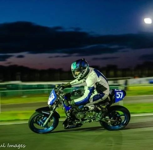

I'm a 39 year old engineer with an adult lifetime experience working on cars and motorcycles. I race a Suzuki RG125 that I custom built using 2nd hand parts from six different motorcycles.
