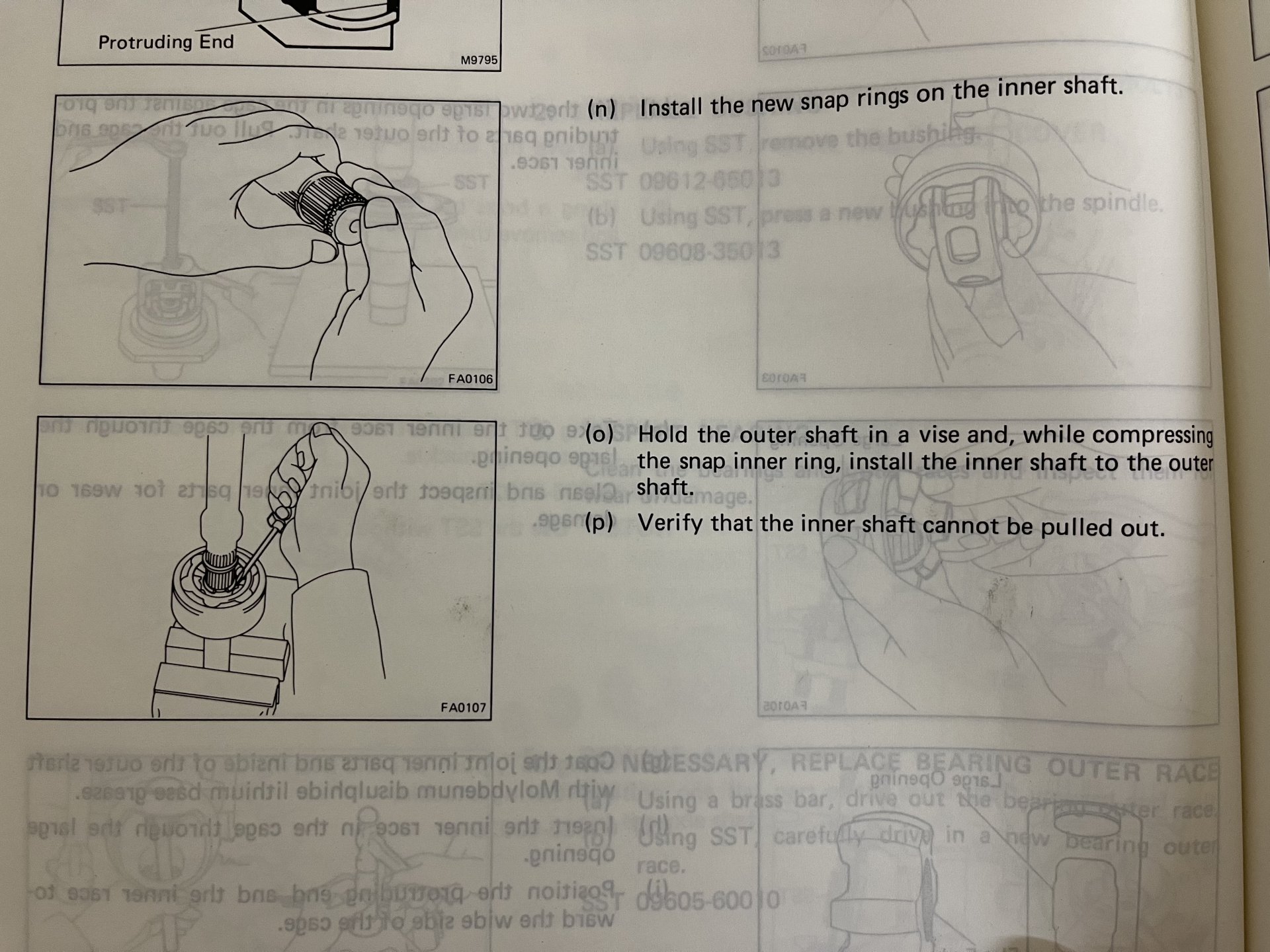

Well, you can post some info here for the next guy who does it. I’m sure there’s an easy way to do it but you probably need the right set of tools. I’ve come to the realization that the factory had very specific order of operations and tools for tasks like this so that things would run smooth in the production process. We struggle with things sometimes because we don’t have the same tools or knowledge they had at the factory. Someone at some point was likely assembling dozens of birfields daily as a quota. There’s got to be an easy and straightforward way to get it done with little or no headache.
I eventually got it together using the FSM method. Using a small screwdriver helped. It still took awhile.
I tired the hose clamp method. And the similar zip tie method. Neither worked. Maybe the birf on 70s or 80s is different, but I don’t really see how either of those methods would work on the 60. The screw hosing on the hose clamp hits the inner race before the axle is inserted enough. Same problem with the fastener-end of the zip tie. Maybe I had bulky hose clamps and zip ties.
If I doing this often, I think designing a pliers-like tool would be ideal. Although maybe a tack weld on the other end of the axle is the smart move. Add that to the list of reasons I need to learn to weld.
