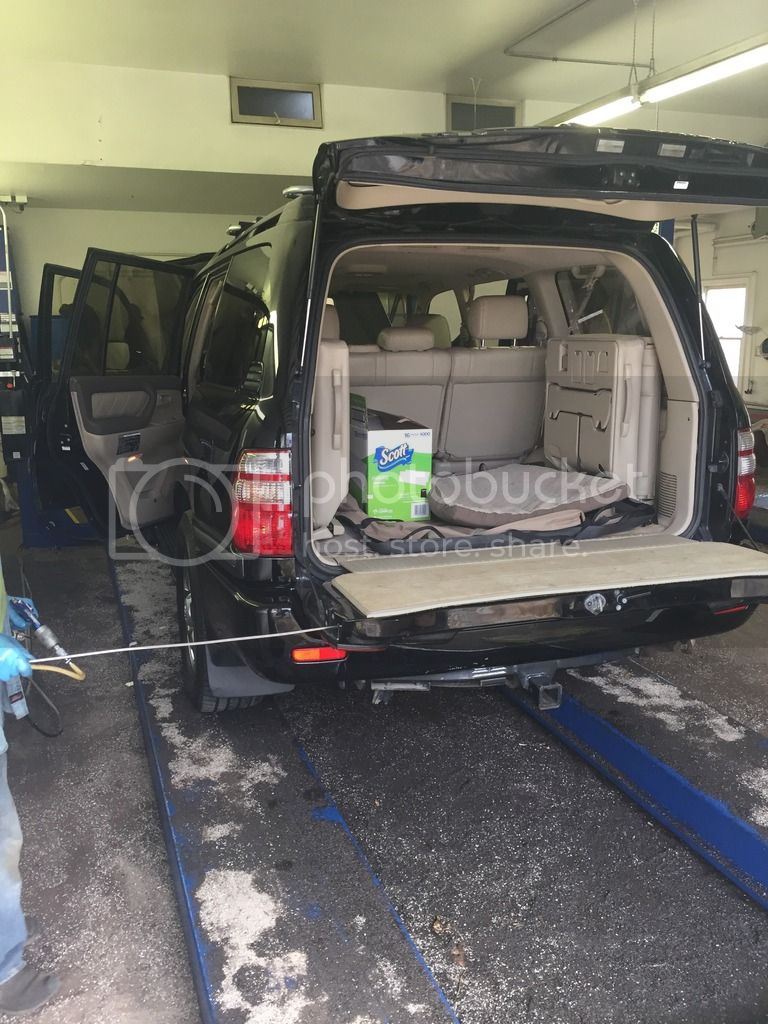

Once on the lift, Randy proceeded to drill holes in the bottom of the doors and tail gate. He asked me if it was okay, and I told him to do whatever he needed to do give me the best protection.
He then uses a long thin wand about 4 ft in length to spray the Krown inside all of the door cavities. Once he's done, he hammers the right size rubber plug into the hole.

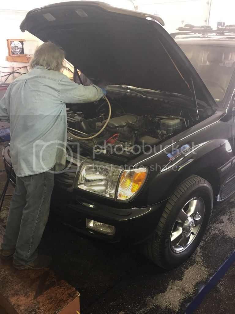

Then he switches to a smaller wand with a 45 degree bend at the top to hit areas in the engine bay and undercarriage.
Finally, he finishes with a wide spray nozzle and goes over the entire undercarriage.
He told me that Krown uses a base of corn oil. It didn't have any odor and applied in a mist. It went on clear, but seemed to turn black when in contact with surface rust. It dripped for quite a while and I'm glad to have had the 2 hour drive home to let it further seep out.
