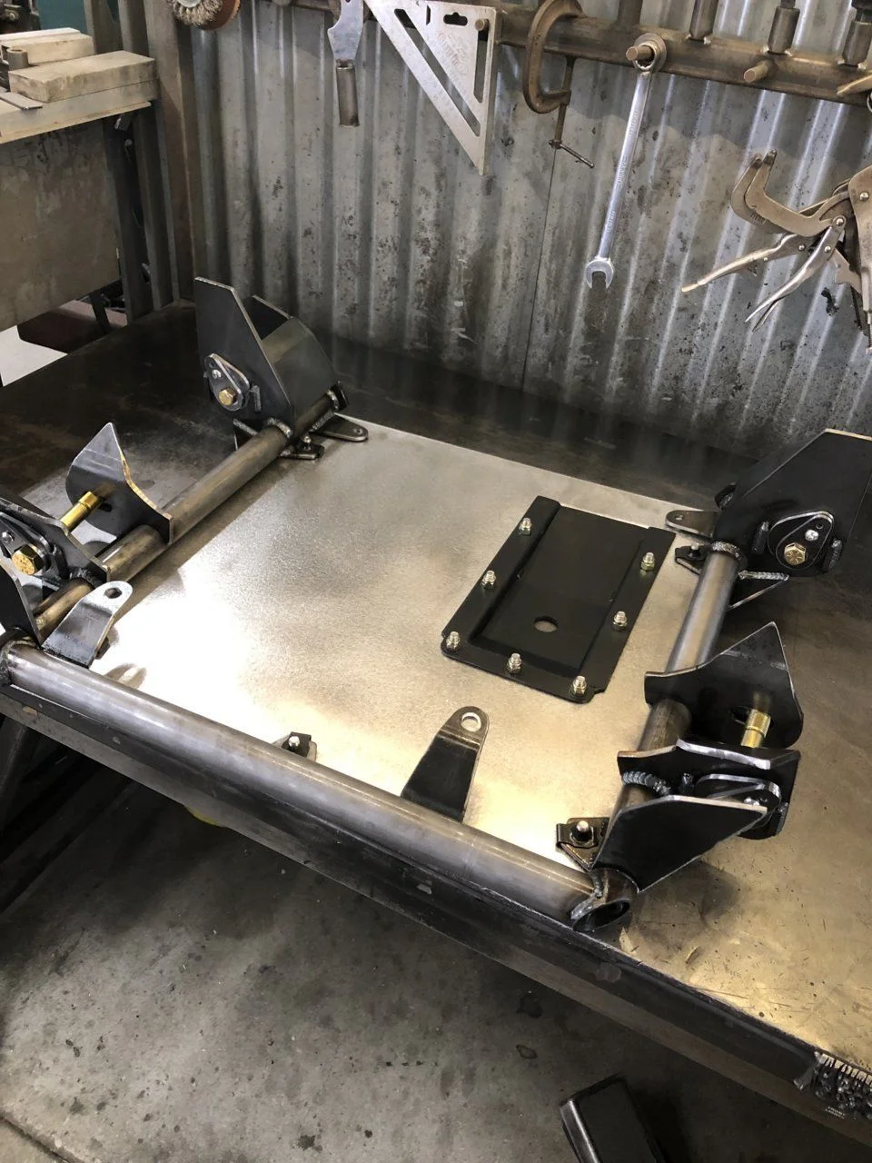

JD Fabrication Kit ,,,, Toyota IFS is going to go crazy with Long travel kits
JD fab.
All new R & D

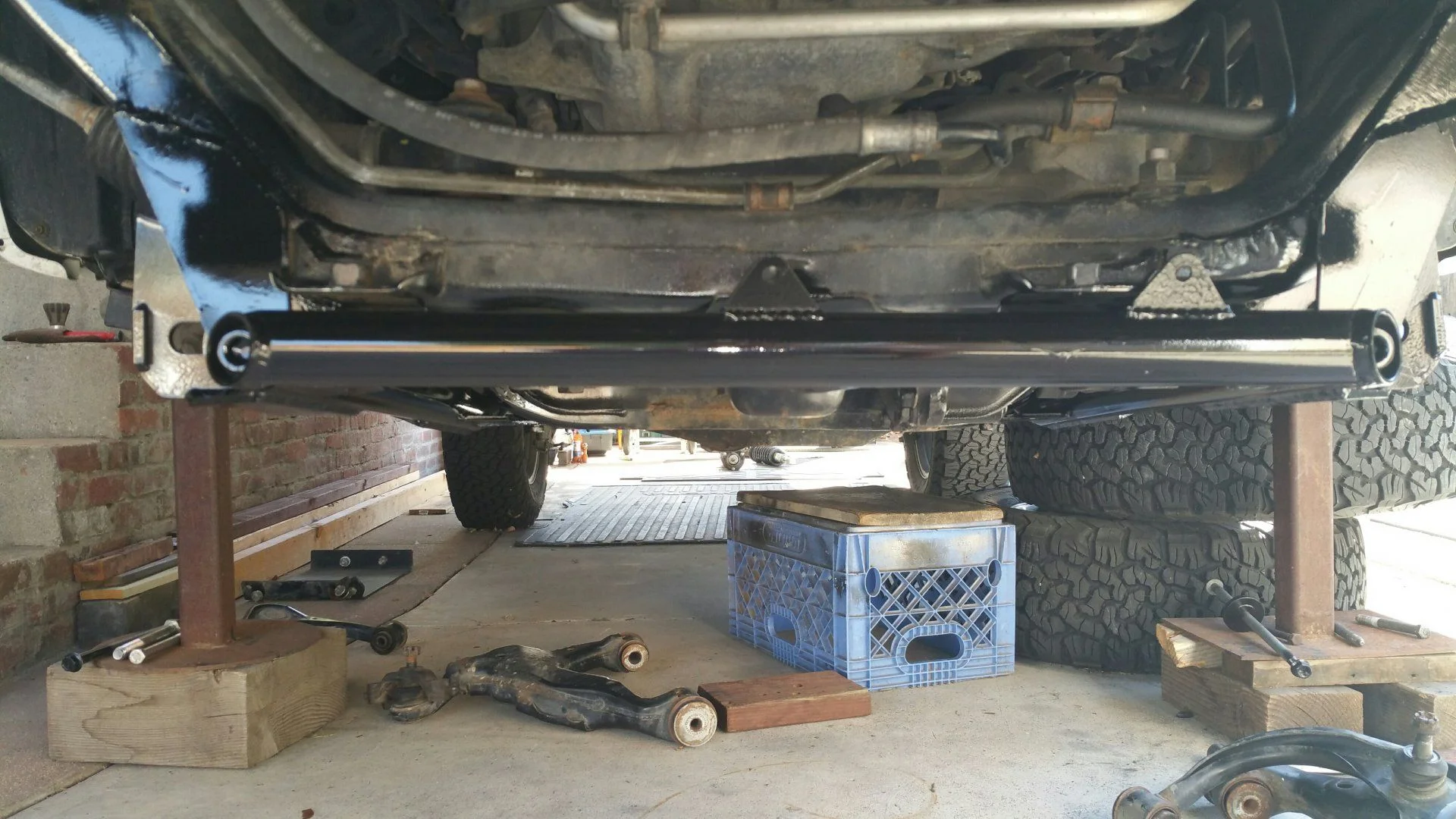

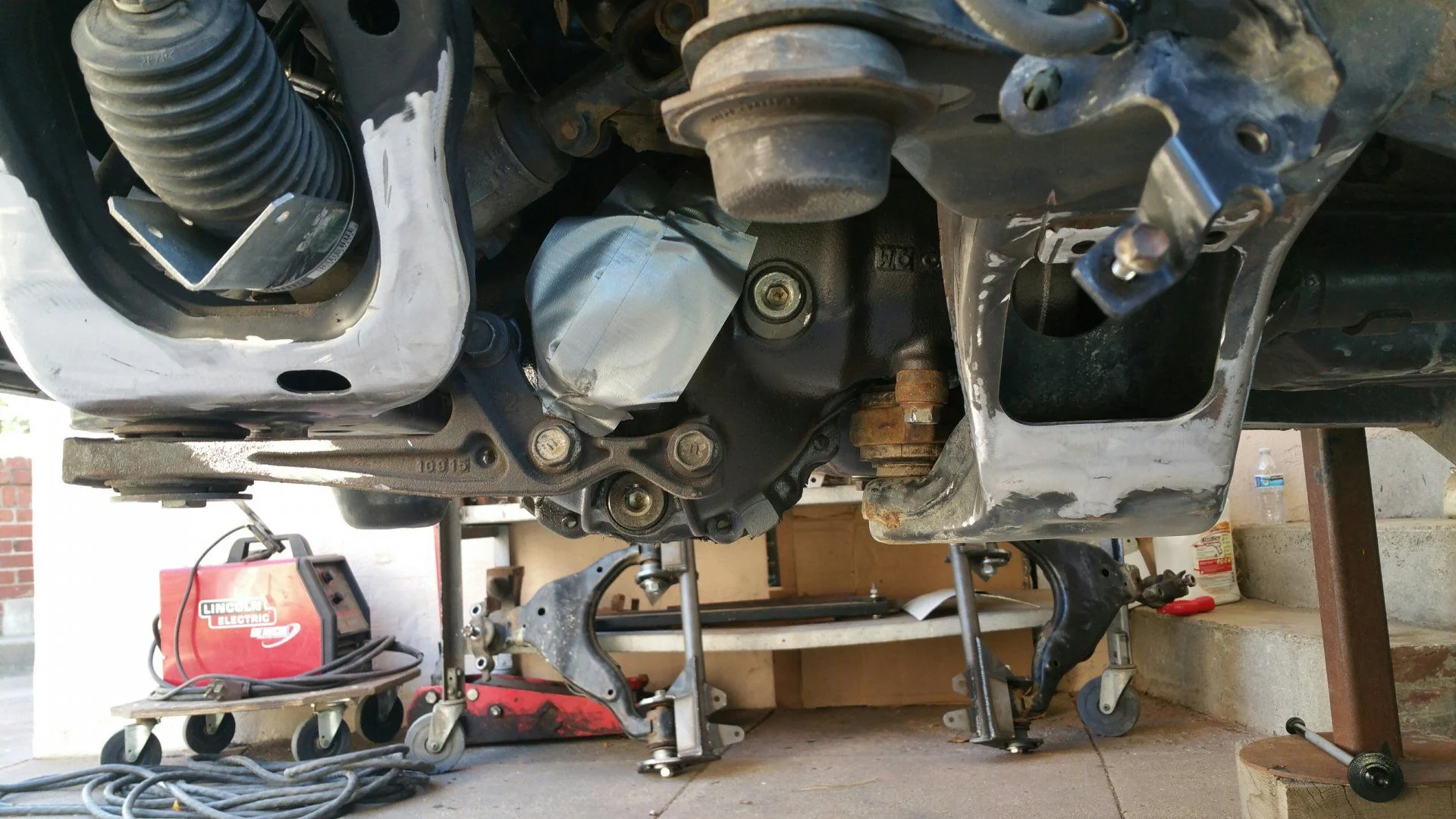

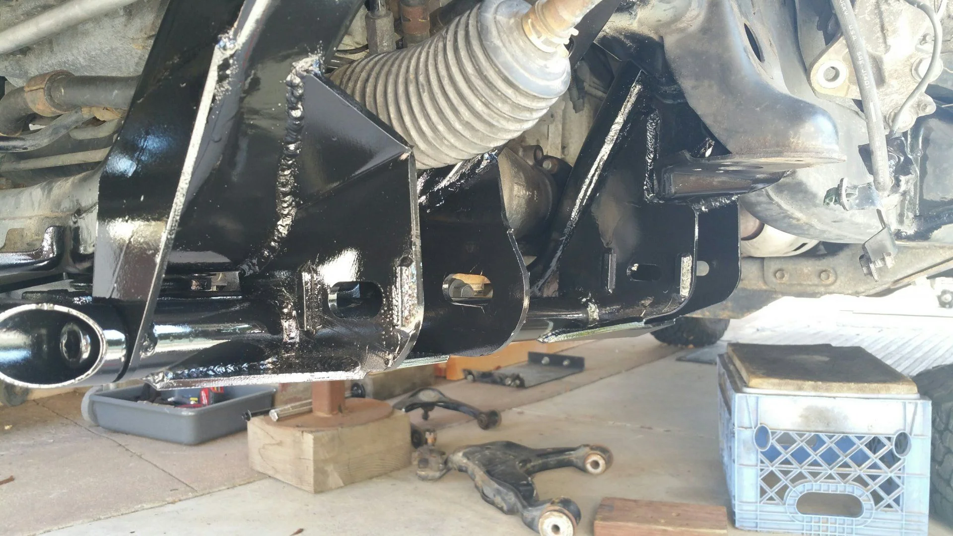

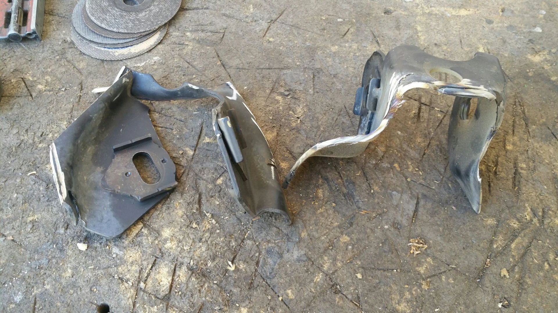

Who cuts off a good IFS mounts on a 70000 mile truck ? Me ! Doing all this just so I can fit 35" tires ,
I still gotta cut off the other side !!
Lots of noise , banged head , neighbors not happy , and a small fire , But i got one side done

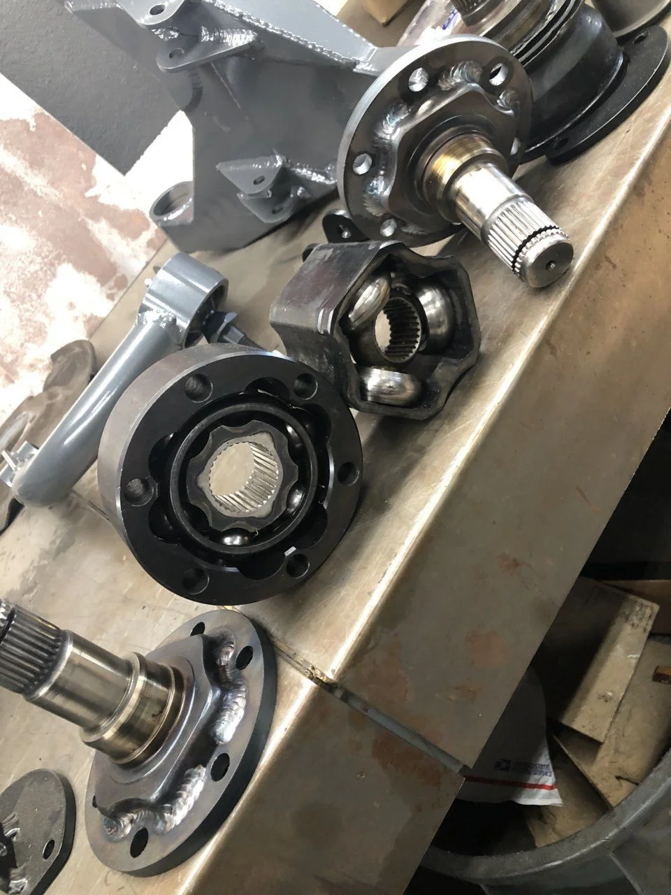

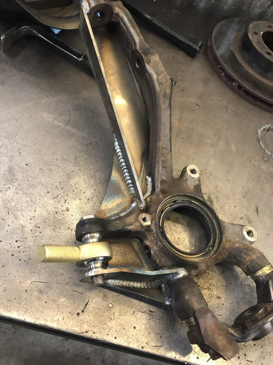

Ok update ! Try welding upside down ? My welds are not pretty , But I got good penetration , ! will be very safe !

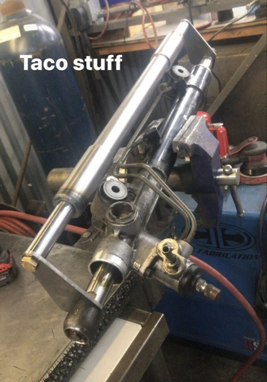

I"m not going LONG TRAVEL Just upgrading stock for more trail beef , And also will be able to run 35" tires without cutting up body sheet metal , Because of Covd 19 I"M waiting for more of my parts ??? so ?? Wait and see ? Have a Happy 4th Boys and Girls
Welded up my spindles with upgrade kit , Waiting for my King shocks , and HD axles , Rubithon ???? hope to see you there !

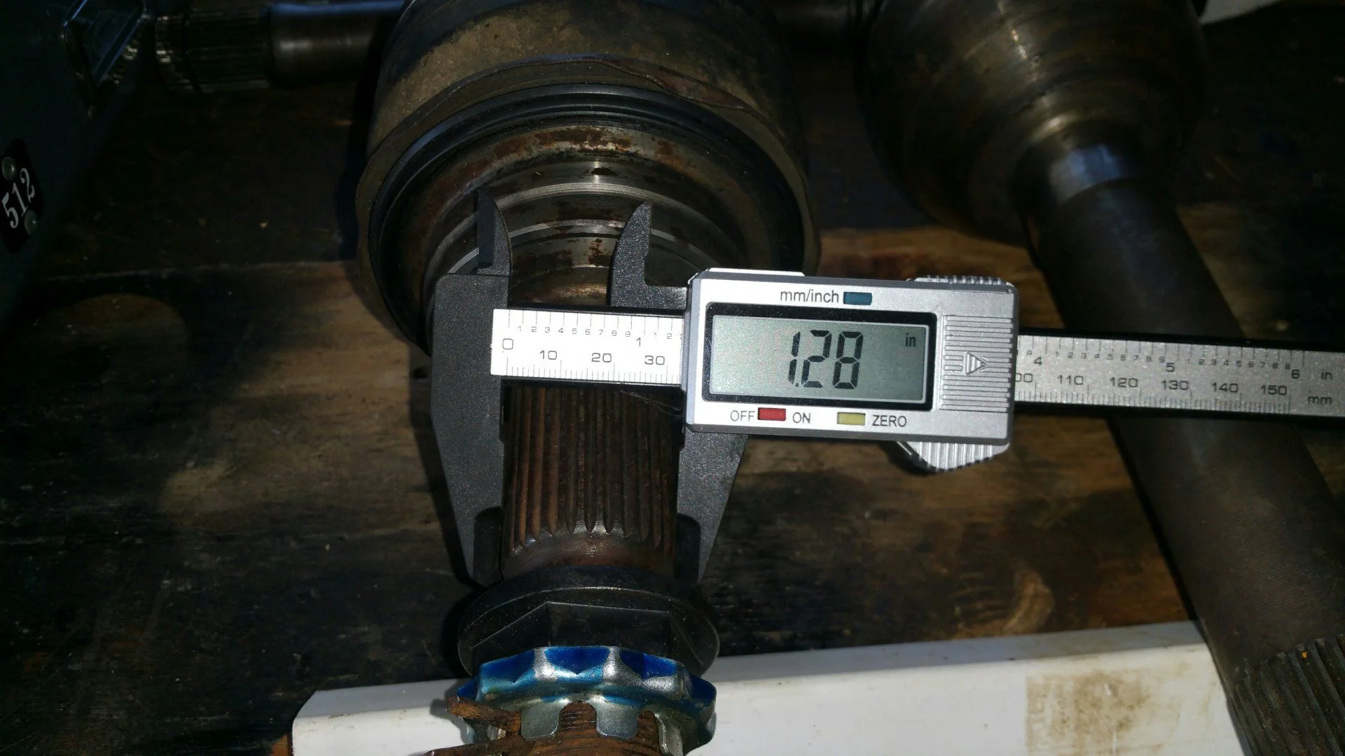

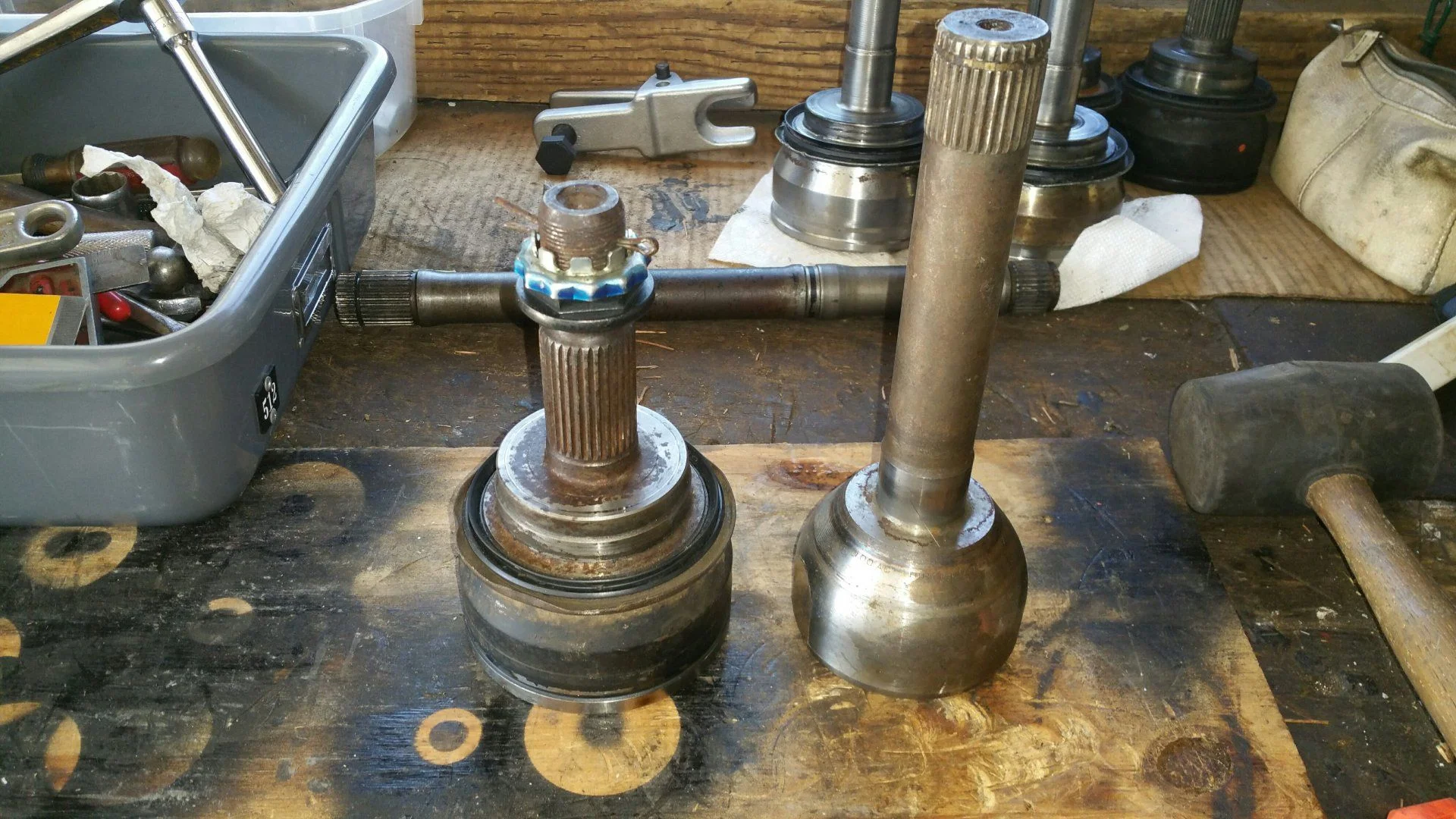

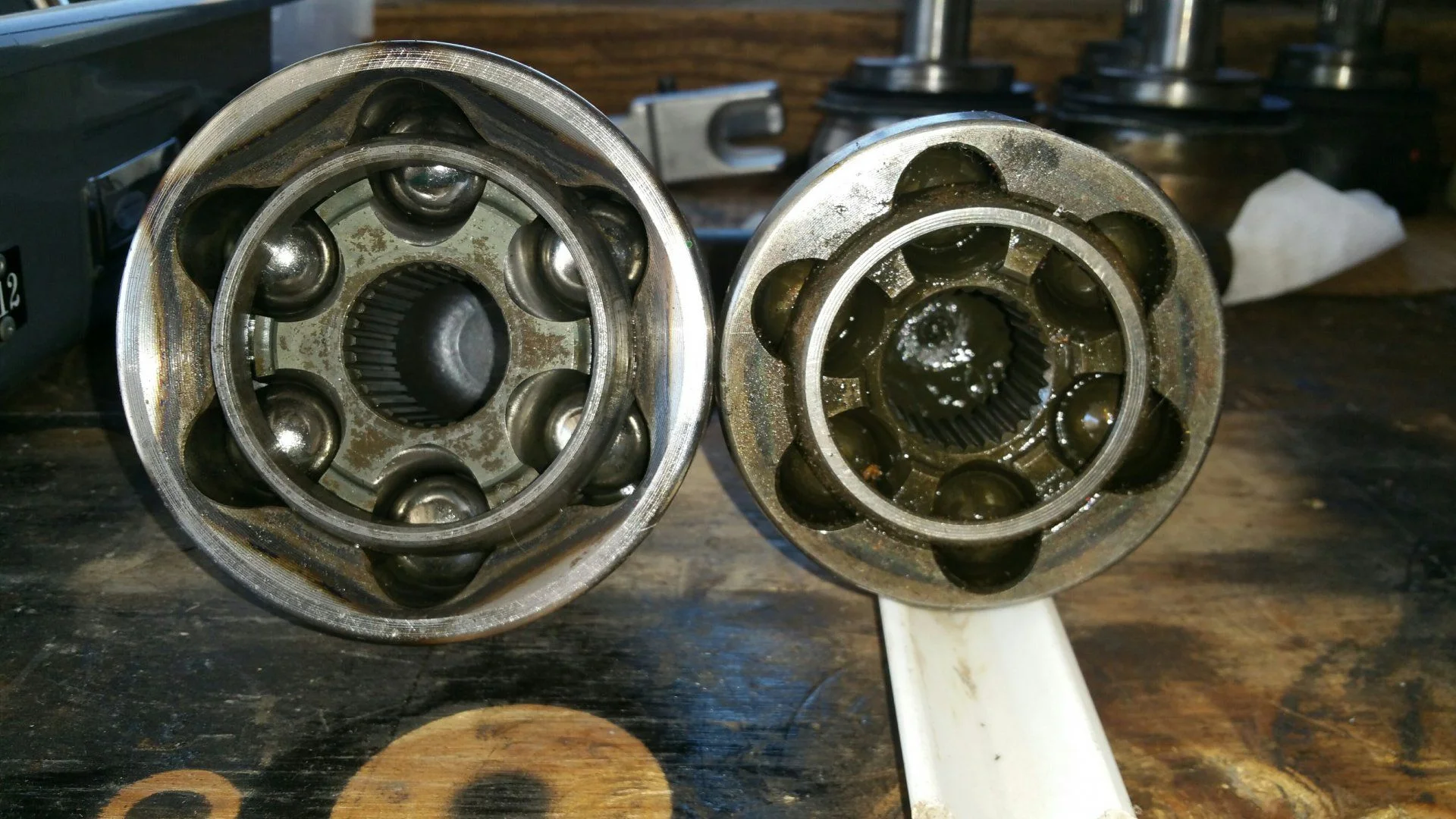

Lesson 4 today Compare a stock 1972 fj40 Birfeild to a Outter 2011 Tacoma CV ? Axle shaft is the same spline count .

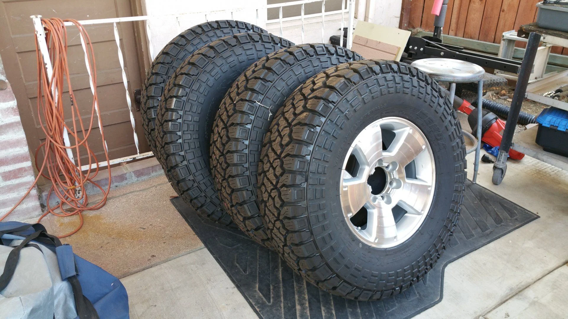

Should be all I need for 35 in tire ?
Kenda Klever R/T KR601 35/10.50R17 121R Tire

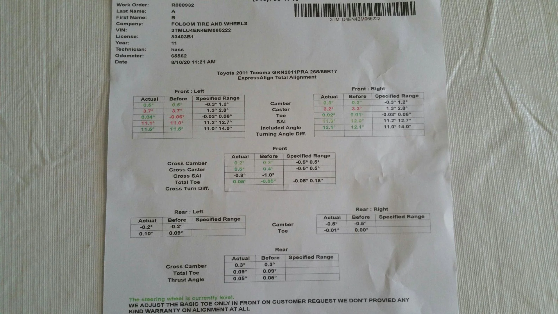

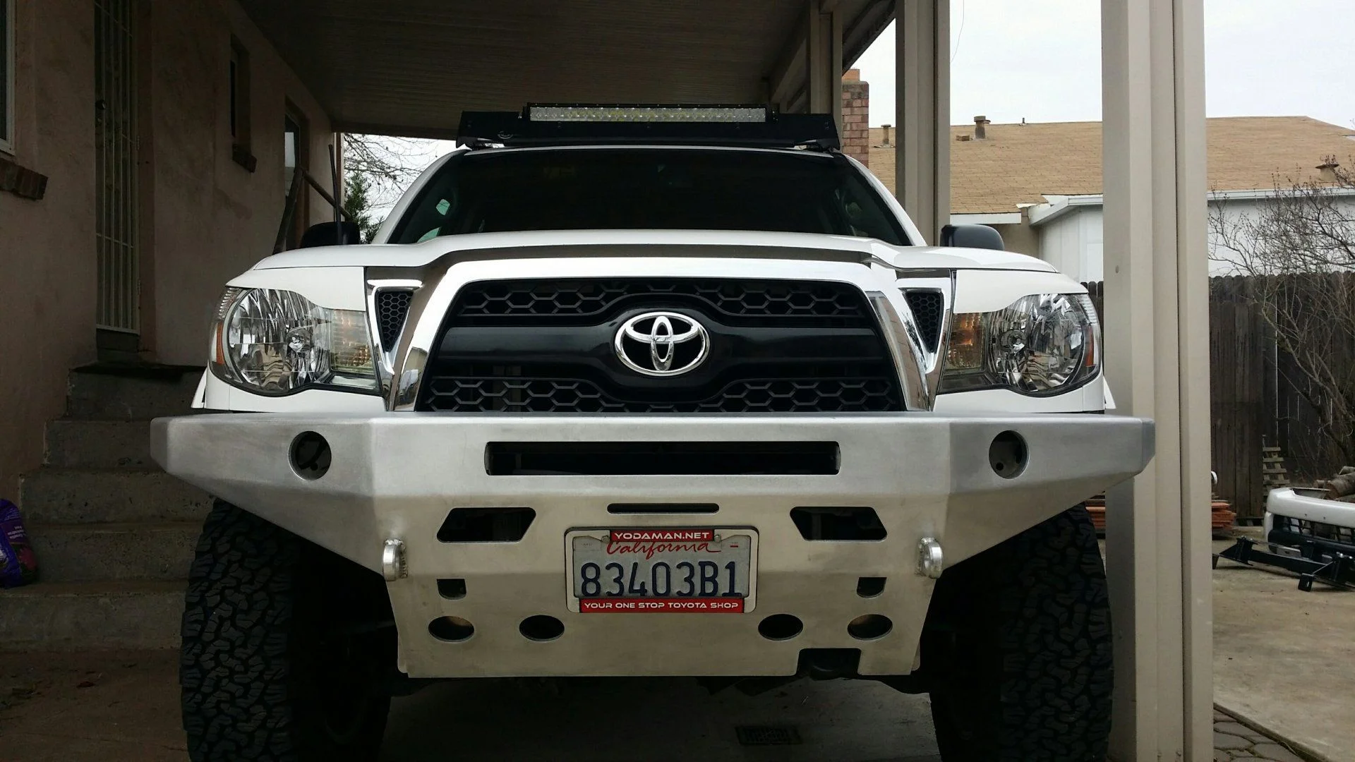

Long hot summer , Got my 300m axles , Took truck in for Alignment , First shop would not do it ??? Second shop $80.00 and it drives like new ! I was stressed over that . Back on the road now and will upgrade steering rack later , I changed front R&P to 456 so next step is rear diff 456 gears and I can put my 35" tires on . Will buy new wheels someday for now I got another set of Tacoma wheels 7.5 x 17 for $150.00 picture of truck now with 31" bfg ( tires 4 sale ) also i still need to cut my rear fenders

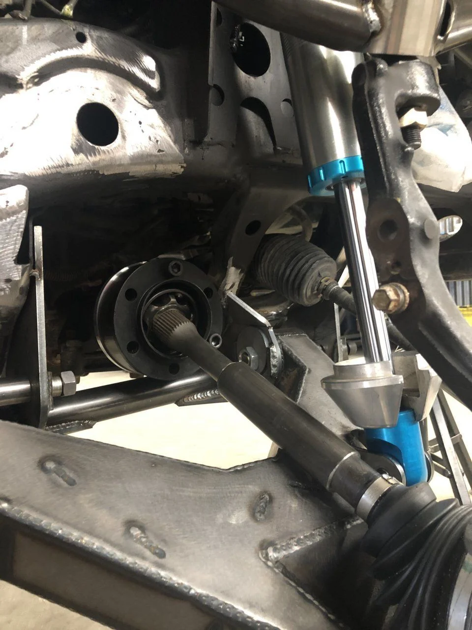

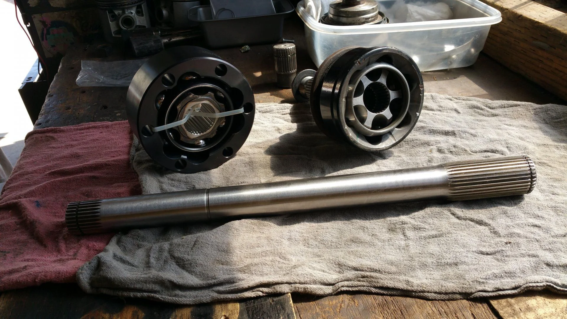

Converting to the 934 allows for a full 28 degrees of movement verses the stock 21 degrees. In addition to the added strength the 934 design is also much shorter than the OE unit thus allowing for a longer axle length which reduces the CV angle in all ranges. The increased range of safe operation angle also reduces inner axle bind which is the direct result of the outer Birfield failure.
