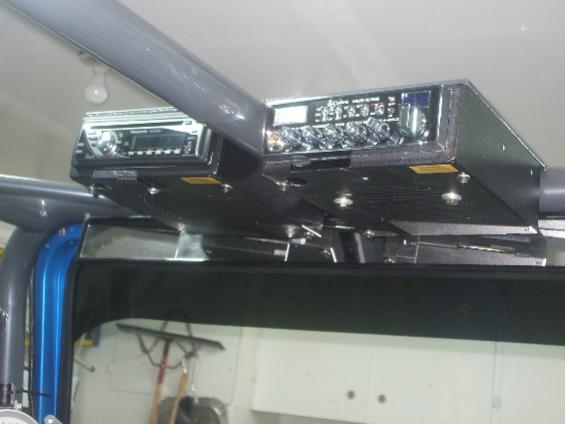

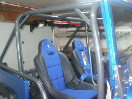

here are the pictures of the roll bar powderkoted and installed with the radio and cb mounted
Awesome job! One question though, where did you hide the wife through this build? You must be one of those "lucky ones" that has a wife that never complains! Hahahahaha. Seroiusly, that is an outstanding build! Merry Christmas....:beer:
