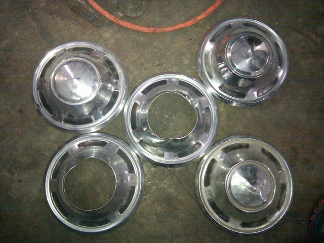

Pics to come this weekend after I get some Meguiars and de-oxidize her. I also have a set of early hub caps that I am going to put on too.

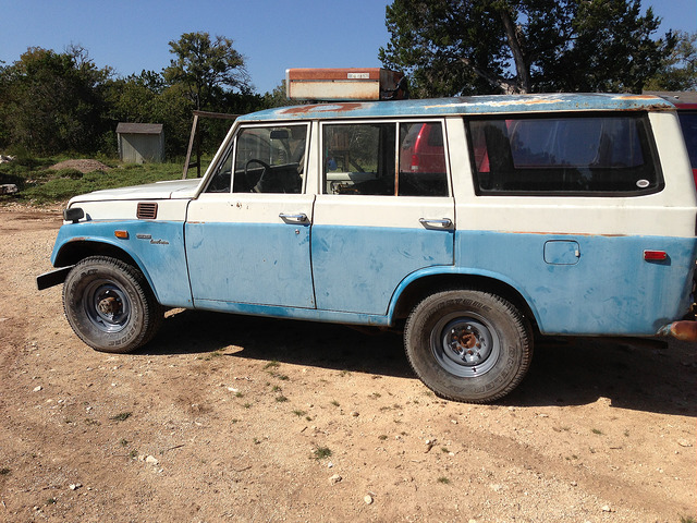

Ok, here is a pic. I did try the knob on the AC and the lowest level fan did work amazingly. I am sure it's out of freon, but was surprised it works. I will swap it out most likely though since I am almost positive it uses R12.

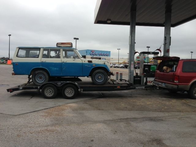

Pic of Elsie on the way to Cottonland ;-)
Tucker
Thanks for posting that Tucker. Yeah I have been trying to get her ready for SCC but I haven't had a chance take any photos yet. I am sure I'll have plenty of photo ops this weekend.
Yes Pablo, i am towing with a diesel excursion, (see sig)

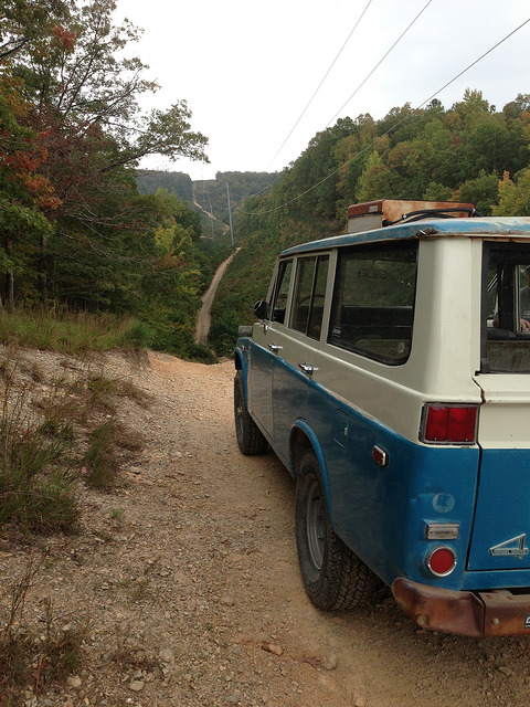

Pic from SCC yesterday. This is getting ready to embark on a more daunting trail. Overall, she did really well. I stayed on the 1s and 2s. The 3s were too tight and I didnt feel comfortable with drums. I really can appreciate disc brakes now. I will be calling Kurt next week to get seals and try to do the swap over the next month.
I did have to go into 4L a decent amount, 4H just didnt cut it. It's like it when into Overdrive though and just crawled right up.
I do still have a pinhole rad leak, you cant tell it from the ressie though. The wife has more pics on her phone and camera from today that I will post when I get back to Austin.
