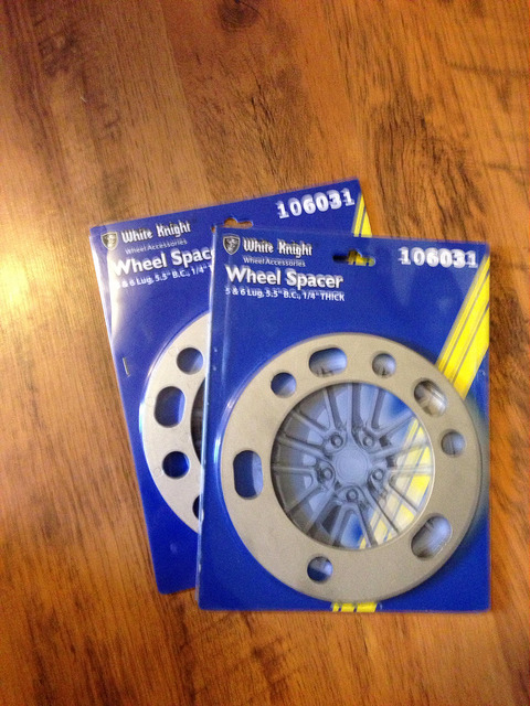

Talked to Tucker today, who asked if I was going to use disc rims. What ?!?!? A quick call to LCS and I found out that my newly powder-coated rims wont fit :bang: Tucker sent me a link in which 1/4" spacers and a smidge of grinding off the caliper will fix the issue https://forum.ih8mud.com/40-55-series-tech/598429-riveted-steelies-disc-brakes.html BIG thanks to Tucker for alerting me to this. I wasnt aware of riveted rims vs disc rims- ya learn something every day!
I will drop these off at LandCruiser Specialist tomorrow along with the 2 caliper bolts I forgot. So hopefully, tomorrow I will be driving her back home.
Spacers from PepBoys
I would be VERY careful with those spacers.
I went from this:
To this:
In about 500 meters!
I don't recommend them. IF you're dead set on using them, make sure your wheel studs are longer and torqued down well. Remember, now that you're extending the bolt out further, the shear amount is lower.
Just trying to save you my same embarrassment.
Thanks for your concern. I consulted with numerous CruiserHeads who gave the OK on the spacers. Personally I dont care for the idea, but I will use them for awhile and torque them down regularly. Until I find another set of rims I like anyway.
Snip.
Good lookin' out tho.

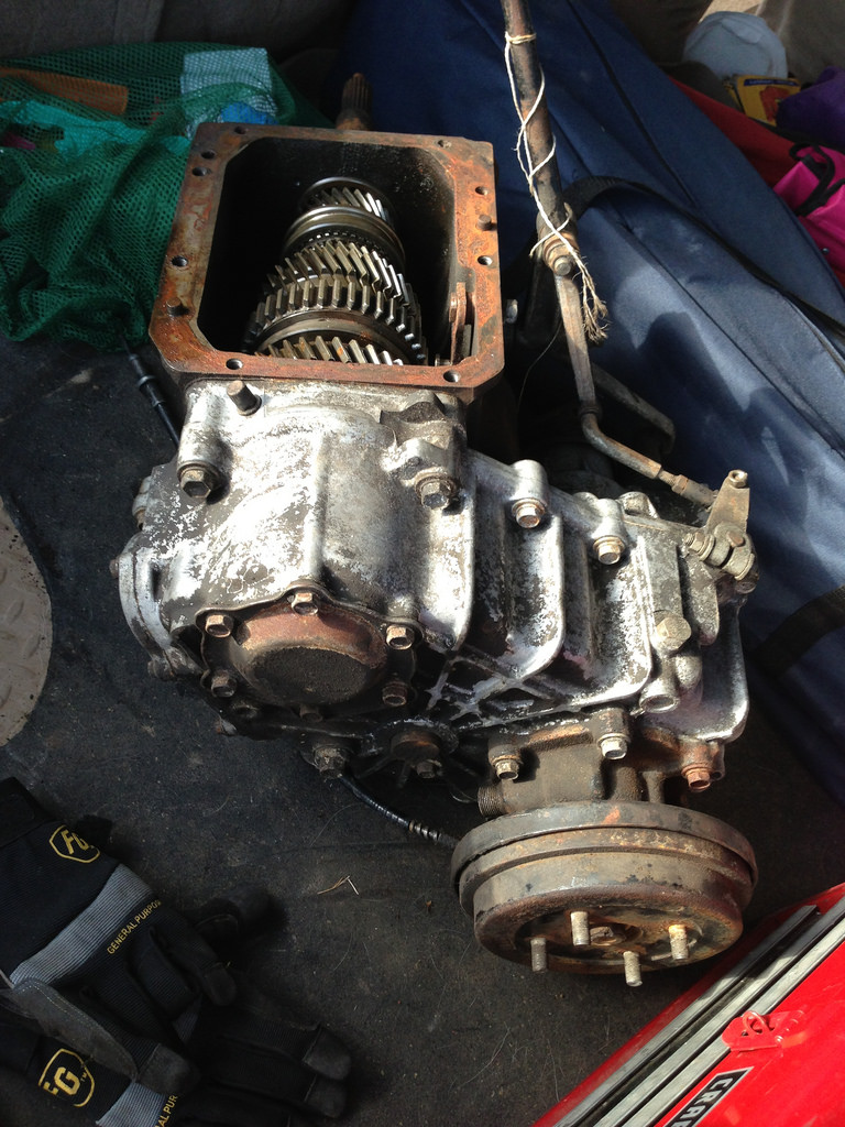

On a different note, I managed to procure a non-US spec BJ42 split tcase with an ebrake on it, so this will be used when I do the OM617 swap.

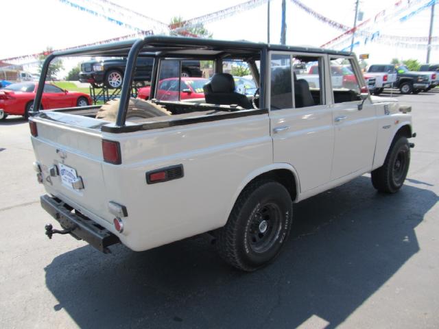

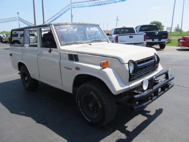

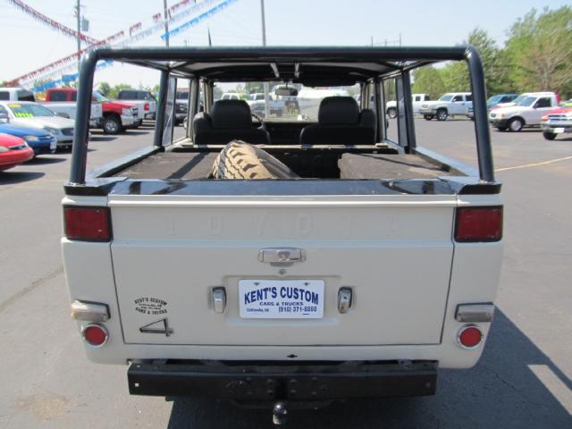

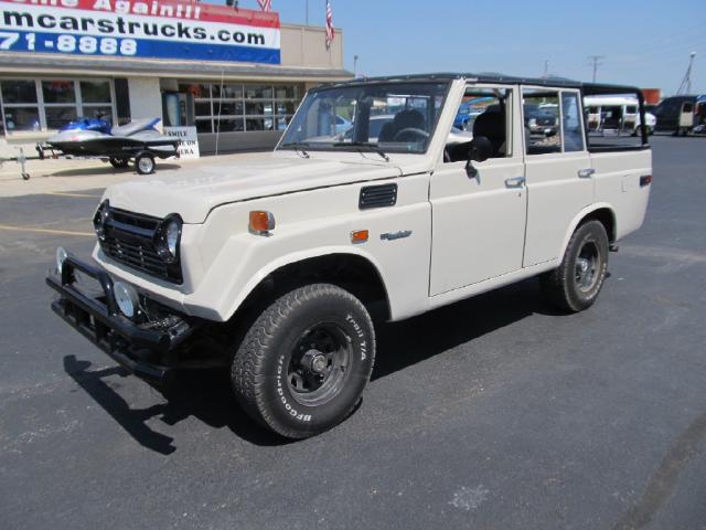

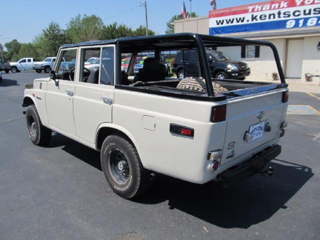

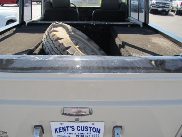

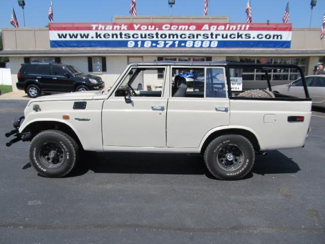

Davegonz found this pig for sale. This is almost exactly what I envision. I would extend the bikini top and make it a full soft top, removing the 3rd row windows. ANd try to keep the D-pillars so the window still function. Thoughts? thanks dave!
Jason,
Don't buy that Pig, in the event you or anyone else is considering, before having it inspected.
I've seen it has the typical port installed rust, filler, wiring debacle, and isn't worth the $8k they were asking two years ago when I went and checked it out on the lot.
Cool concept though. That's similar to what I envision my next, wheeling Pig to look like, but bobbed.
let me clarify Chris, I am NOT buying that. I actually dont care for that pig for some reason.
Given the state of my roof, I have pretty-well convinced myself that cutting off the top and putting in a cage is the path I am going down. The above pics were for reference only as this is the closest one that I have seen that shows the full cage.
