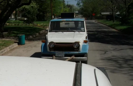

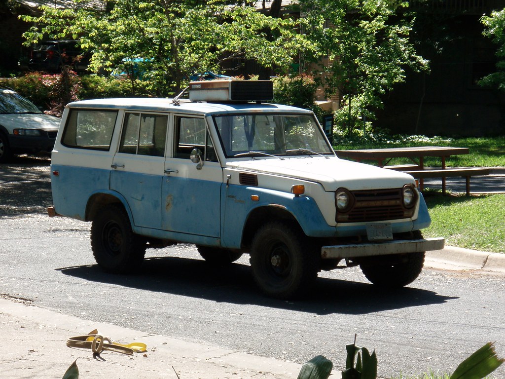

Her name is Elsie and she is a 1972 model. A big thanks to 77mustard40 for telling me about this (it's his neighbor 2 doors down, and this was a total word of mouth sale).
I transferred it over today with the PO at the DMV and will go pick it up Saturday. He is the original owner and man, did that title look ancient! I didnt know what they would look like. It needs some TLC, but it is 95% rust free, and more importantly, rust free where it counts. 49K on it and I am pretty sure it's original mileage as he didnt drive it much.
I am not parting this one, it's too nice and too rare. It needs some engine work, some tires and I will put some discs on the front and ensure the brake system works good. Then the plan is to drive it and fix her up over time.
It has what I believe is an aftermarket AC on top. It doesn't work so I will probably replace that with a more aerodynamic unit. I need cold air throughout the entire truck, not just the front and I have heard that Vintage Air wont cut it.
The bottom photo shows what she looked like when I saw her last Saturday. The deeper blue is from some elbow grease and rubbing compound. I will put a buffer to it and give her more shine.
Any recommendations are welcome. Here she is.
you may wanna fix that tire;p, also, front knuckle swap with disk brake truck. Good starting point. I have seen that pig around, the condenser gave it away. Plans?

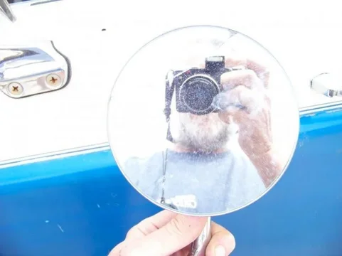

Thanks Pighead for the pic and pull, she has two mirrors. MUD folks are great.

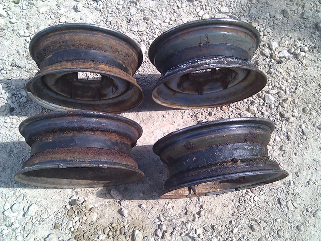

Next up is getting the rims blasted and powdercoated so I can get some good rubber on there. I will be dropping them off with baktash of EMSPowered later this week for them to do some magic. You can see 40 years of love on them. Actually, they are not as bad as I expected, and are very solid. Question- what is the rubber belt on the inside of the rims?
that was to keep the rivets from nicking the innertubes

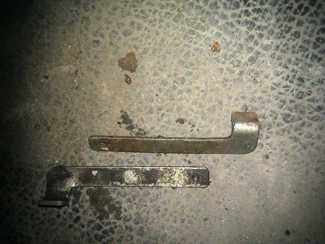

I am looking into why my rear window wont go down. No noise when I turn the key, so I am suspecting the safety switch. The window is up, how can I bypass this? If it needs to be replaced, I need to get the tailgate open first :)
remove the inner panel. on the bar that the glass sits in (and inconveniently located behind the two uprights), you'll just barely feel two small "L" tabs sticking out (one on each side), tap them out with a screwdriver and you can then slide the glass and channel down into the tailgate
Wow, not the easiest to get to as I lay on my back looking up at the tabs. I was abel to remove the tabs but the window didnt come down. Do I have to manually /forcibly "massage" the regulator to bring it down?
L tabs removed
Looking towards the DS where the L tabs were removed from, the smaller channel above the C-channel
oops, forgot to tell ya to slide the little lower channels off (pull down slightly to clear where the tabs interlocked and slide towards the center to clear a pin that they fit onto
sorry, working a 17 hour shift...little loopy right now :o
I think that was officially the most rust I've ever had to remove off of wheels to prep for powder coating. The end result came out pretty good. We did a base coat of single stage chrome with a top coat of 95% gloss clear. End result is a nice gray with a deep gloss.
Wow! Spectacular result. :cheers:
