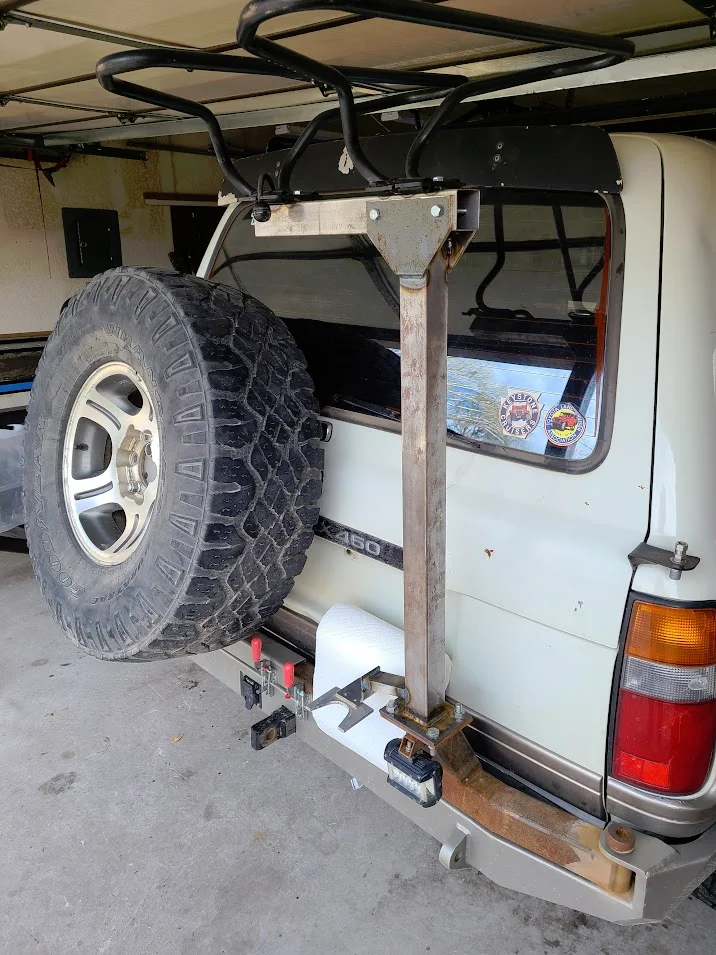

So, it's mostly custom, but the baskets that hold the wheels I stole from my 5 bike Recon rack.
Here's a picture of the rack. It's pretty much just a 2" square "T". The baskets bolt in on the top. The rear wheel slots into that little aluminum "U" near the bottom, and right now I just wrap a little strap around the tire/rack (need to put a permanently mounted rubber strap on here). I used the same basket to rear wheel slot geometry as the Recon rack. (Note, only one of the rear wheel slots is currently installed - the second one will be mirrored on the right side of the vertical tube once I get around to it). The flange at the base with 4 bolts is so I can bolt different attachments onto the swing out. Please excuse the lack of paint.
I haven't seen anywhere that sells just the wheel baskets - that's the only hard part of this whole thing. I want to put my Recon rack back together so I can sell it, so I'll probably end up building my own wheel baskets at some point.

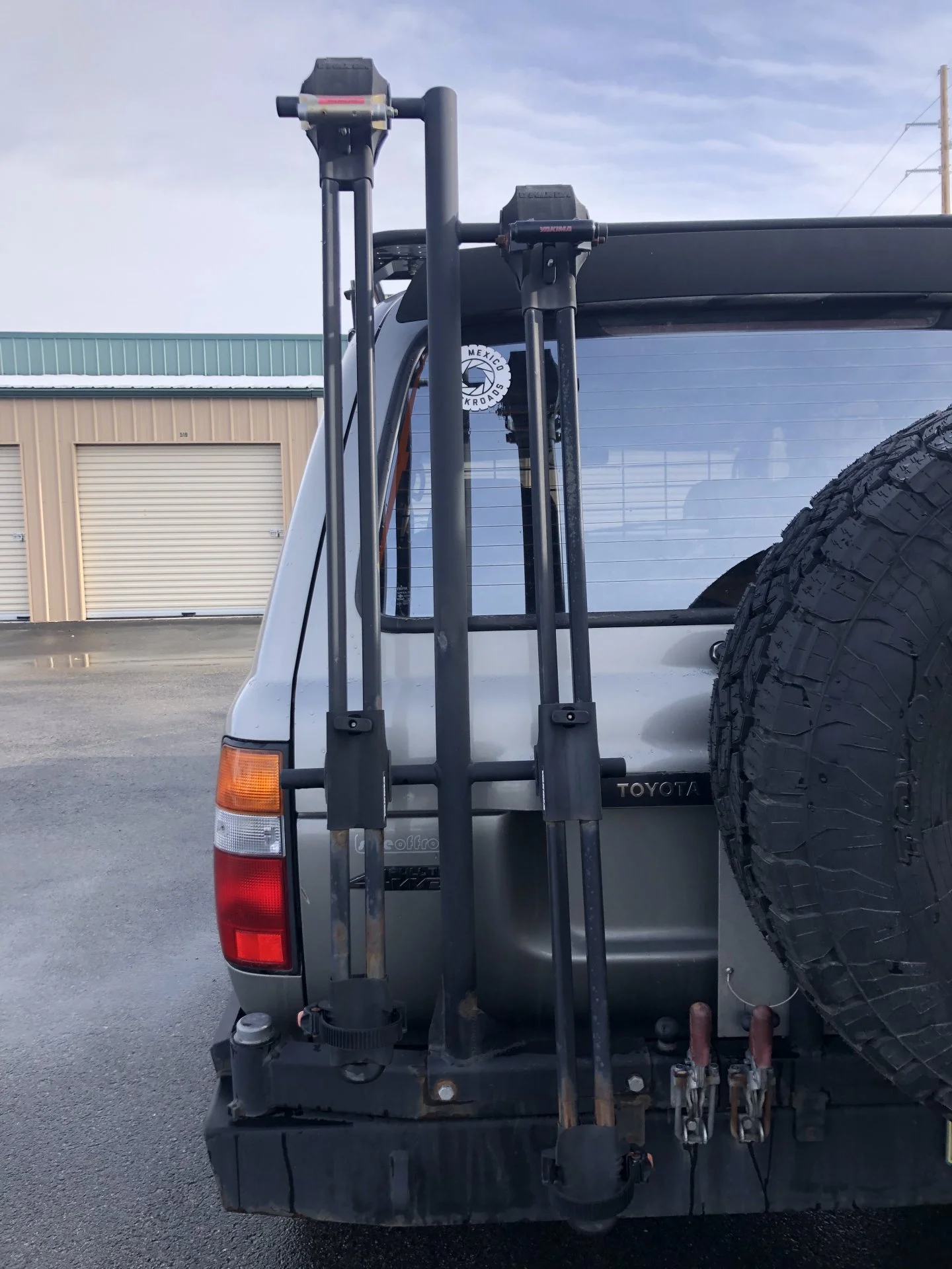

@thegadgetguy , Thanks for the extra pic and info, This is very similar to the idea I have to update mine to some thing that dose not require front wheel removal. So far the hardest part is trying to find the wheel baskets on there own.

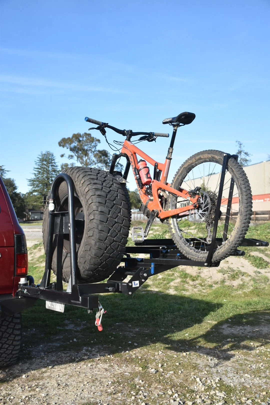

I originally planned to go vertical like that off my 4x4 Labs but just couldn’t deal with the total height with front wheel on. I’m still a believer of horizontal off the swing arm. Post #160. No regrets. And I see a few others have worked out similar solutions since.
@Corbet , You have a very nice setup, I like it. I remember seeing it when you originally posted. I think there are pros and cons to each, depending on what you are looking for. I might end up trying a tray style sometime in the future, but for now this is meeting my needs.

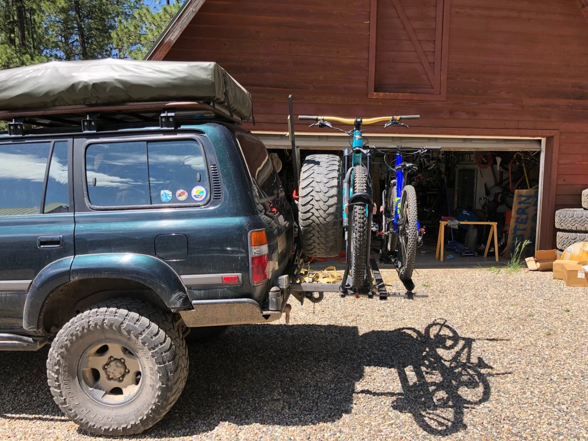

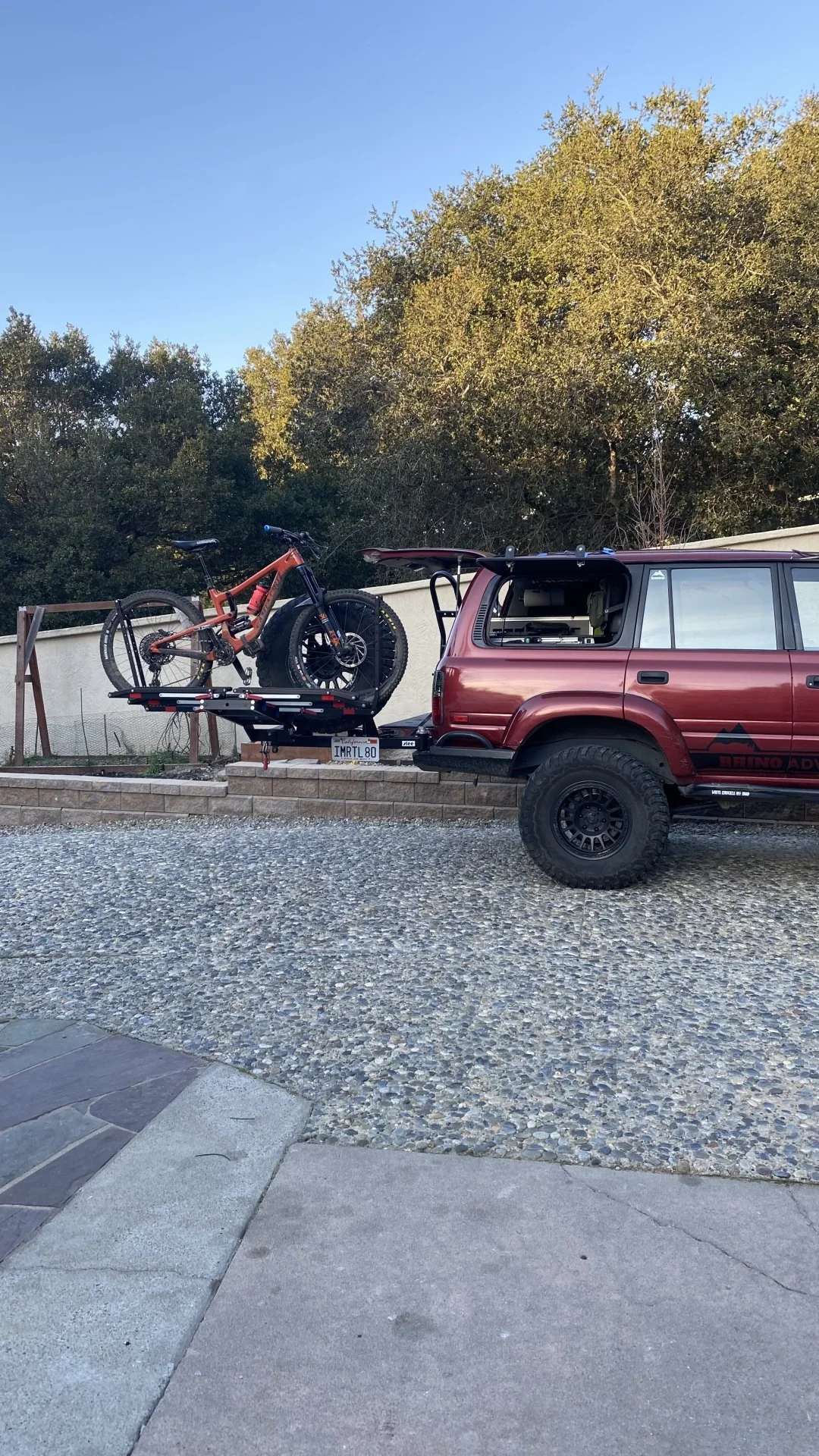

I’ve wanted to do a swingout receiver to mount my bike rack and it finally became a reality thanks to my buddy @Hyup who did the kick ass welding job.
1up to a 12” Curt receiver to the Slee

My rack has been on my mind this last week, as I’m contemplating taking my mountain bike with me to Death Valley. Over a 100 miles of washboard road, the kind that makes driveshaft bolts come loose. I’m uncertain about doing it with ONE bike. Three makes me shudder.

Something I see & esp like is that fishplate on the arm tying to the 12” receiver tube.
Devil in the details & such.
Like you say, washboard roads can really generate some force, and w/o that true ~1/4” plate welded to both I could easily see this type mod cracking welds.
Thought I’d point out that plate seeing as many broken welds in life as I have.
