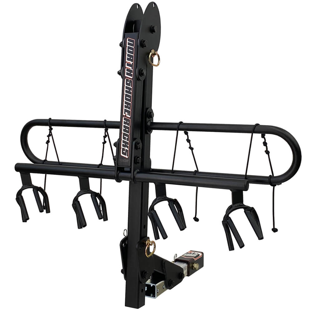

North shore is the lightest 4 bike out there. But looking at it the current version is only ~20 lbs lighter than your current rack. My older one is ~40 lbs lighter than yours. I’ve used mine on the back of our camper for thousands of miles over the last ~10 years. Make sure your camper hitch you will be using has at least a 1k lb weight rating for the hitch receiver bikes create a lot more leverage and rotational forces then you would think.
The advantage of this type of rack is that it keeps them closer to the vehicle so less torque on the hitch.
Even closer if you remove the front wheels. Which I do for long trips or rough roads.
