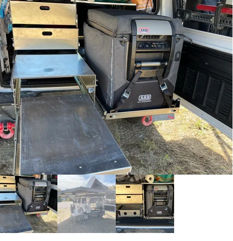

I've got a Overland Kitchen coming the end of this month from Crazy Al up in Victoria, BC. I'm trying to locate an appropriate location for a propane tank to run my two burner stove. If I can't find one, I will probably revert to a dual fuel Coleman. the pictures are from the back of a Jeep Wrangler. The spacing between the wheel wells in our T4Rs is considerably wider. Al is designing a mount to hold two "LifeSaver" Jerry cans between the frig mount and the drawers/slide out stove mount. Everything is modular so I can switch locations between the frig, the jerry cans, and the drawers. It's heavy, all stainless steel and getting very expensive! And should I ever change vehicles, it can be easily removed and installed in something else. Think I should clarify that cost statement. I just looked at Goose Gear equivilents and this is actually cheaper. And much, much more heavy duty.

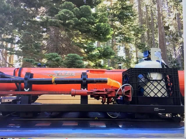

What did you end up doing? Before I got my RTT, I used to carry an 11 gal LPG tank vertically on my Front Runner rack. I mounted a 12" x 12" crate on the rack and then secured the tank with a cam strap. A cable and lock was added for safety redundancy and to prevent theft.

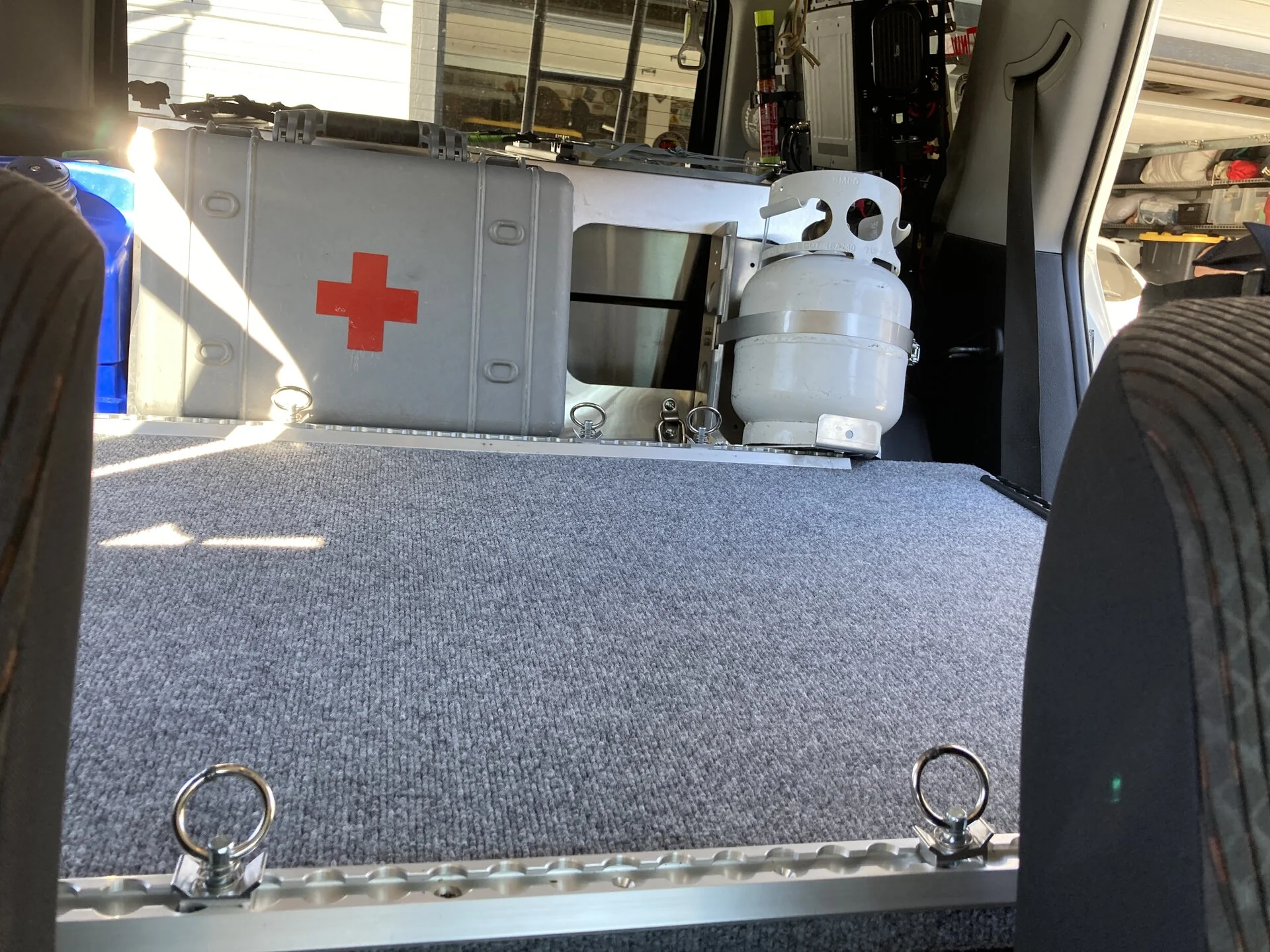

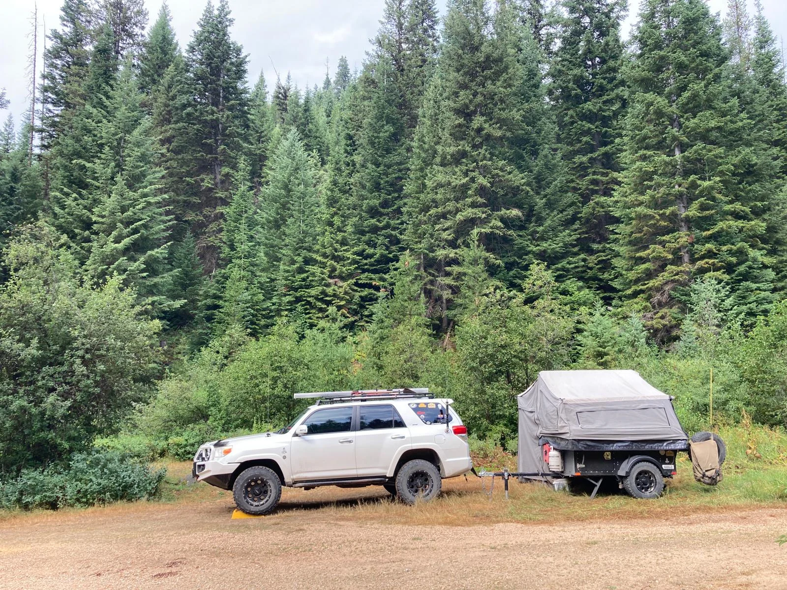

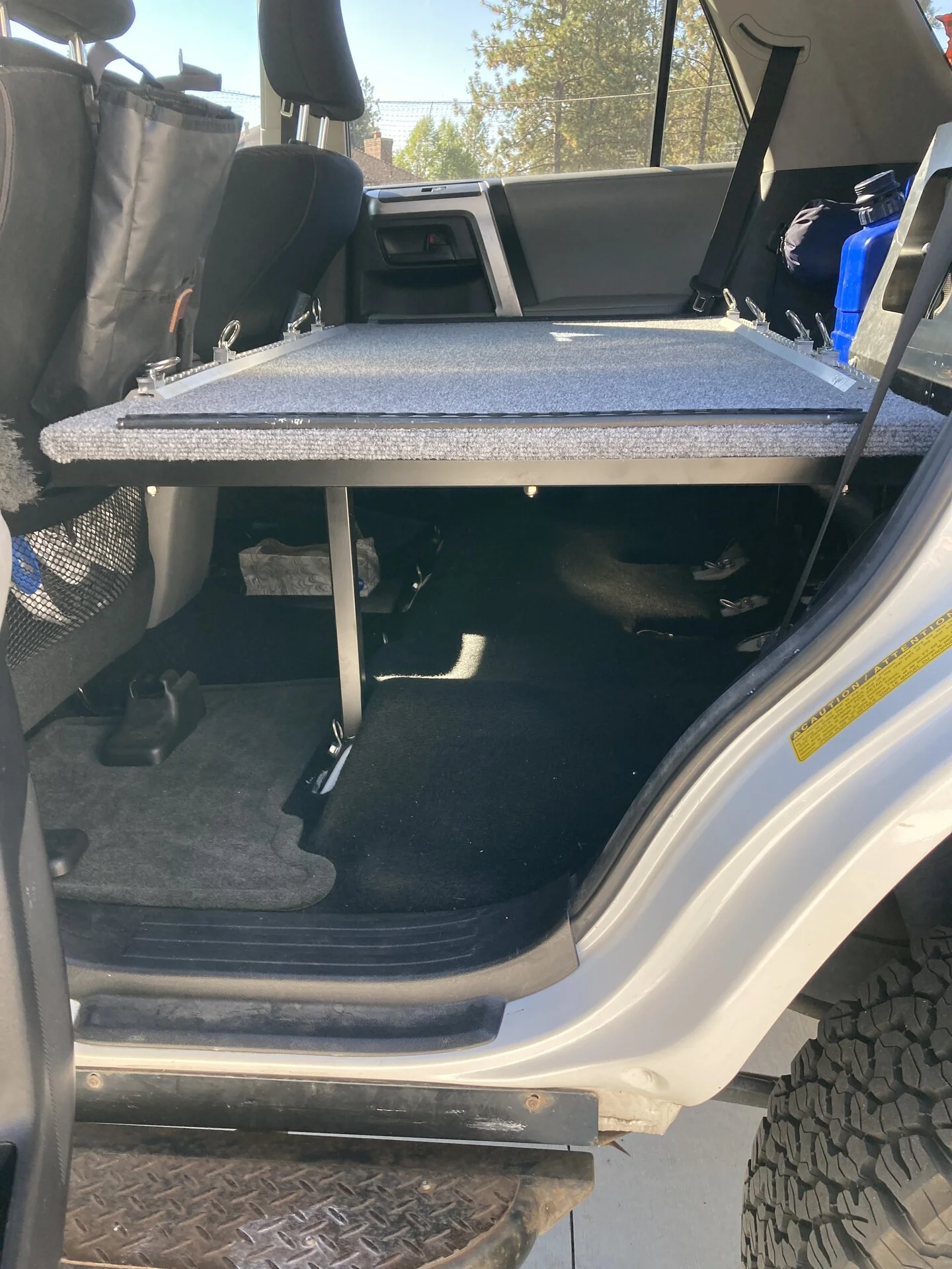

I ended up removing the rear seat and having this shelf built to replace it. The frame is 1" tubular steel with a auto grade carpet covering a 5/8" birch plywood top. The steel frame utilizes the original mounting points for the seats. So no cutting or anything was necessary. The top edges of the shelf are held down with air track. The mounting bolts also go through the 1" tubular steel and are used to firmly mounted the top to the frame. I had already mounted one of Al Smith's Overland Kitchens in the rear. I then bolted a Propane tank support to the rear of the kitchen and have installed a 1 gallon propane tank on it. Next to it is a Pelican case which I carry my first aid supplies in. This tank is basically a backup unit. For the propane stove in the kitchen I have a 11 lb tank mounted to the driver's side of my small trailer. When the stove is deployed, it is just a short distance to the tank on the trailer. I also usually carry a large 20 lb propane tank inside the trailer which can be used to support either a portable fire ring or a Mr Heater unit inside either the trailer tent or the Gazelle T-4 I occasionally use instead. Sounds complicated, but it all works great.
