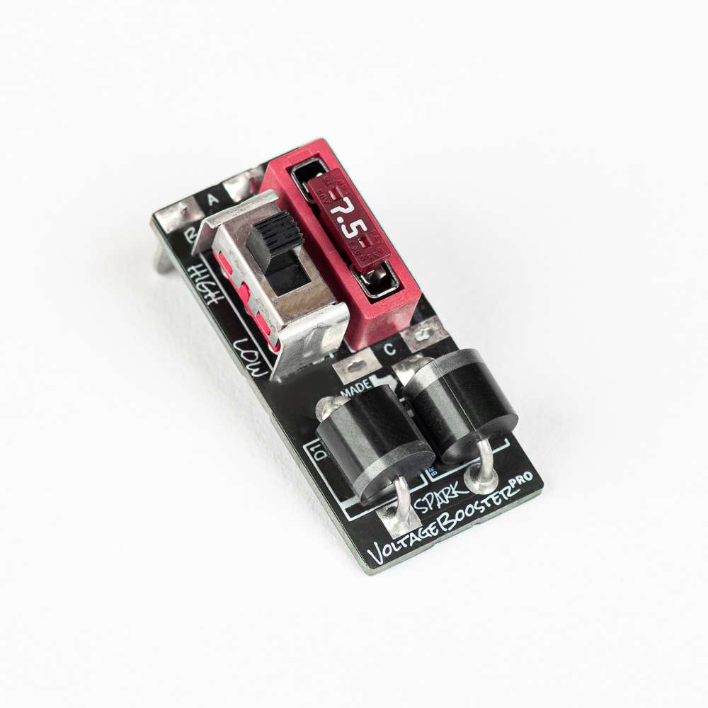

If you want a better charging voltage for your AGM the easy fix is to get one of these or similar.
It even has a high/low switch so you can dial it down a bit during the hot months to protect the battery and bring it back up for the cooler ones.
