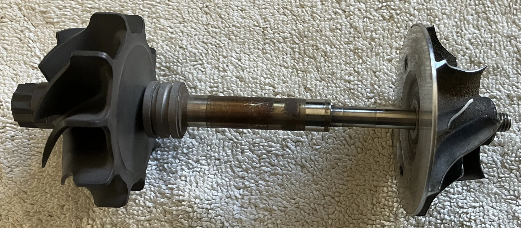

In the 1980's Toyota was involved in the modernization of turbos. Here is an example of Toyota's ceramic turbine technology.

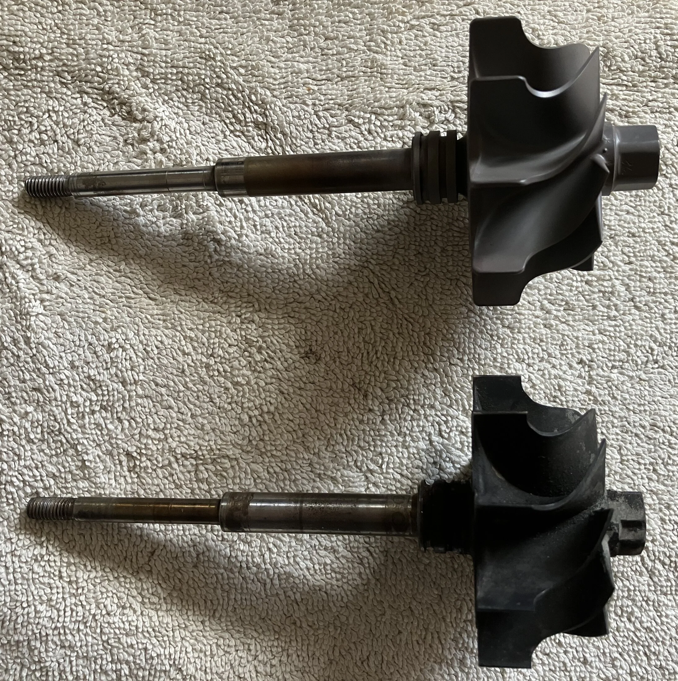

Toyota CT26 turbo turbines.
The top turbine is ceramic and has 1/2 the mass of the metal counterpart below it. Toyota showed in their publications a noticeable improvement in turbo spool time using the ceramic turbines. They reduced turbo spool time 40 years ago. What are they doing with their turbos nowadays?

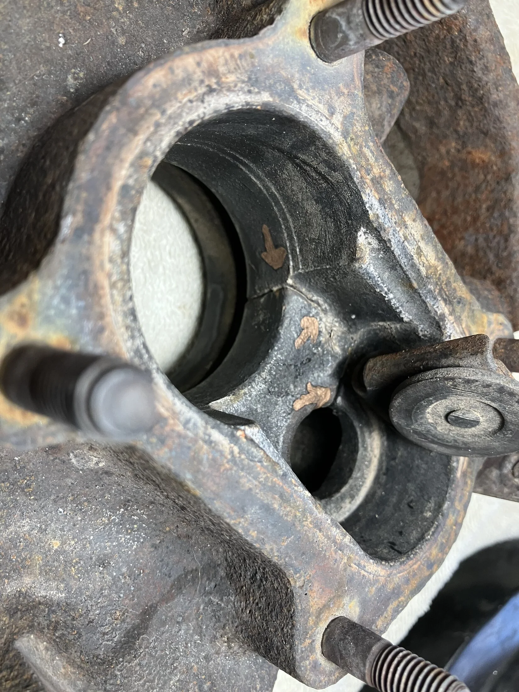

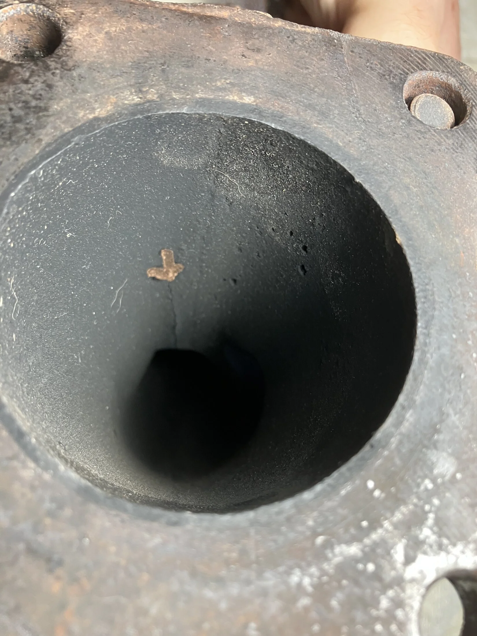

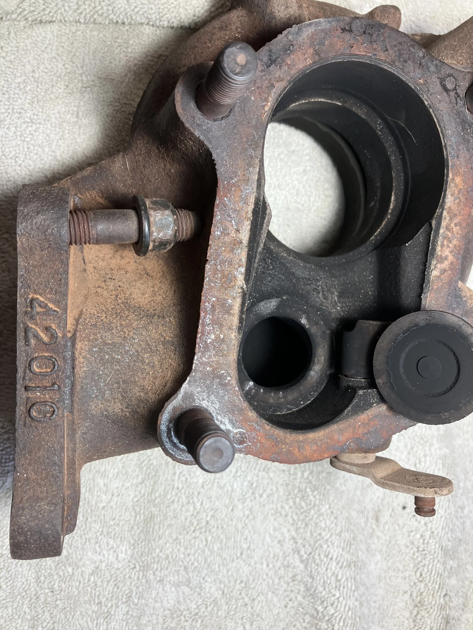

Cracked Toyota turbine housings from the 1980s. I have taken apart 3 CT20s used on the 22RTE engine and 3 CT26s from the 7MGTE. All of these turbos are cracked in the same places: Around the waste gate and down the turbine housing inlet.
Finding replacement housings has been a chore. Is this CT26 housing the same as Toyota used on turbo Land Cruisers?
Found the answer to my own question. The CT26 turbo turbine housing used on the 1HD turbo engine is not the same as the 7MGTE.
