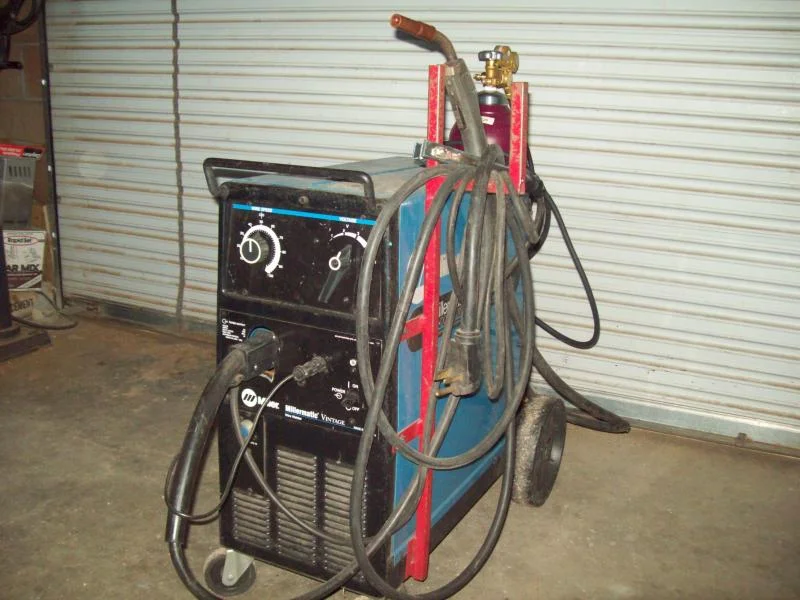

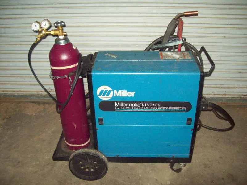

Millermatic Vintage, what's it worth.
Cool, thanks, this thing looks like it has not too many hours on it.
Hauled it home yesterday, the more I look at it, I think it may be a score. Picked up a bottle of 75/25 and regulator on Friday.

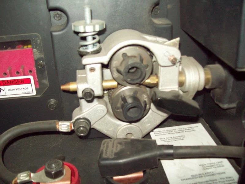

Couple of questions: Drive wheels are stamped .035 on the outside face, but the inside grove is the one that drives the wire...Both groves the same?
Also, looks like it has been set up for a 40~lb spool, I sold all my smaller stuff, will a 12lb spool fit this hub?

Nice score and it looks to be in good condition and not abused.
Outside stamp on the drive roll is for the inner V groove. Good chance your drive roll has .035 on both V grooves.
Yes, it will work with 10-12# spools of wire. Standard 2" hub.
Go here for the manual.
Miller - Service & Support

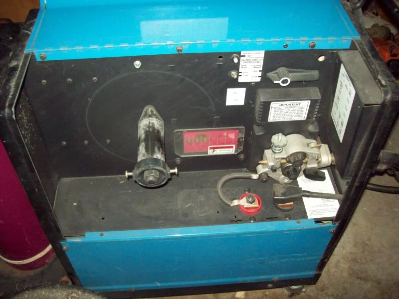

If you get a chance, take the cover off and use air to blow the inside clean. From the looks of it, I don't think it is going to be too dusty in there.
Also, make sure all of the lugs to the big cables are good and tight.
*** Important *** look at the power input settings/jumpers by the drive roll hub. Under the clear plastic cover with pink background.
Make sure this is set for 230V if using at your house. Edit: Looking at the picture, if your machine is a 200/230v model, then it is already set for 230V.
Document page 13 of the manual will have the jumper settings.
You'll love this welder. Most of your welding will be done with the low voltage tap.
The wire inlet guide is in backwards. This is the brass bullet shape thing where the wire feeds into the drive rolls.

Any special distance from the drive rolls when I reverse the inlet guide?

Just make sure the wire inlet guide does not touch the drive rolls when it is feeding. Look inside the wire inlet guide. If there are small grooves from the wire, flip it over so it will feed on the smooth side.
Also, make sure the back end of the mig gun does not touch the drive rolls.

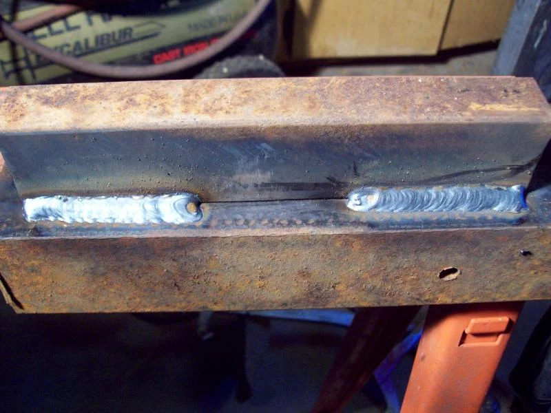

I'm happy. First run on some scrap, need to fine tune my speed along with the settings. Pile on if you have any constructive criticism.
Also, all I get from the manual is to run 25 cfh on the gas, sound right? (seems like I lost a bunch doing this).

Try cleaning the scrap before welding. Grind off the rust and mill scale and you'll get much cleaner welds.
25CFH shielding gas is not needed. More is not better and can cause problems as it creates too much turbulence and starts to suck in air. Try turning down the flow rate until the weld quality suffers. At this point, increase the flow to the point where you have proper shielding. Many people get away with just 15-20 CFH if welding indoors.
The weld looks good, but it is a little high in the middle and the toes needs to filled in. The "toe" of the weld is edge of the weld. In the picture, the toes would be the top and bottom of the weld bead (looking horizontal). Try more voltage and/or move across the center quicker and spend more time on the toes to let it fill in.
What size metal and what welder settings are you using? Are you left handed?
If right handed, try pushing the weld by starting on the right and moving right to left. You moved left to right and were pulling the weld. Pulling will cause a taller bead profile, but result in more penetration.

Yep, I knew they were a little high in the center. This was done on a piece of 1/8 and the other 16 ga. 48 & 3 on the settings, 4 flattened it out a little better, but either I wasn't moving fast enough, or it was a little to hot for the 16.
(Wish I could get more that 15 minutes at a time to mess with this).
Nope, right handed, always have gone left to right, hmmm, another great tip to try out...Keep 'em coming..:)
Ok, spent a little more time today, same settings just dropped the gas down to 15 cfh. Pushed right to left, then pulled left to right (and adjusted my technique). I'm getting into the "I can live with this" zone..

Looking much better.
