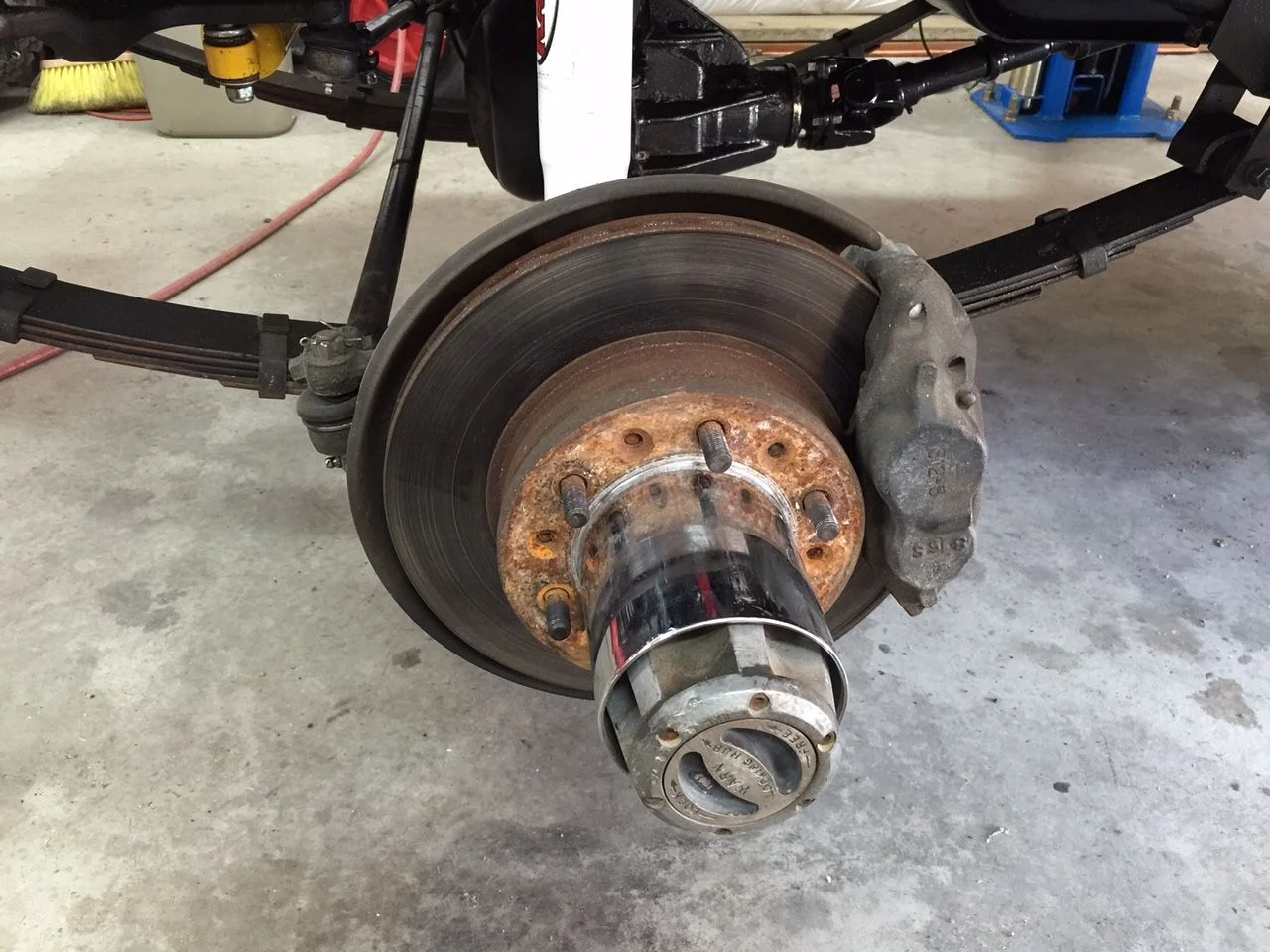

Today I started the knuckle disassembly process and taking lots of pics, I'll upload pics later today. Presently I'm stuck trying to remove the decorative chrome sleeve that's on the driver's side hub it is fighting me all the way, the gentle hand and screw driver method hasn't worked yet so I may have to resort to brute :zilla:force or maybe the rotary cutting action of the Dremel and hacking it right off the hub.

I'm stuck trying to remove the decorative chrome sleeve that's on the hub it is fighting me all the way, the gentle hand and screw driver method hasn't worked yet, tomorrow I will hack it off with the Dremel. There are several nuts that need to be removed that reside under the chrome dark openings I was able to remove all except one.

It was a five minute cut this morning and the sleeve came right off
full
full
removed the retaining 'C' clip and the 4WD hub came right off
