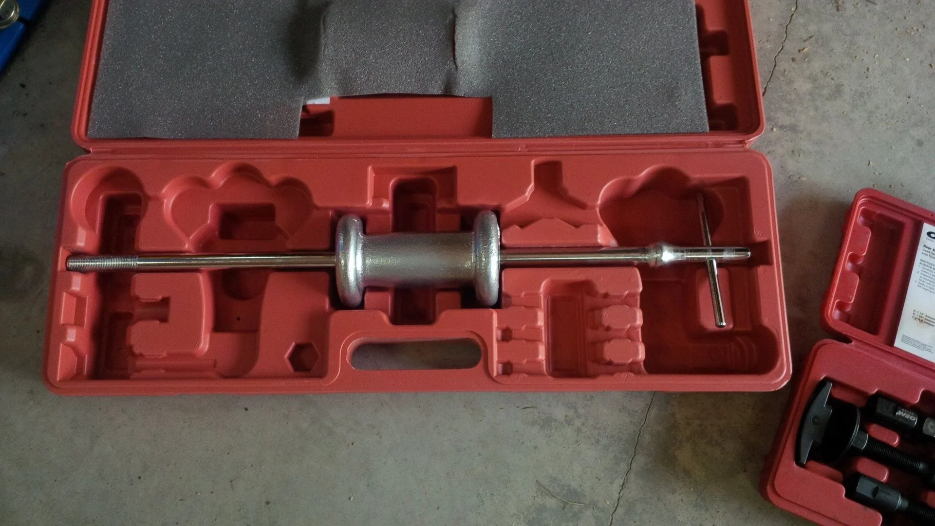

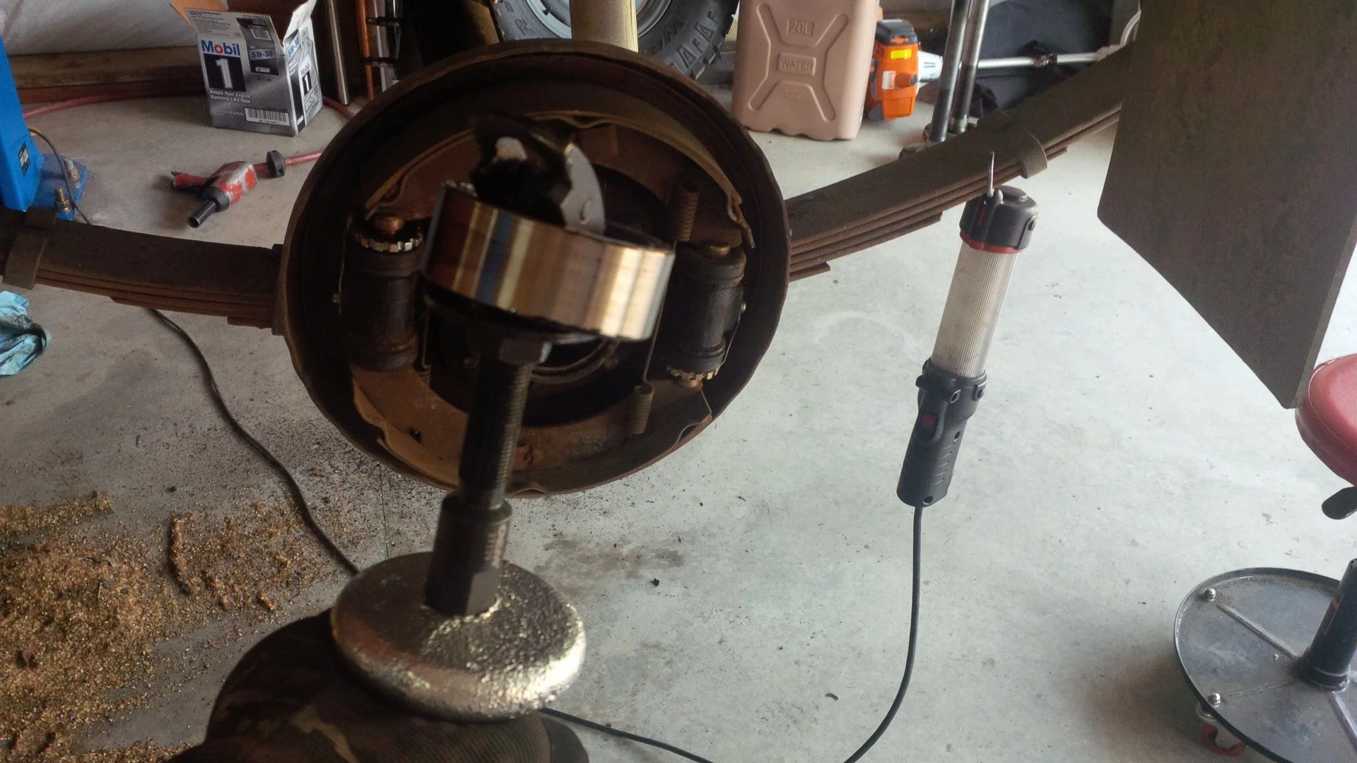

OK while I'm waiting for the 3rd member parts to arrive had to find something else to keep me busy so I pulled the old rear seals and bearings. Went to the local Autozone and rented the bearing puller, they give a 90 day window to return the tools so I'll put these tools to good use for the front axle as well.
full
full
full
The bearing removed within 4 pulls of the slide hammer
