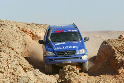

The G series or Galendawagon are very capable in stock form, similar to an 80 series, solid axles, low range, etc, the ML's, even with low range, are really meant more for light duty >>>> snow, gravel, DAKAR:), etc
