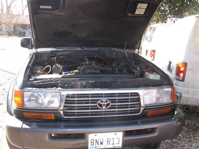

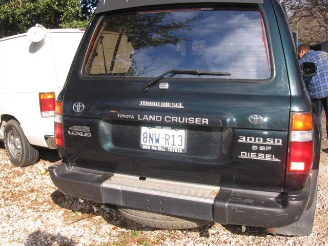

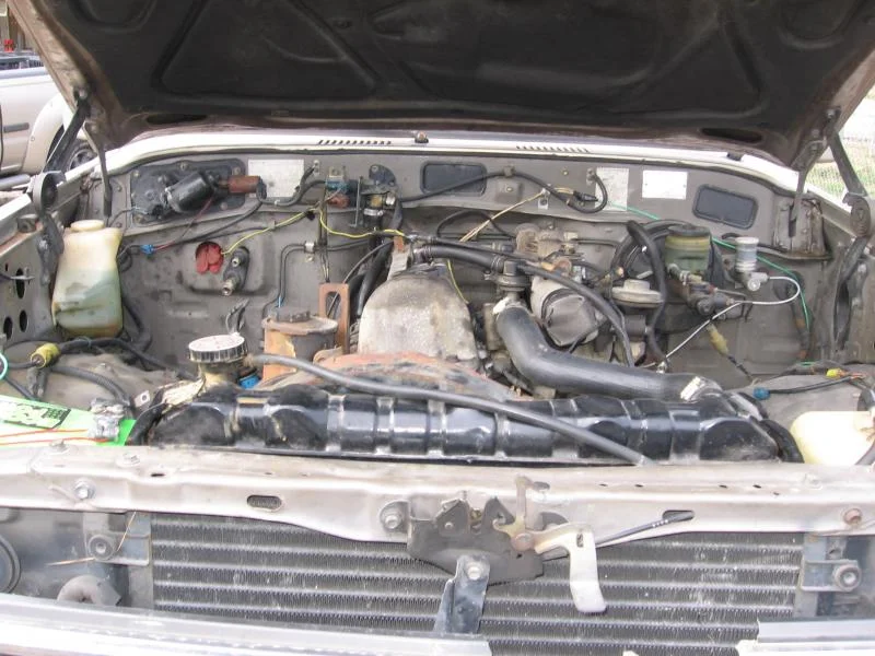

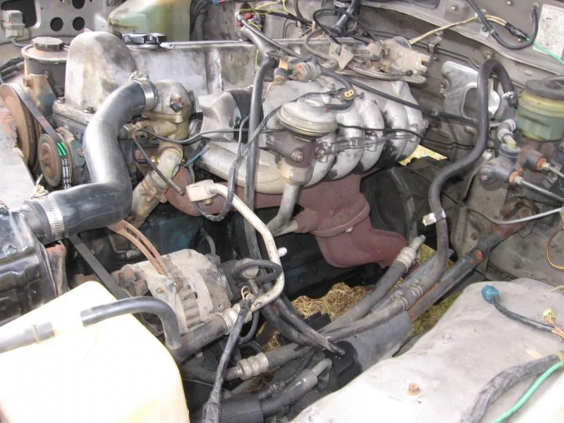

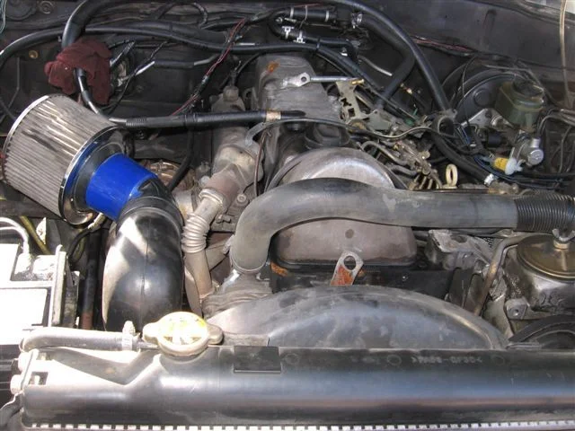

I found a guy in Texas that put one in an 80 series. Before that he put a Nissan diesel engine out of an old Maxima in a 60 series. The way he explained it to me he had to fab flywheels and mounts for both projects. Not sure about the trans issues or what he used. I think I still have some pics he sent me of both, if I find them I will post. But both trucks did run and drive and he sent me tons of photos, so I guess with enough time and fab work anything is possible......
These are all the pics I could find of the Mercedes Diesel in the 80 and Nissan diesel in the 60. Cant tell much about the applications from the pics but if I can dig up his contact info I will drop him a line. Went a little crazy with the emblems on the rear, but man this guy can fab!!!
