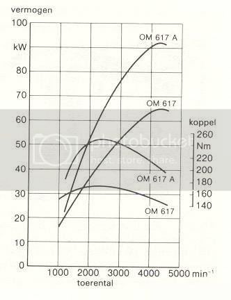

Thought I would post a torque curve for the 3.0L 5-cyclinder engine just so I am not completely annoying. (Or has this been posted too?)
om617 – na
om617a – turbo
KWatts = 1.341 horsepower
N-m = .738 ft-lbs
Peak for turbo is ~120hp and ~185ft-lbs.
:beer: Chad

I've said it before but I'll say it again, we should all rememer that the Merc diesels are freeway cruising engines and you can see it in the pic--they make their peak torque at close to 2500 rpms and peak power over 4000. While these engines are great for their reliability and availability, I still don't think they are the best fit for a truck.
That being said I can't wait for somebody to do this swap and prove me wrong because I do think it's a cool option.

A 2F has a way different torque curve. It makes max torque at 1800 rpm...
I think the OM diesels are a good idea. The key will be in the gearing. Just like the Land Rover guys with the small TDis and the mini truck guys with their small(ish) 22Rs.
I found peak horsepower and torque for the different toyota engines in the SOR catalogue.
2F = 210 ft.lbs. @ 1800 rpm
3B = 166 ft.lbs. @ 2200 rpm
2H = 177 ft.lbs. @ 2000 rpm
1HZ = 206 ft. lbs. @ 2200 rpm
om617a = ~185 lbs. @ ~2300 rpm
I guess what is surprising is that the 2F has more torque at lower rpm than the diesels.
I was going to say that the mercedes has more torque than the toyota diesels but I just realized that I am probably comparing NA diesels to the mercedes turbo. The NA mercedes is ~125 ft. lbs. Which makes sense because the mercedes is only a 3 liter.
Peak numbers are cool to play with but at the end of it, the powerband is what makes the engine "feel" the way it does.
